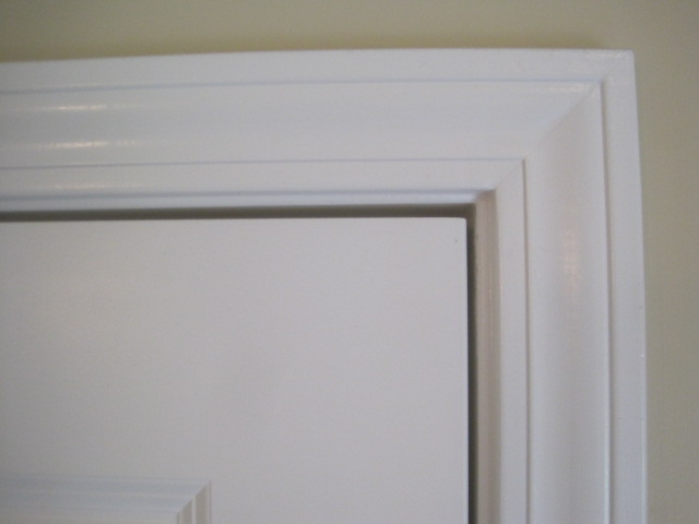

We bought a cordless Milwaukee drill and impact driver. I used the impact driver to fix a door hinge problem.
The door to the master bath is a heavy 32" solid core door. It was installed using tiny screws that only secured the hinges to the soft 3/4" door frame. These short screws could not hold the weight of the door so the door sagged. You had to lift the doorknob in order to close the door.
View attachment 386790 View attachment 386791 View attachment 386792 View attachment 386793
I replaced the 3 short screws in each hinge with 2 1/2" long screws. These screws were long enough to secure the door hinges to the studs in the wall. Using the impact driver to drive the long screws into the studs was wonderful. There was no issue with stripping the phillips screw heads. When the resistance of the screws became great enough as they went deeper, the impact driver automatically switched from screw driver mode to impact driver mode. It makes me never to want to use a drill again for screwing screws.
View attachment 386794 View attachment 386795 View attachment 386796
Here's the door after installing the long screws. You can see it is no longer sagging. The door closes smoothly now.
View attachment 386797 View attachment 386798
