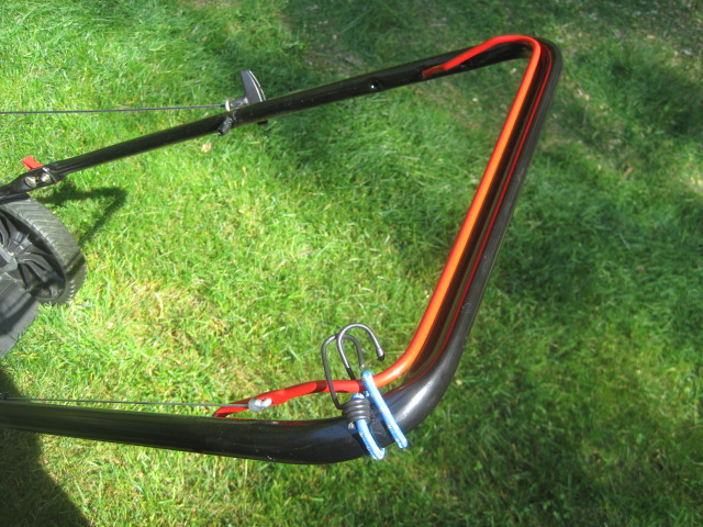

Your now one of us with your bungee cord fix. I've been doing the same since I bought the mower. :thumbsup:

I installed this safety feature on my mower. I was concerned about heat exhaustion caused by having to restart my mower every time I let go of the mower handle to pick up a stick in the yard. My new safety feature did the trick.
Too funny. That was good.

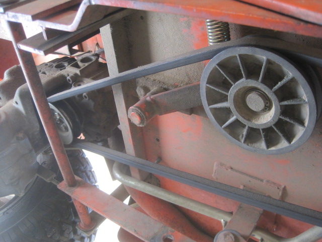

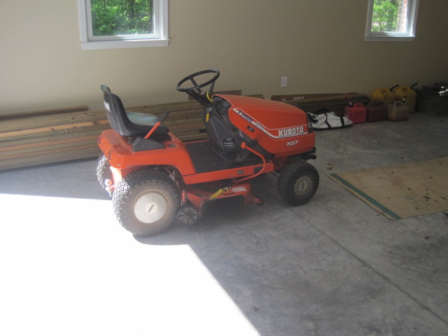

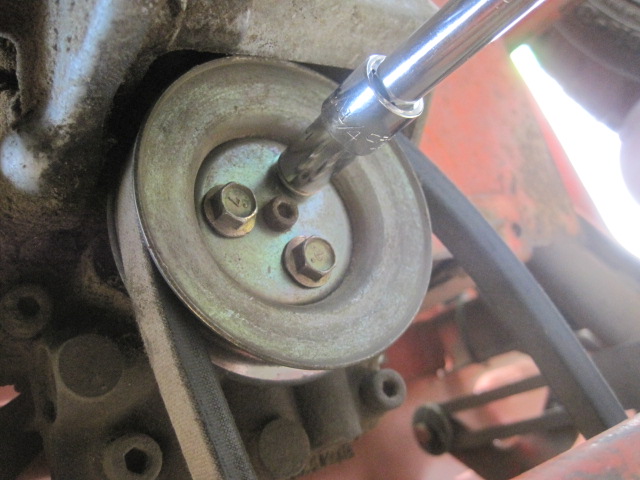

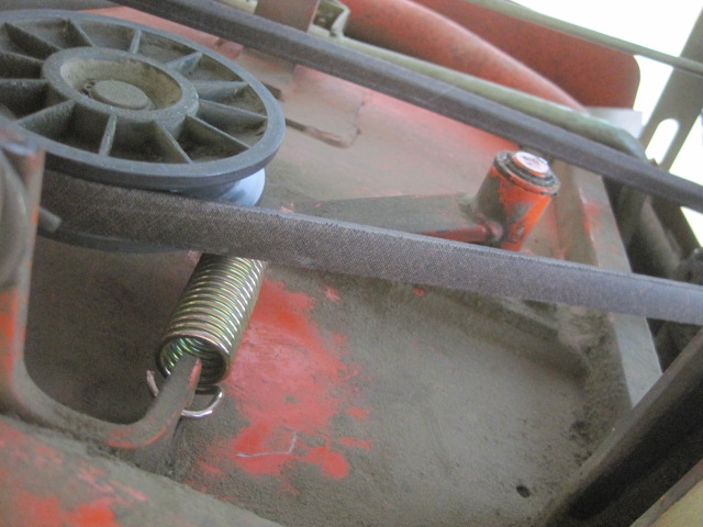

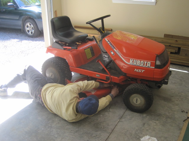

Replacing the Drive Belt on the Kubota Mower
In order to fix the issue I had getting my mower to drive up a hill two years ago, I replaced the drive belt, tension pulley spring, and fixed the tension pulley. Unfortunately, the mower is having trouble moving again. So I decided to try replacing the drive belt again.
View attachment 423375 View attachment 423374

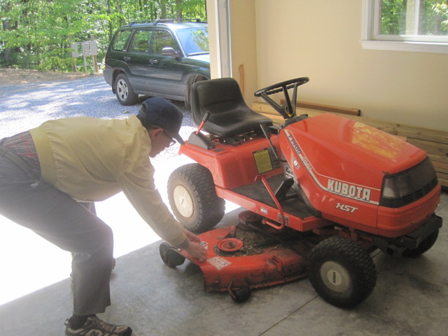

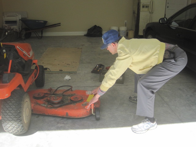

I removed the mower deck.
View attachment 423376 View attachment 423377 View attachment 423378 View attachment 423379
The pulley in the left side of the picture is attached to the gearbox that turns the rear axle. The pulley in the right side of the picture is the tension pulley. You can see the arm to which the pulley is attached that provides tension on the belt using the spring attached to the tension arm.
I removed the rear pulley in order to remove the 2 year old drive belt.
I replaced the 2 year old Kubota belt with a new Kubota belt. After installing the new drive belt, the mower still had problems moving, especially up a slight hill. Upon closer inspection, it appears that the tension spring I replaced 2 years ago didn't appear to be stretching hardly at all. The spring looks to be too long to do its job. The belt feels much too loose.

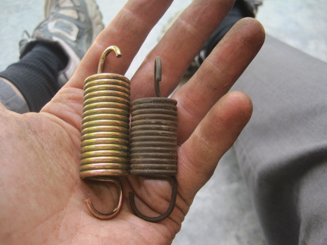

So my wife found the old spring I replaced 2 years ago.
The shiny one on the left is what I put on the mower 2 years ago. The rusty one on the right is the original spring. The replacement spring is definitely longer than the original. It appears that the Kubota dealer sold us a spring that is too long to put proper tension on the drive belt. My wife is going to go back to the dealer to see if we can get a spring that matches the original. Our mower was manufactured in 1989. I wonder if Kubota no longer makes the original spring. Finding a replacement may become a headache.
I knew it sounded like the belt was slipping.
glad you found it and good on her for keeping old but servicable parts. This shows to make sure you check the parts before replacement ...close.
I agree put that one back on, but you will need it for comparisons. You can find a generic spring i am certain if that one is NLA. Check ebay if your store does not have it but i am sure they are still availible even if NOS.
OBED
Confirm that the idler pulley arm swings freely on its pivot post. On the Kubota mowers I have had there is a grease fitting on the side of that post that must be greased regularly. If not greased it can become very stiff and bind up so that it doesn't pivot correctly and thus doesn't allow the spring to properly tension the pulley. Even if the post doesn't have a grease fitting it can still bind due to rust and/or crud accumulation in which case you could remove, clean, grease and reinstall.
HTH
Arkaybee
   / At Home In The Woods #5,919
Arkay has a very good point. Spray something like PB blaster or squirt Transmission fluid up there or better yet pull it down and hand grease it and reassemble
