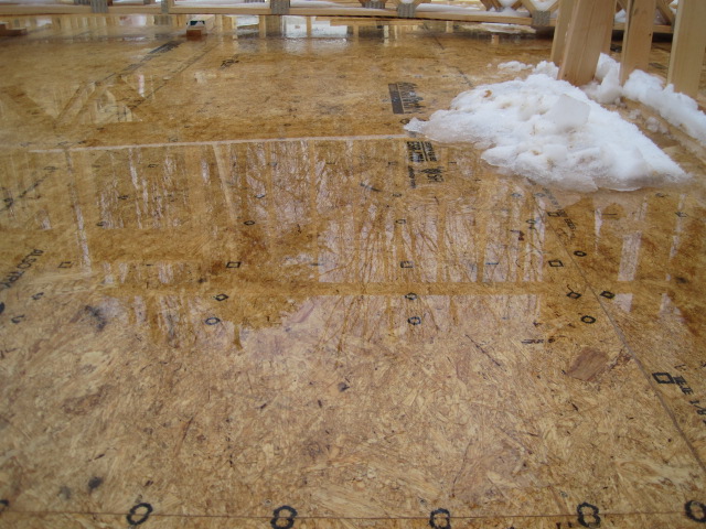

Saturday I only got 2/3 off the snow of the flooring. Sunday I was lazy and took the day off. So we still have snow on the bedrooms and hall bath.

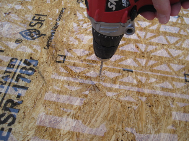

Based on a suggestion someone gave in this thread, I drilled some holes in our subflooring to let the water drain this evening. I wanted to use no larger of a drill bit than absolutely necessary. I started with a 3/16" bit but the holes clogged up quickly. So I ended up drilling 1/4" holes. 1/4" was marginally large enough but seemed to help. I didn't drill holes in the areas still covered by snow. It would be impossible to find the low spots with the snow covering the floor.
The wife is going to make me fill in the holes once the roof is on. I figure that I'll turn on a light in the basement and from the main floor look for the light coming through the holes. Otherwise I'll never find them.
