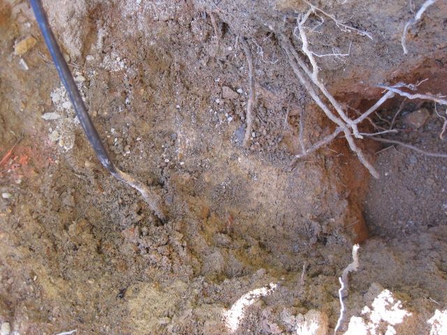

Solving the phone delimna made gave me a little more confidence about digging around this phone cable.
attachment.php
You can see that my electrical trench needed to be dug right beside where the cable exits the ground. I dug a little around the phone cable by hand to get it about 3 inches away from where I would be digging the electrical trench.

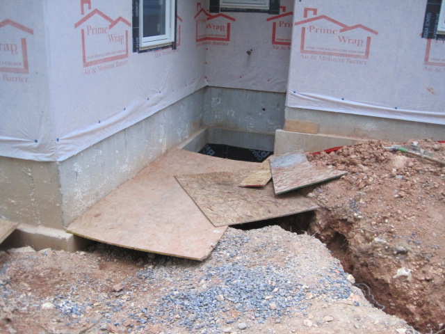

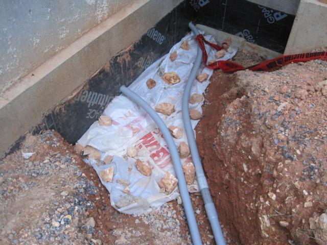

The valley between the garage roof and house roof funnels a lot of rain onto the area where the drain tile sits.
attachment.php
We took some steps to prevent the rain from ruining the drain tile work a second time.

Electrical conduit got run this week between the transformer and the pedestal and between the pedestal and the house. The installers had a device that heated the PVC conduit so they could bend the conduit. The red plastic non-sticky tape will be placed in the trench a foot above the conduit. This tape is designed to warn future diggers that there is electrical wire in the ground below where they are digging.
