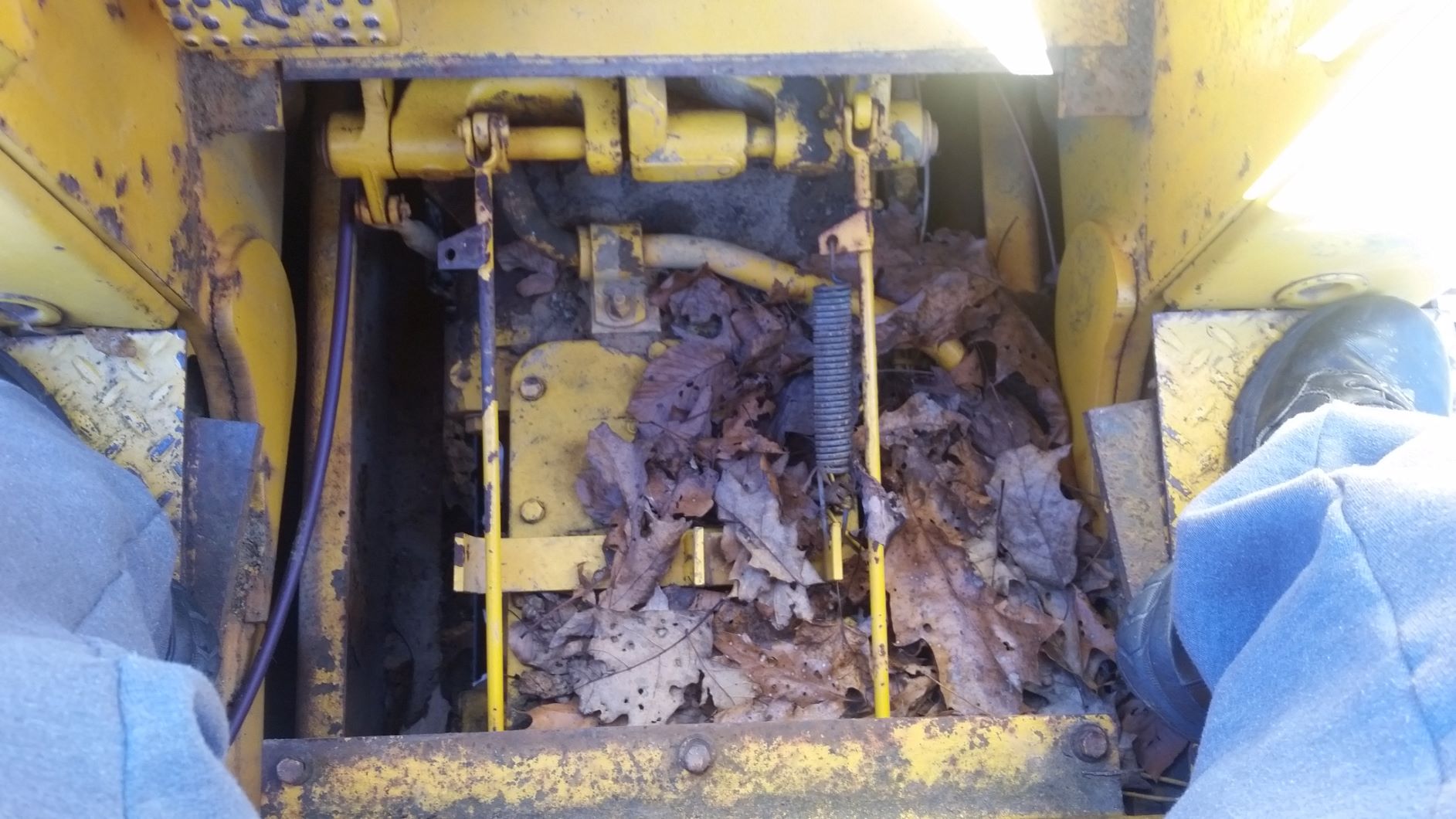

We have a JD455D crawler loader with the foot pedal steering. The left pedal return spring is broken. I ordered one as close as I could tell and model, but it is far to large diameter and isn't right.
I have searched google, ebay, and any tractor part place I could find online, but no luck :confused:
I've been away so long due to illness that I was pleasantly surprised to find my login still worked!
If anyone can help me find this elusive part, I would be very grateful :thumbsup:
Thanks

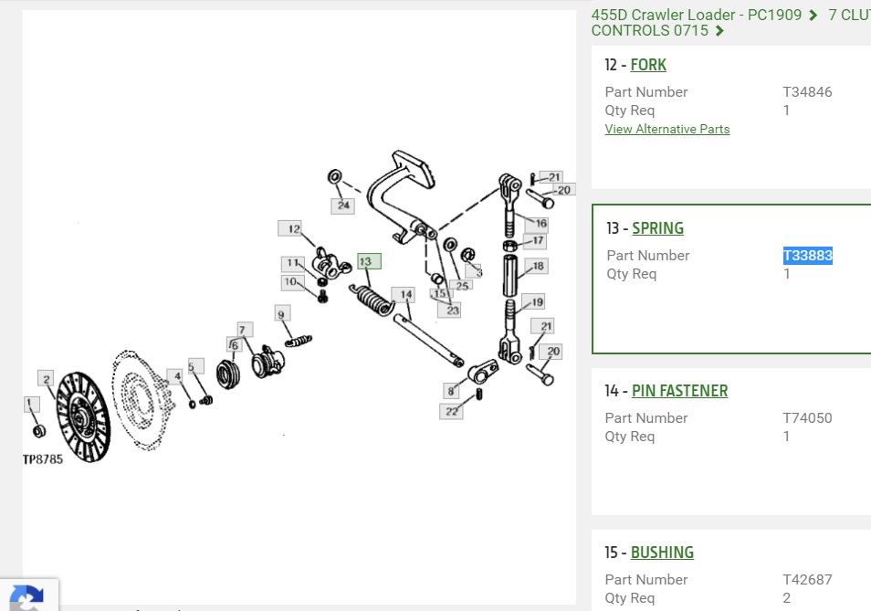

You can go to the parts site, and look at the parts for the 455D
https://partscatalog.deere.com/jdrc/
Pic of the assembly where I pulled the part #
I saw the drawing you posted, but thought that was the traction clutch pedal, not a steering pedal. I hope that's the right spring! All I could find was lever steering and gave up.
I think you're right.
Here's a pic of the missing spring and its mate

Since there is plenty of room for a replacement spring, I would take the one you have to a Hardware store and see what you can find. We have Menards locally and they have plenty of springs in their specialty hardware sections
   / At Wit's end, clutch pedal return spring for 455D ??? #9
If all other sources fail; this spring is easy to make on a lathe.

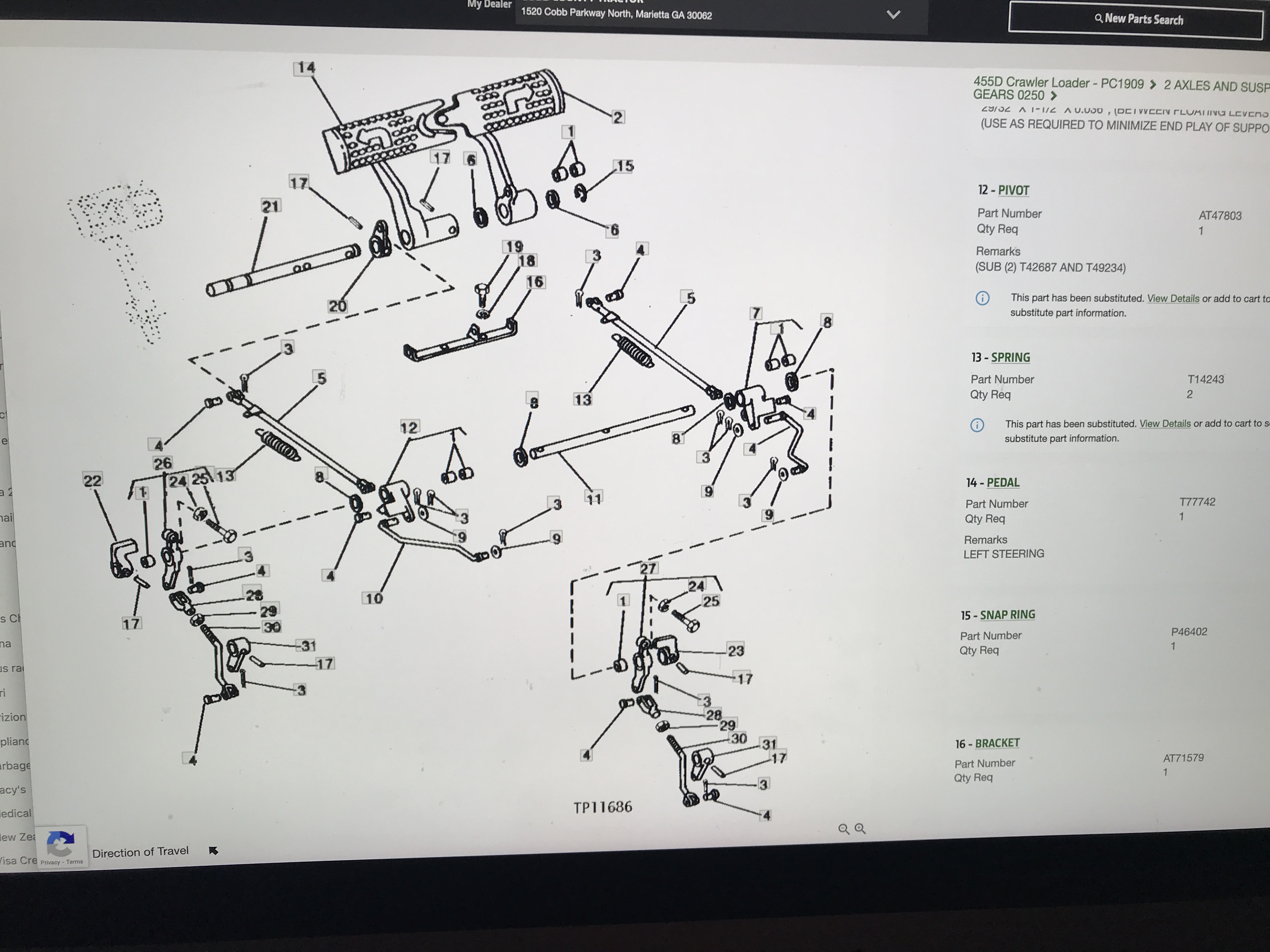

this is what you're after I believe - (item #13). T14243 is the origonal number, but it subs to T143245
