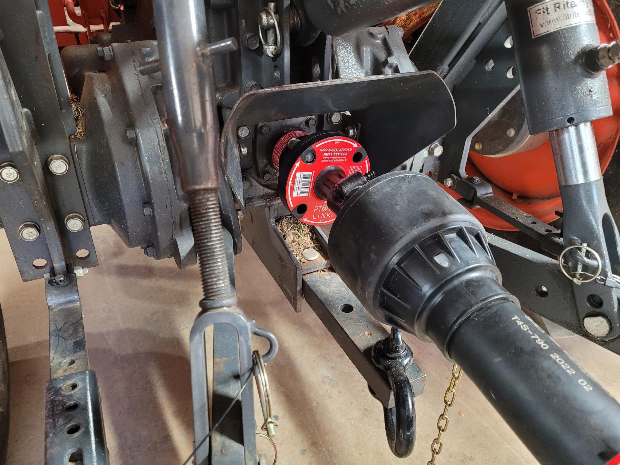

Is there a trick to attaching pto implements to the pto? Sliding the collar onto the shaft?
I always find it a PIA to connect the 2. Various implements. The collar almost never lines up with the shaft. Then I have to play with the switch for several minutes, turn it on and off, until the shift rotates just right to slide the collar on.
I'm can't turn the implement collar generally, or turn the implement gear box.. too heavy/difficult. Then I'm stuck playing with the pto switch.
Is there an easier method I'm not seeing? Would be nice if one could put the pto in "neutral" so I can turn the shaft by hand.
I use the finishing mower, stump grinder, chipper, tiller etc.
kioti tractor.
I've run into tractors that are a pain to get the PTO and implement shafts lined up. I always have the tractor turned off when messing with the PTO.
What I've found is that most implements have a gear reduction making it hard to turn the shaft. Some implements it is easy enough to turn the implement blade. So, with my flail mower, drum mower, and tedder, I just turn the blades or tines until my PTO shaft is aligned. You can probably also do that with your tiller. I don't know what else has easy safe access.
I do that to get the grease zerks in the driveline at the proper angle to get the gun on them.

Once I realized the the PTO shield was hinged and could pivot out of the way, it was way easier to get my hands on and align the shaft with the stub
   / Attaching pto implements #98
Mine was bolted on and I removed it.
   / Attaching pto implements #99
Mine is hinged, but I should also remove it. A previous owner of my prior tractor had removed that one, and it was infinitely easier to connect the PTO.
I'm convinced those shields can only make the whole thing less safe, not more safe.
   / Attaching pto implements #100
I gave up several months ago. Hand issues made it more than a chore. Should have done this years ago.
