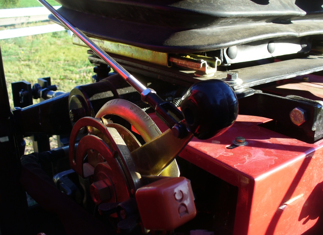

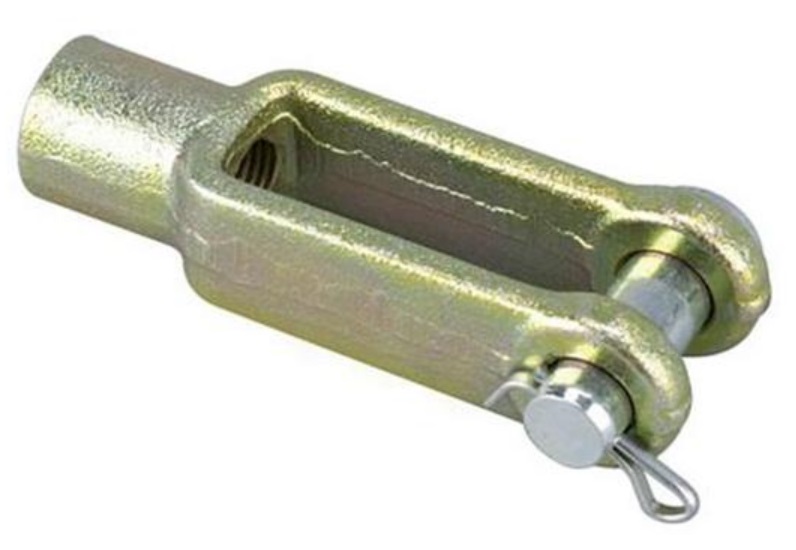

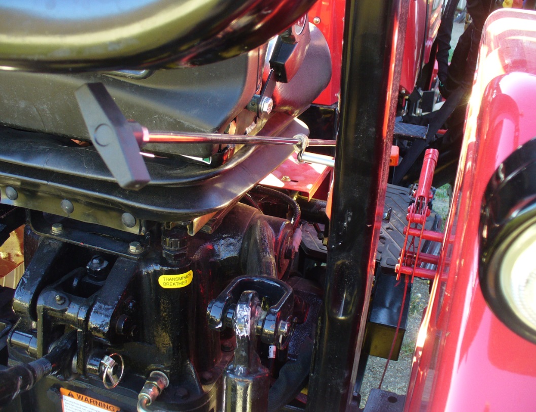

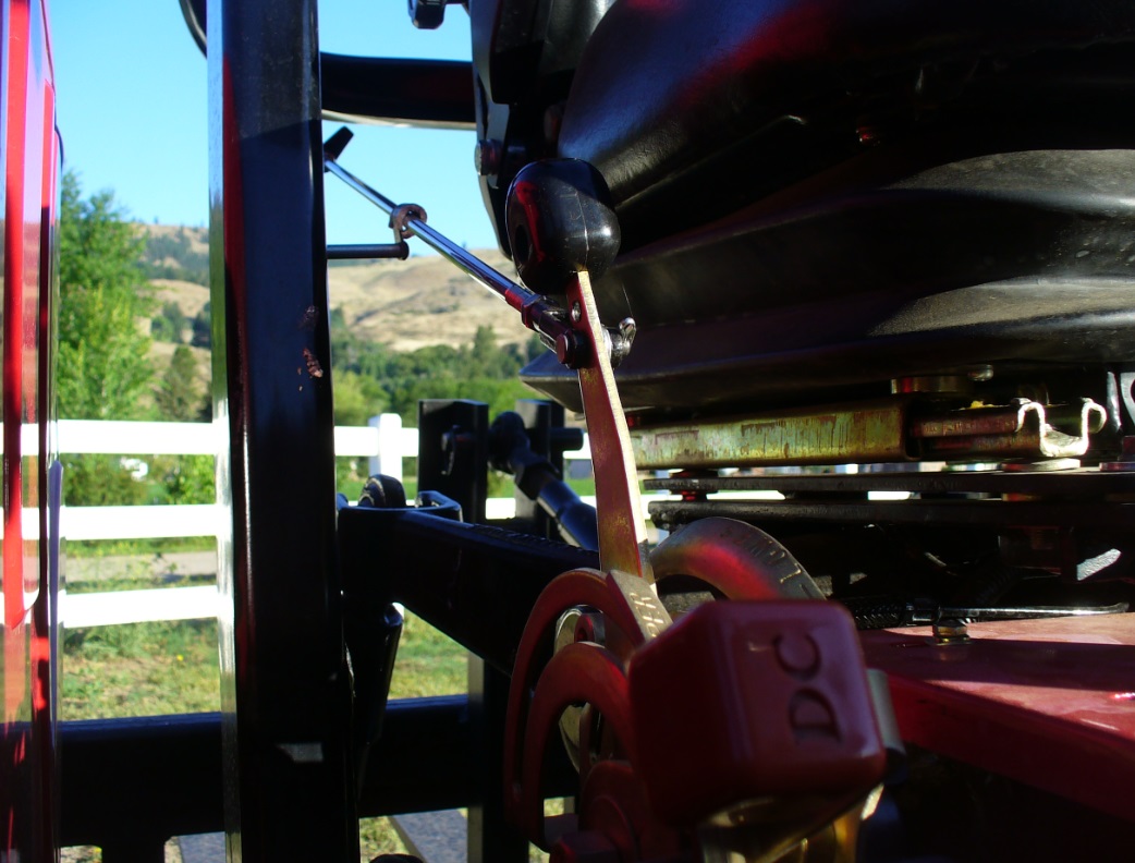

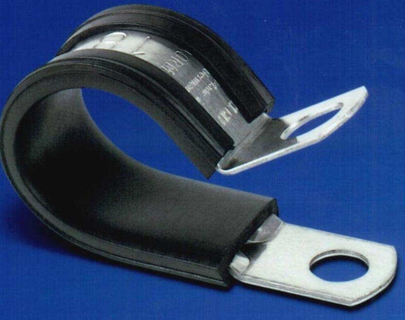

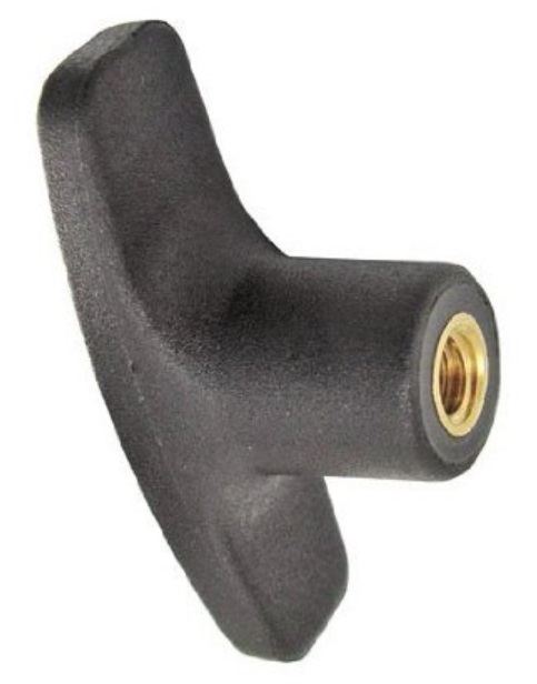

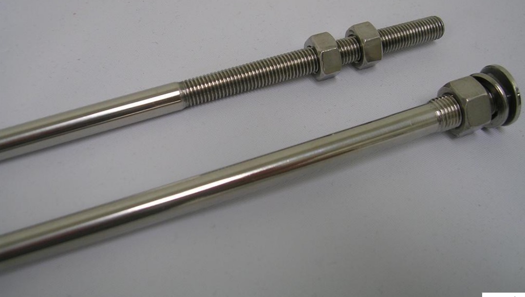

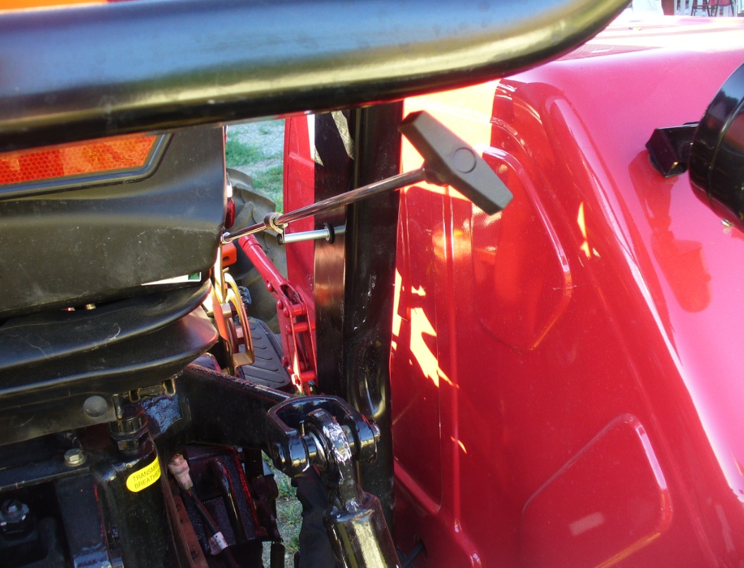

UPDATE:
After installing a prototype control mechanism and using it for awhile, I decided to fabricate a more robust system using a T handle, brake yoke and a chrome plated 32 Ford radiator support rod. I no longer have to struggle to get implements lined up. Obviously one has to be careful when moving/adjusting the 3 point while standing near the equipment while the tractor is running, but this works for me.
Here are a few pics of the final install including closeups of some of the parts used.
3 point rear control final version 2.jpg3 point rear control final version 4.jpg3 point rear control final version 3.jpg3 point rear control final version 1.jpg
3 point rear control part yoke.jpg3 point rear control part T handle.jpg3 point rear control part 32 ford radiator support rod.jpg
Next project: Installing hooks and a receiver on the loader bucket and a hydraulic top link for the 3 point.

Re: Attaching & removing 3 point implements UPDATE
UPDATE:
View attachment 382066View attachment 382068View attachment 382067View attachment 382065
View attachment 382071View attachment 382070View attachment 382069
Next project: Installing hooks and a receiver on the loader bucket.
excellent craftsmanship ya got going through for ya!
my toes, and more so what is between the toes and my ankle *arghs*
   / Attaching & removing 3 point implements
#27
Thanks. Yep, ya gotta watch the toes and fingers. Hydraulics are unforgiving for those whose attention lapses even for a moment.

Nice job,Retired LE! Unfortunately our "working prototypes " on the farm in the old days seldom made it to the refined finished look of yours. Good work.
Terry
#30
Terry
Thanks for the kudos. I know what you mean about putting on the finishing touches. Most times, it was too much of a hassle to go in and redo everything. I think the reason I did it this time around was because I already had the parts laying around and they were calling to me to install them... or something...
