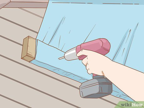

Just a question. I have two spots on my roof with shingles blown off by last weeks windstorm (65-mph gusts). How to I attach the tarps over the bare spots? Unless told of a better way I intend to nail them to the roof. There are so many people with damage that I don't know when the roofers will get here to fix the problem. I really don't want to nail them as I will then have more to repair. But............
Any Ideas?

Nail a few wood perlins on top of the tarp (1x4's).
/ Attaching tarp after blown off shingles. #6
In addition to using the wood either 1x4, 1x3 or 2x4's if you wrap the edges of the tarp around the wood then nail it down it will withstand the wind better.

1x4 wood planks is a good idea just need to nails them on a angle (like this ^) so water flow off the planks and don't accumulate and sip under and don't put any at the bottom, top and maybe side... just use staple for the bottom...
/ Attaching tarp after blown off shingles. #8
Or you could fold the tarp over, then under the bottom one. It would still shed most water over the board, and wind won't be able to pick it up.
You could even bevel the upward edge if you were concerned about any water buildup.

Oh most diffidently, I was only showing the picture on how to wrap the trap around the board to help minimize the wind damage from tearing the tarp.

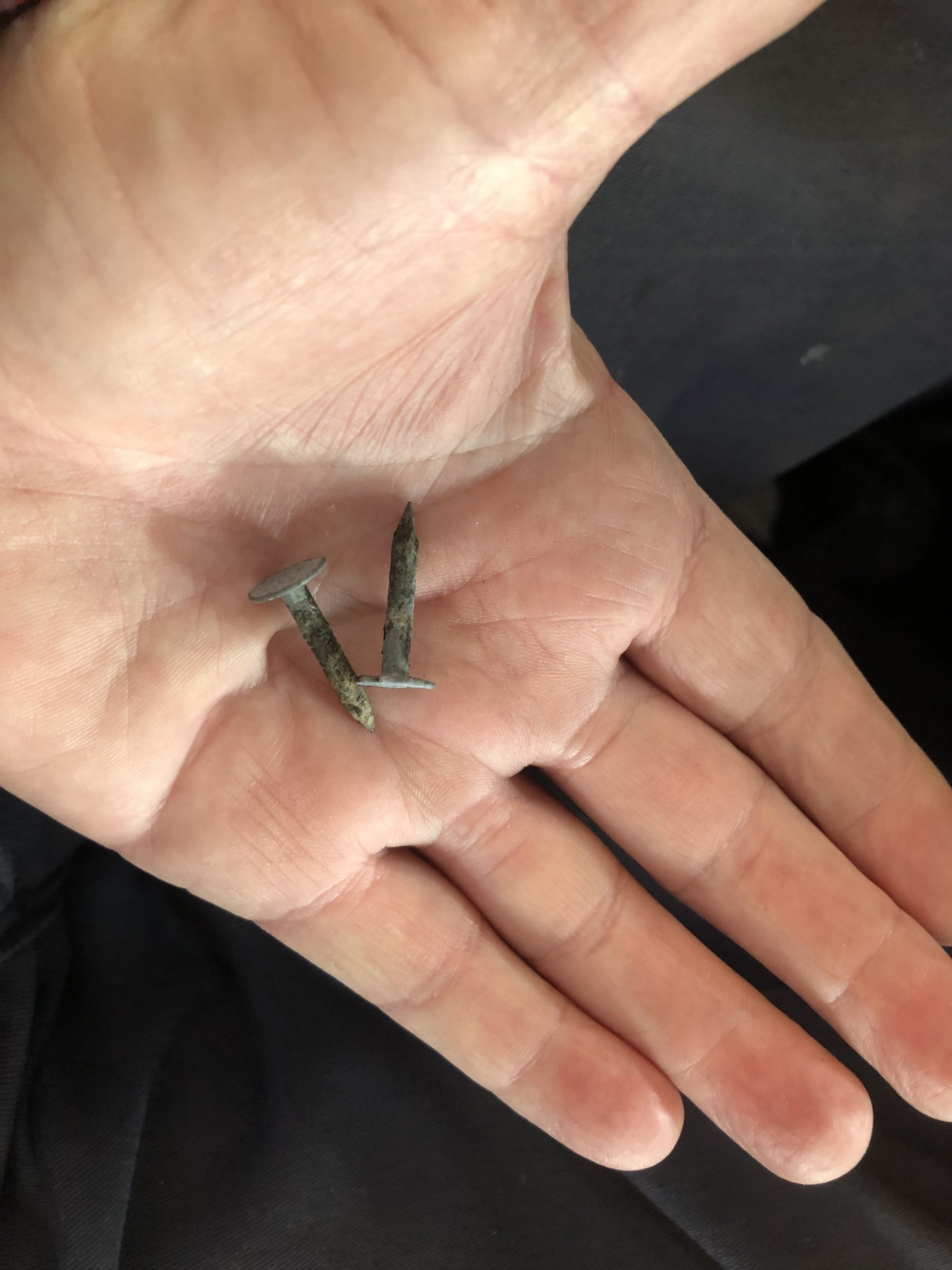

My grandkids house after CA storms. This was second layer so no interior damage. Adjustor is coming today.
/ Attaching tarp after blown off shingles. #12
Second layer ?? so shingles on top of shingles ... when new shingles are installed on top of existing shingles the nails need to be longer at least 2 inch if not that what happen... the good news is they did their time, they started to curls on the one side.

If the damage is near the peak, you can roll some of the tarp around a 1x4 or 2x4, screw or nail it down on the opposite side, and then fold the tarp back on the damaged side which means the tarp will cover the screws. Then secure the bottom either with screws/nails as others have suggested. Or tie off with rope if you have something to secure a rope.
Yeah, the failure was probably due to installation. The roofer probably saved $20 on nails. I know that the roof was put on at least 20 years ago, so they did the job.
