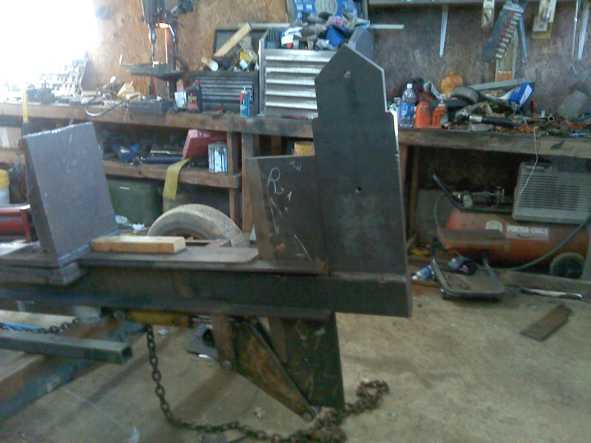

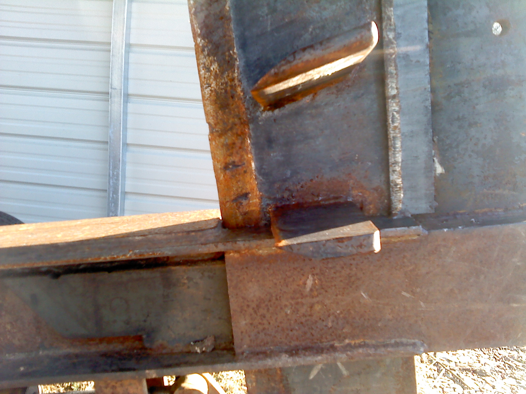

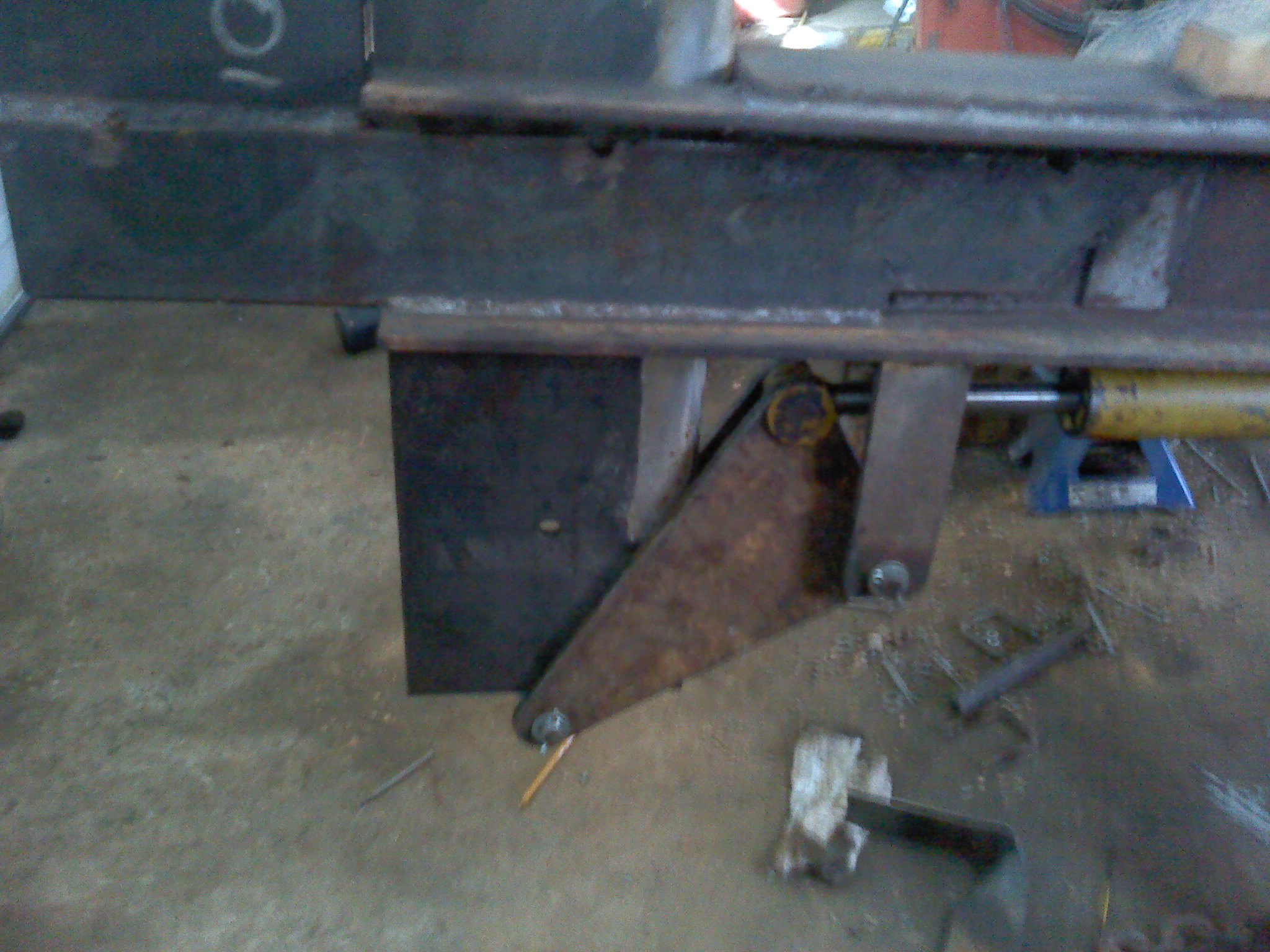

these are all the pics I have uploaded of the wedge. You asked what I would do different, well I did make one change. If you look at the wedge support, I welded a guide to the support for the wedge to slide up and down in. I figured this would help keep the blade lined up with its backbone. What it did was become a catch for every little splinter that slid by it. Slivers of wood would get wedged between the blade and the guides and keep it stuck all the time. I removed those guides and welded them to the blade, Now the splinters cant get wedged and no more stuck blade. As for the 2-4-6 way split. The blade will raise 12inces. The bottom wings sits at the top of the hbeam so that the top wing acts as a 4way. I can raise the wedge up 6 inches and now have a 6 way, or I can raise it 12 inches and slide a 12 log under the wings for a 2way split. The bottom wing in fully raised postion will be in the center of a 24in dia round and require resplitting the bottom two halves, but most wood I just center the blade for 6 even splits and dont have to any resplits. My processor will have a 12way blade and function pretty much the same as my current 6way. With wedge at bottom lift, 12in and under round will pass thru the center circle for a 4way split. Depending on the size of the round I should be able to center up on up to a 27in dia round and have 12 even size splits. Anything over 27in wont pass thru the saw frame so it wont make it to the wedge.

Thanks mud, very helpful. Especially that first pic. I had noticed that about the side guides being on the back and you confirmed what I thought. With it a truly floating wedge, it would be easy enough to swap it out for an 8 or 12 way if the logs were big enough to need it and avoid the resplits.
