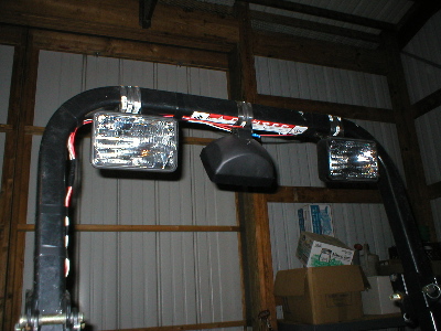

I used good old hose clamps, as mentioned by Soundguy, to mount my lights.
   / Attaching Work Lights?
#24
Easy - functional - can't complain with that. Where did you place switches and make connection?

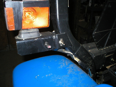

I used the two prong accessory plug back by rops for power. Mounted switches on the bracket that supports the amber flashing light (tape on light is a result of tangling with a grape vine).
