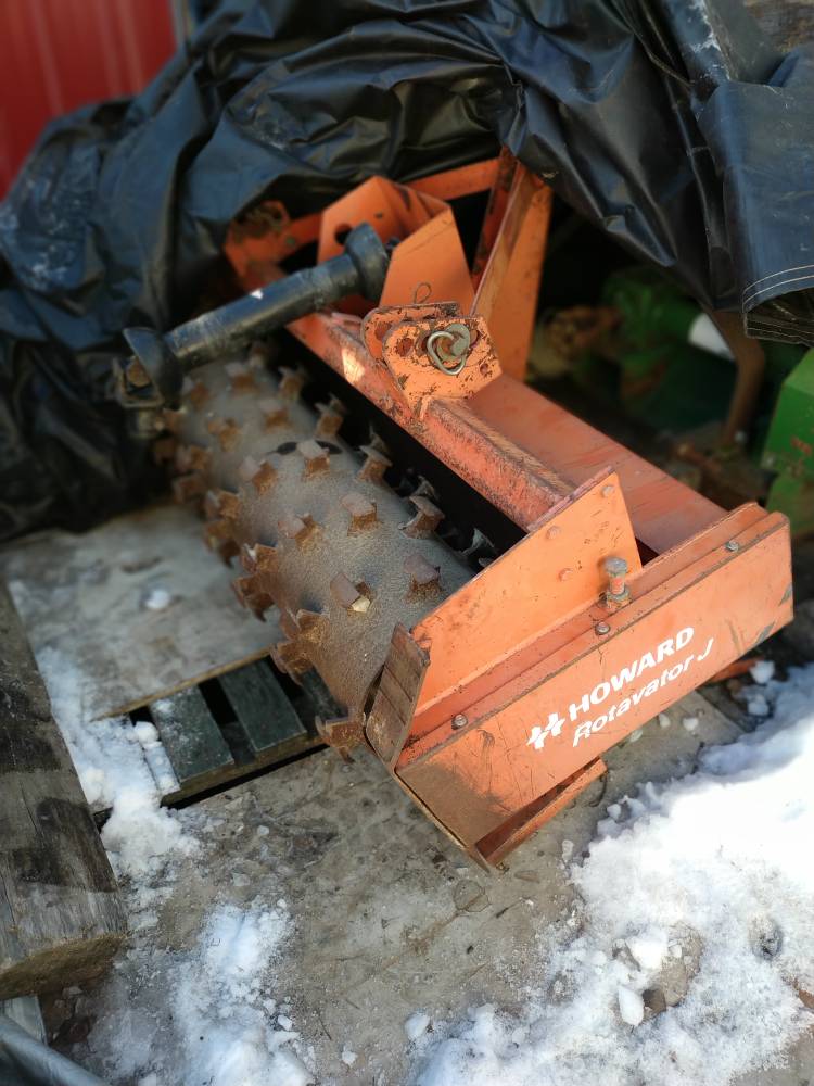

I was going to say a tiller converted to a sheepsfoot roller (used to compress road sub-base) except - that drive shaft would spin it too fast so that's not the answer.
   / Attachment puzzle to me
#14

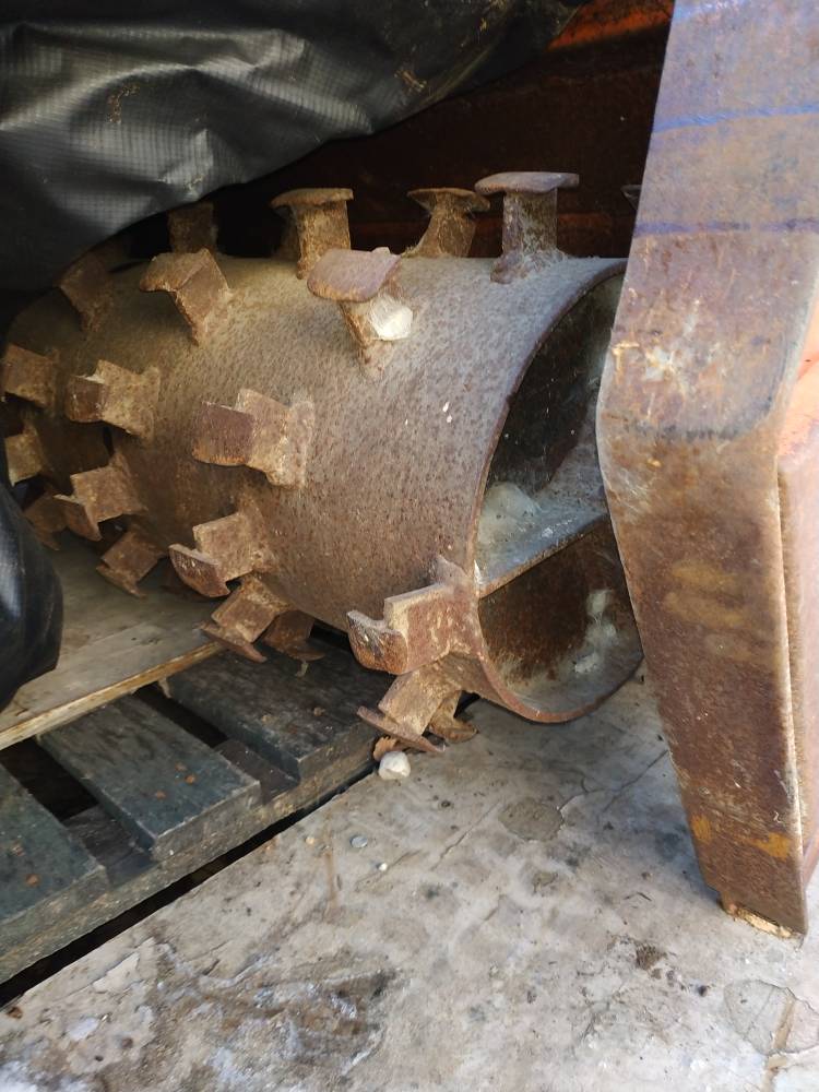

Top welded pieces had at some point sharp edge. So this was definitely made to break/cut something. The 2nd owner never used it but it was definitely used long time ago as they are dull and worn out.
Since nobody has another pic like this I am definitely interested in trying this thing out in the spring - lol.
   / Attachment puzzle to me #15
Your 3 picture would indicate that originally it was a tiller. However that is no longer the case. It looks as those someone has modified it at some point. Depending on its rotation direction, the ‘hammers’ on it will either do a rough rip of sod/grass/weeds or hard soil, or more of a compaction of loose soil.
Check the gear oil levels in the gear box and chain drive or gear drive on the side and see what results you get running it. Preferably in an area that does not matter to you.

I agree with you. It used to be tiller.
Yeah, now it's just too cold here to do the needed check on fluids etc but spring comes I have lots of bush/ swampy area to try it on
