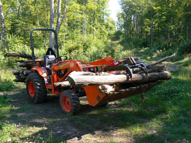

I have TSC carry-all that I never use anymore as I find I like having the box blade on the back as a counter-weight and for trail maintenance.
My $1000 Tatro bucket grapple/WR Long electric valve kit has worked out to be the perfect front end tool along with my tooth bar. I thought about getting the Payne forks with logging attachments but the grapple is better for my applications-logs and rocks
