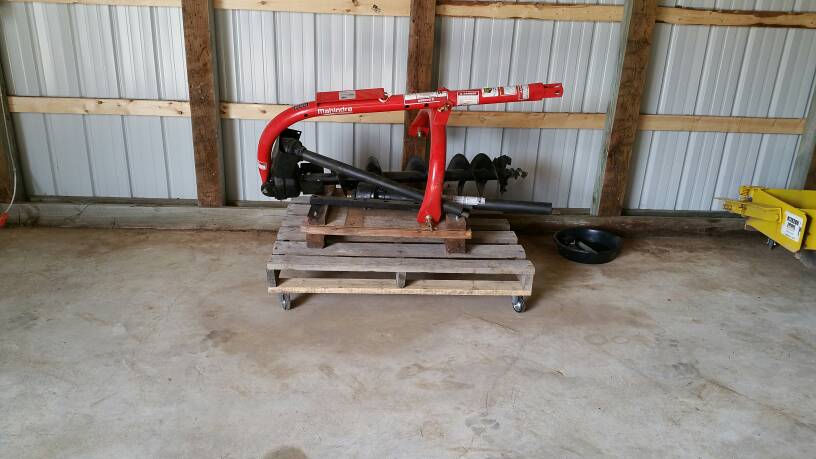

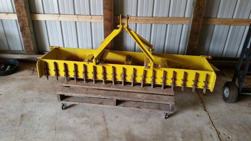

We are building a house and the concrete blocks came on some very HD pallets. I decided to add some casters and test out some 3 point storage options. It actually worked our very well. Attachments are anywhere from 400 - 800 pounds and they move pretty easily. I got the casters for around 30 bucks on ebay (pack of 12 casters). How do you store your attachments???

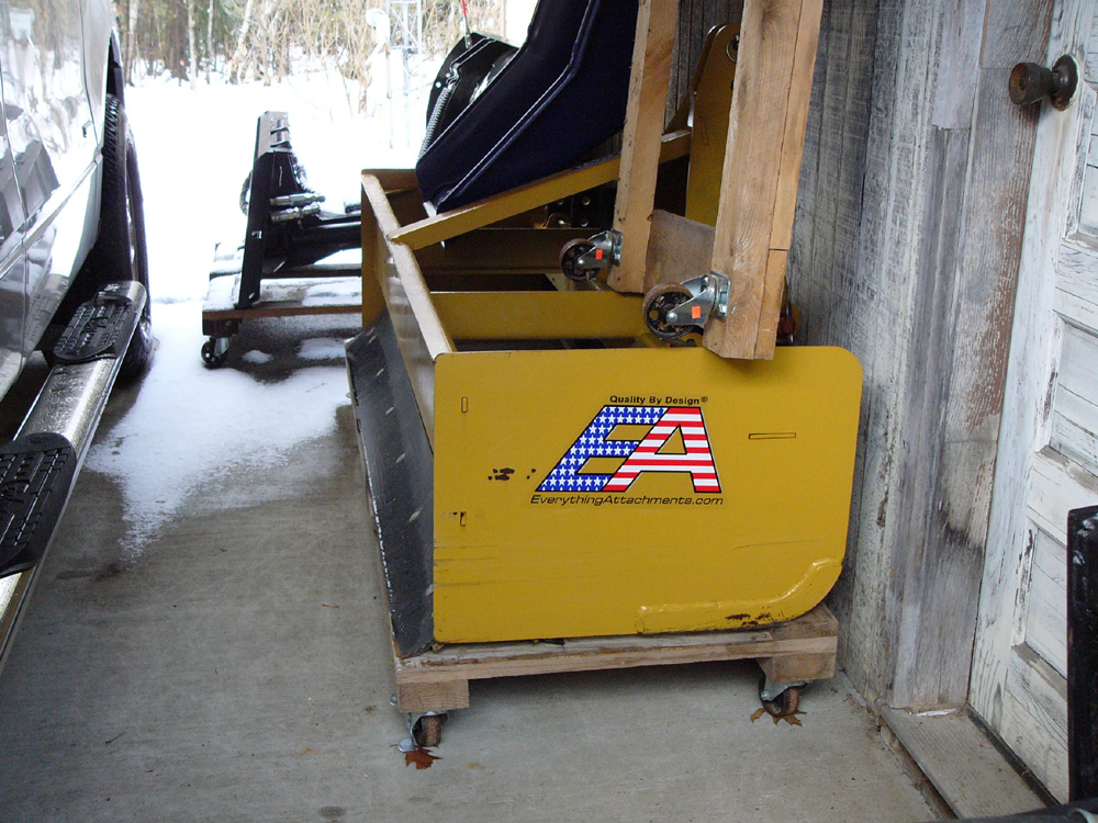

I store my attachments on dollies made from 1" rough cut hemlock and casters
purchased at a local wholesaler. 3" casters are $4.50 each, very reasonable and
they have stood up well so far with three years of use.
There are other types of casters available also, but I chose the cast iron ones
to eliminate flat spots from prolonged storage in one place. If my memory serves
me correctly, each caster is rated for 250 lbs. so each dolly will hold up to
1000 lbs.
The dolly on top of the box blade is for my Pronovost Puma 74" snowblower
which weighs 640 lbs.

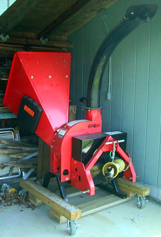

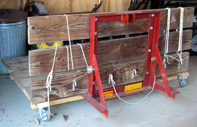

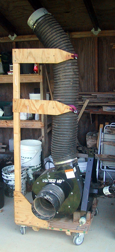

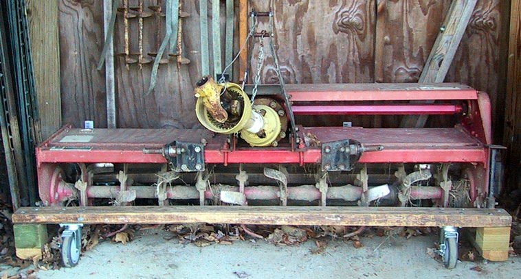

I store everything except the rotary cutter on dollies I made from each, using some HD casters I got from Caster City, I think it was.
They all work well except for the chipper, which is very heavy and there is enough leaves and trash that blows in the open front to make the casters a bit tough to move.

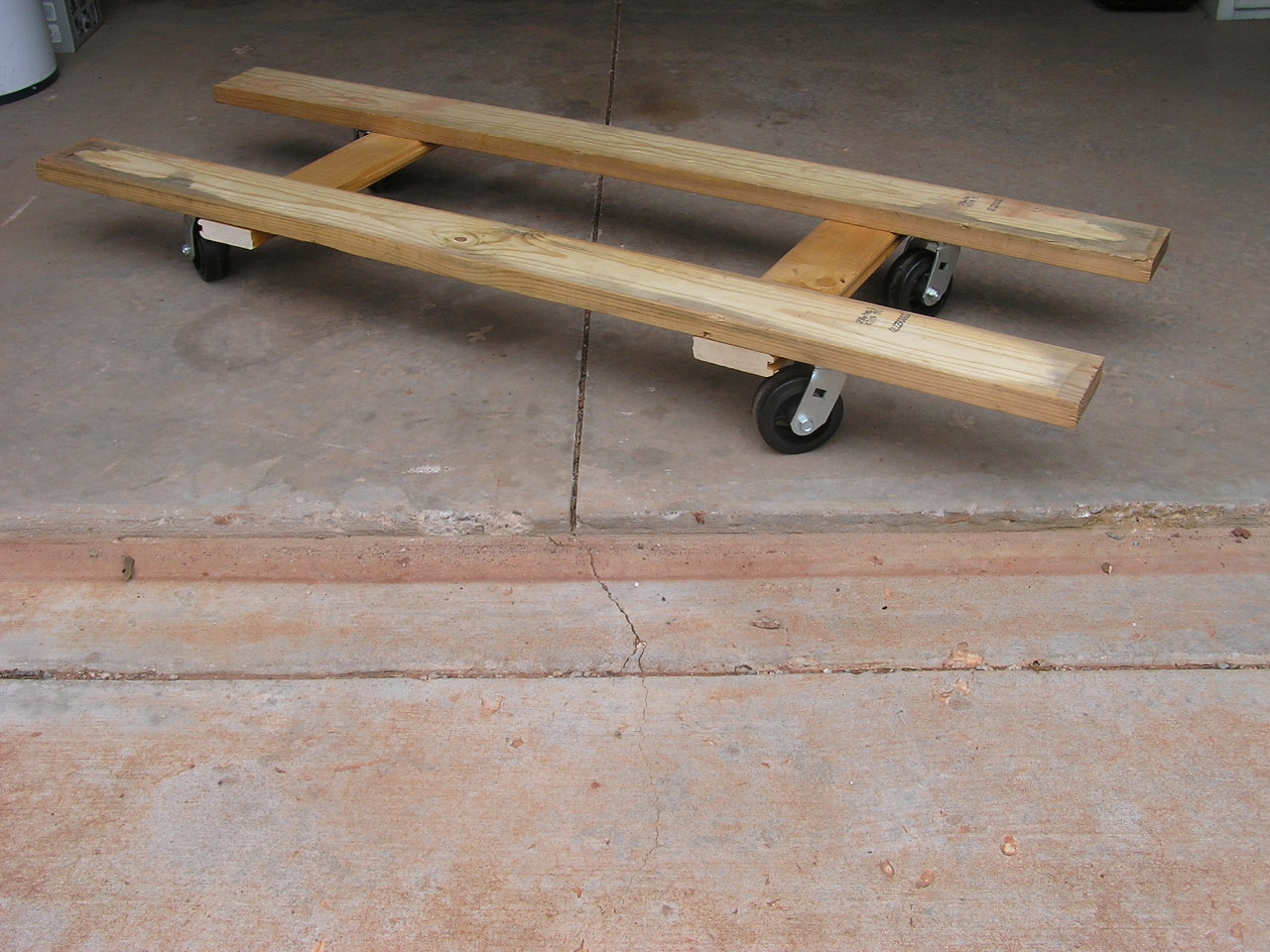

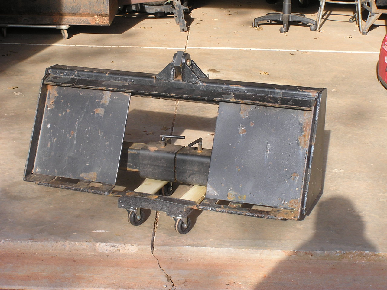

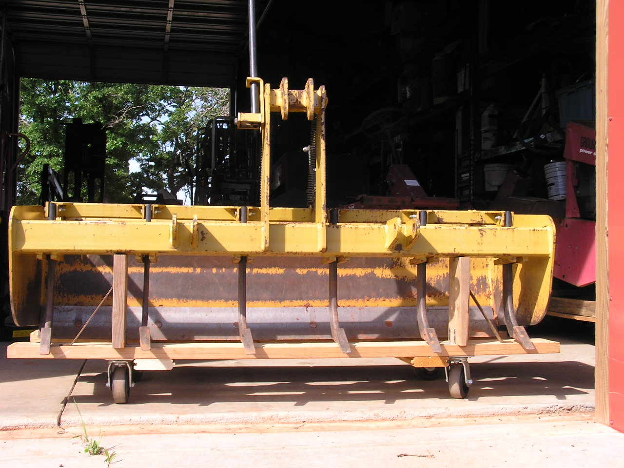

I get my casters from Surplus Center :thumbsup:
Note how wide these 500 pound rated casters are.

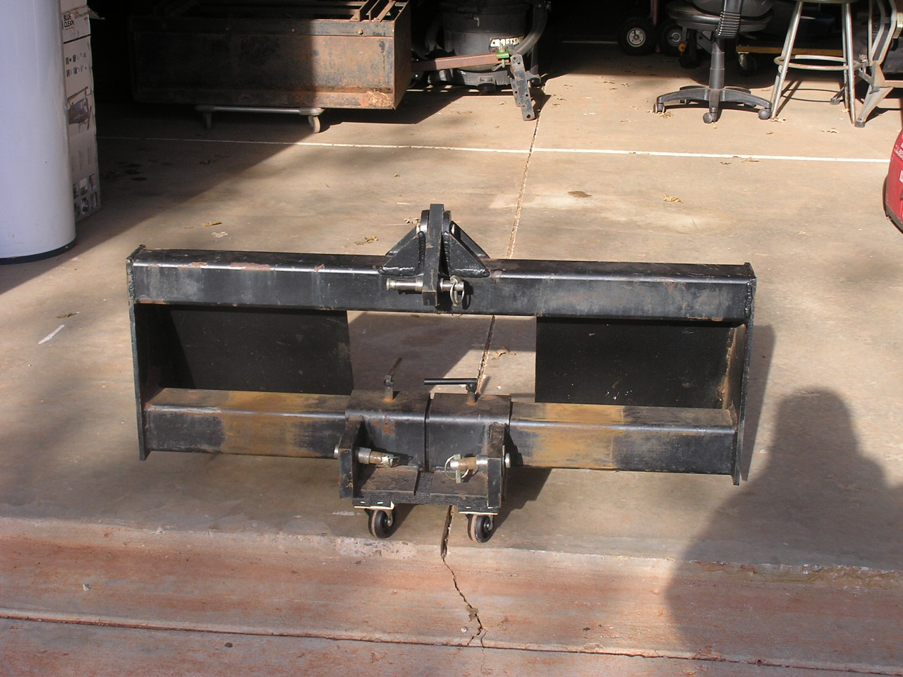

This 3 point adapter is on a cheap furniture dolly.

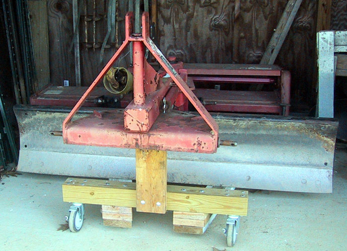

Here is a unique dolly made with two 6" castors and one 4-1/2" heavy duty castor.
