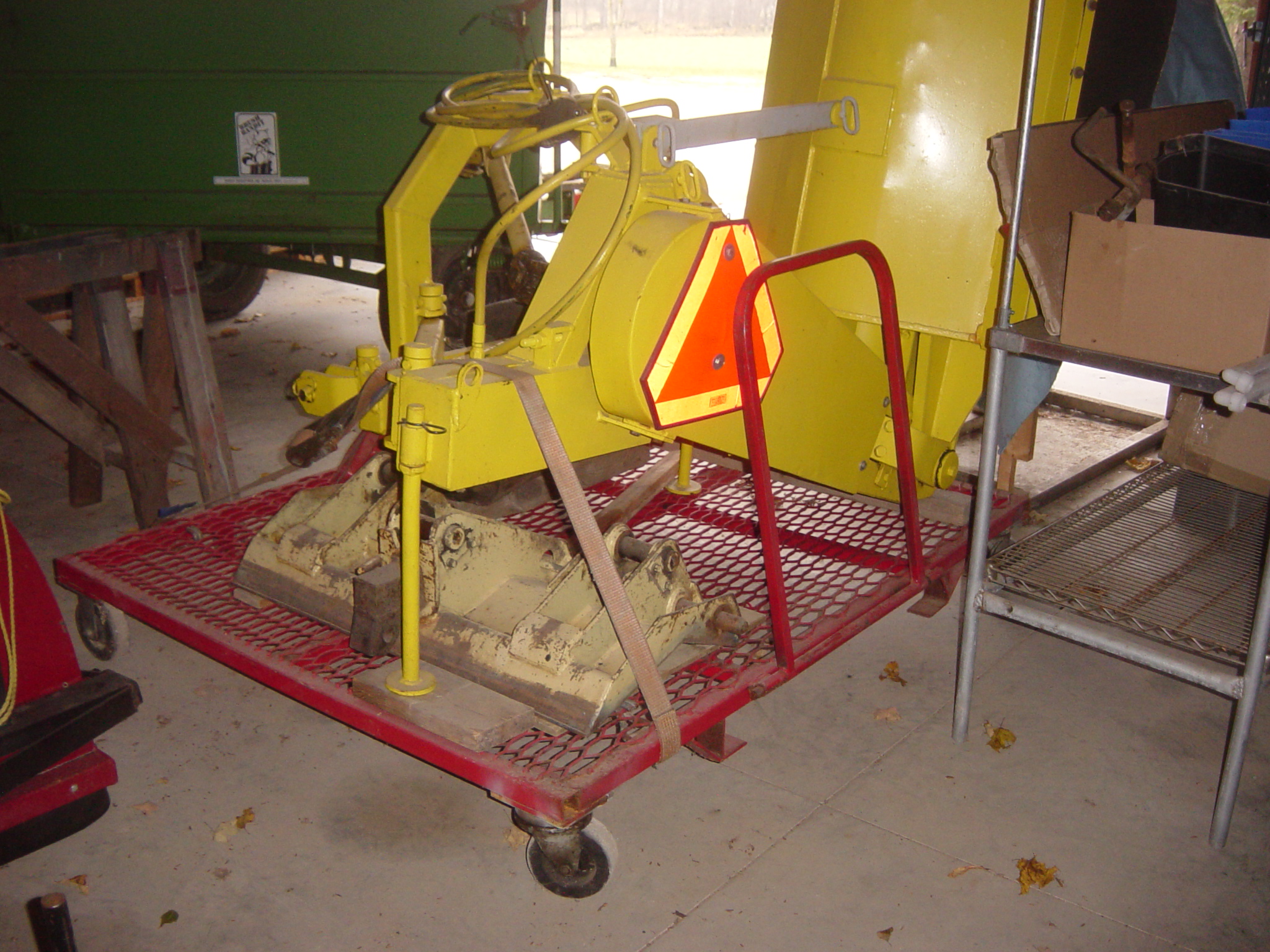

Big ugly contraption I built to store my Ditch Mower/Shredder. It's at leas six feet square.
The arrangements for accomodating forks was far too weak. One should only ever use tubing. Could be VERY Dangerous!

In my opinion, if casters don't have steel ball bearings I have no use for them. Swivel casters must turn on ball bearings. I also want hard wheels, preferably cast iron. Lastly, floor cleanliness and smoothness is your friend. :)
One of my rolling tool boxes is equipped with casters that won’t turn unless you kick the **** things around. One of those “irritating “ things that comes up infrequently enough that I won’t fix it by changing them(or the box) out.
