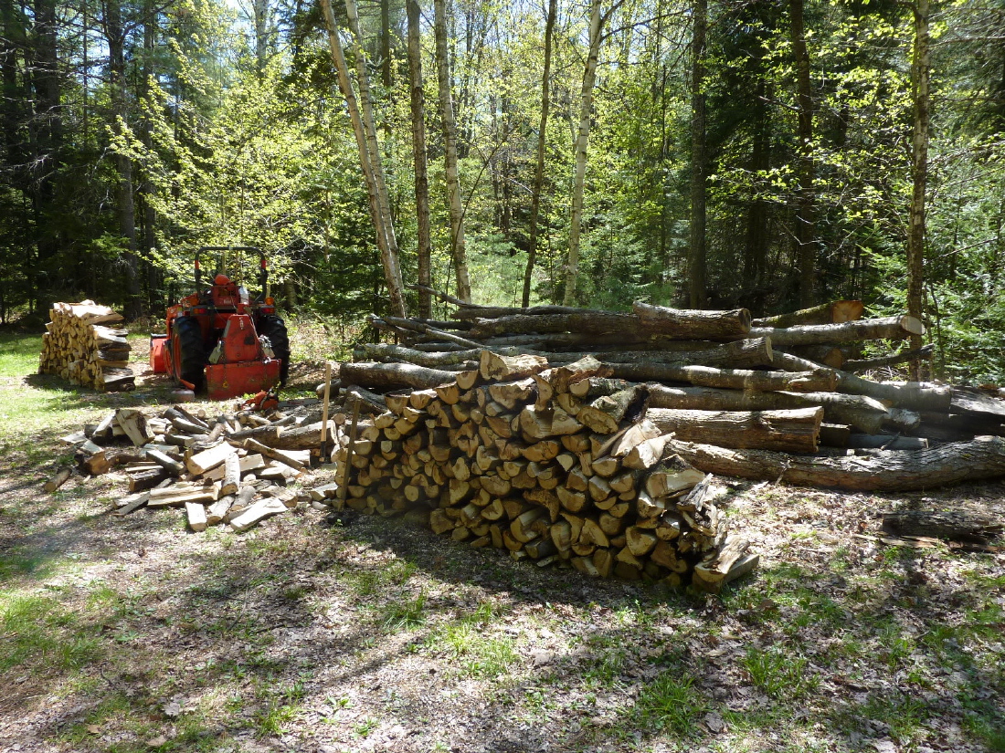

   / Attachment to pick logs out of pile? #5
This works for me. Might have to knudge things around a little first to get the one I want.
