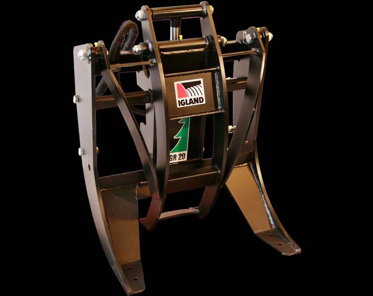

igland gr 20.jpg is this what you have coyote?
   / Attachment to pick logs out of pile? #12
View attachment 351709 is this what you have coyote?
Yes indeed! It is an AWESOME log/boulder/________ grapple.:drink:
I put expanded metal across where sticks, etc. could come toward my grill to further protect my tractor. It's one of my best and favorite attachments and can lift amazing size trees/logs, etc.

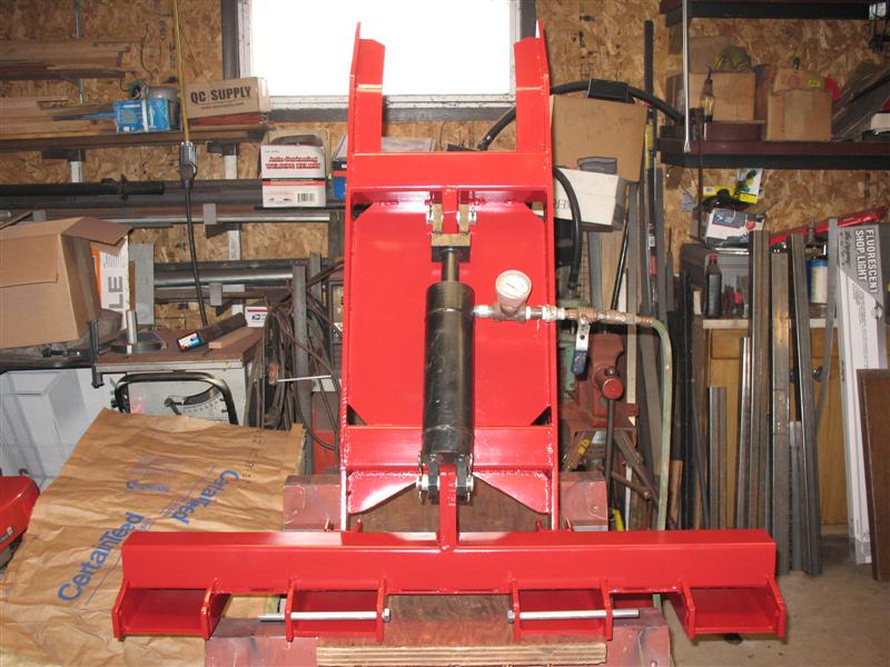

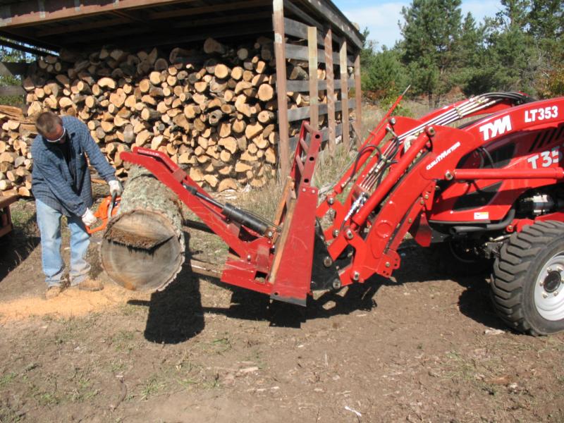

I made this thumb that slides on the forks. Works great for loading and unloading the trailer.

   / Attachment to pick logs out of pile? #17
Looks good. You get some good reach with that set up
   / Attachment to pick logs out of pile? #18

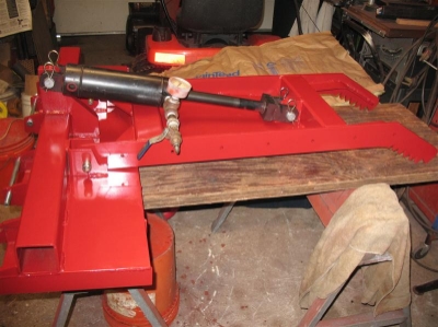

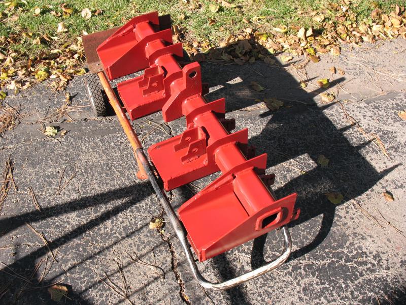

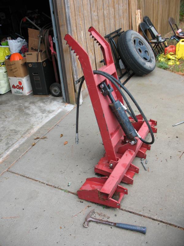

I found a few design flaws with the original build. The cylinder was too powerful ( 2 1/2" bore ) after a years use it twisted the 3x3x 3/16 square tube base. The second version has 3x3x3/8" square tube and stronger guskets for the fork pockets.
