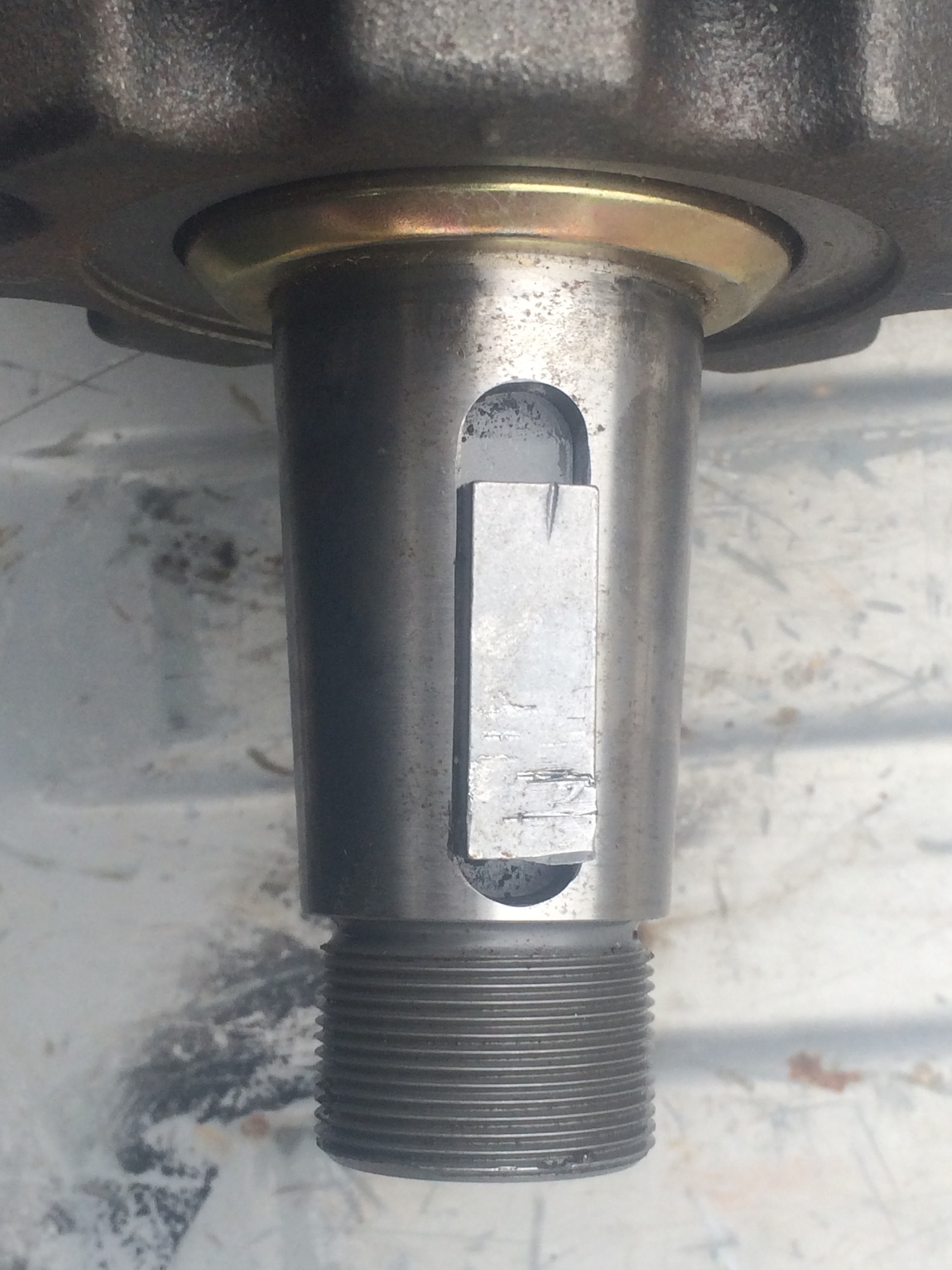

Can a machine shop make me a hub to fit this shaft? I can't find one. Roughly 4'' long 1 5X8 X 1 3/8 tapered shaft with 7'16 keyway. thanks IMG_0356.jpg

Yes, they can. In addition it needs to calculate a cone angle and required length of hub (not roughly, but exactly) minus gap between housing and a hub. Take into account a new hub is in line with the other hub(s) or pulley(s) on a machine.
https://www.easycalculation.com/trigonometry/triangle-angles.php
Have ordered that at the machine shops successfully a couple of times.
/ Attention Machinists #3
The hard part would be putting the keyway in on a taper. None of the places I worked had the equipment to do that.
/ Attention Machinists #4
The turner can do it.
He just looked if he has an extractor of required keyway dimension. I didn't see the process, but that was not a problem for him.

That would be a broach. Need a tapered plug to press it thru.
Op, do you have the old hub? Show us a pic of it. My guess is that it will cost you some good money to get a 1 off custom hub made.

Putting the keyway in would be very simple,indicate the taper in and cut it with a end mill !!!

A tapered bore with a key way would NOT be a difficult group of features to produce. A shaper would make the keyway a breeze

I was ready to say that halfway thru' reading pg 1. :laughing: Could also be done on a mill or lathe (set up for shaper op) by any machinist. A keyway broach bushing could be cast of woods metal for a one-shot, too.
Tricky part would be duplicating the taper accurately with good surface finish. (1-2hrs, mostly setup) I'd expect most 'declines' to be based on cost/time to do both right.
Might turn an original shieve/sprocket into a hub and bolt/weld that to a bore in what's desired, depending on what's on hand that came off the shaft, of course. tog

I'm in north texas. It goes on a drilling rig that I am building. Probably just gonna weld a hub on there with a chain sprocket. I know I know Don't do it, but this is holding up my progress on this thing.

What if you'd bring a motor to a well doing machine shop and ask them to make a correct hub for it? Before that you need to know and to tell them a required hub's diameter and its thickness according to its being in line with the other hub(s) or pulley(s). Most shops in my area have employed the constructors and/or technologists to correct an order. I'm sure you may find one, or even much better, around you.
