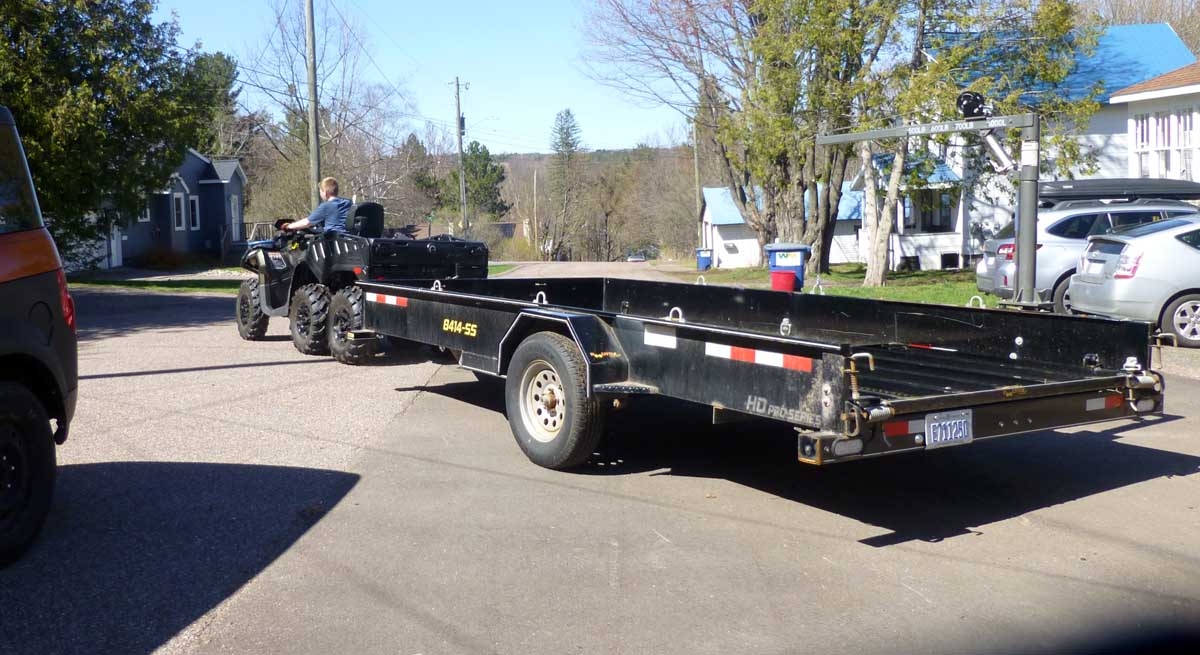

A full cord of some of the better hardwood firewood species I regularly haul can easily exceed 5000 lbs (some will sometimes exceed 6000 lbs). You're towing that, plus a trailer heavy enough to carry that load with an ATV rated for 1300 lbs?
No wonder you burned out a belt. I hope you were at least operating on flat ground.
Cord of juniper wood around here weighs ~ 2700 lbs. Yes, on flat ground. But I actually burned the belt when trying to back the loaded trailer under a roof the John Deere wouldn't fit under. Reverse was geared way too high for that. Pulling forward using Lo Range was no problem.

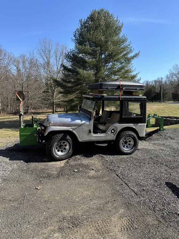

Well my redneck sxs is not only hauling logs, trailers, plowing, tool caddy(ing), gas runs, running buzz saw or post hole digger it is now a temporary residence.

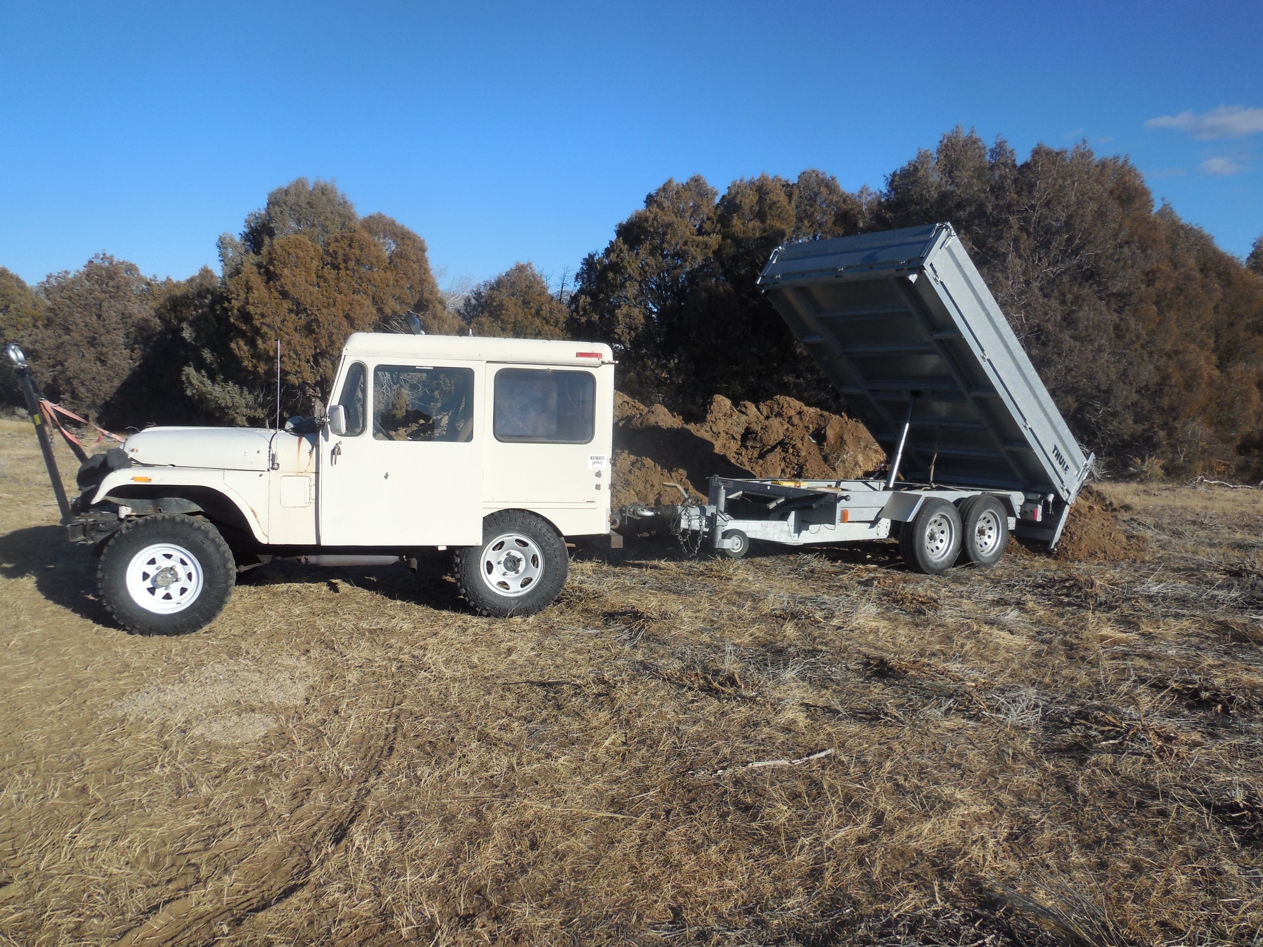

Glad to see I'm not the only one using a Jeep for what they were originally made for.
Okay, mine wasn't, but after converting it to 4WD it does quite good.

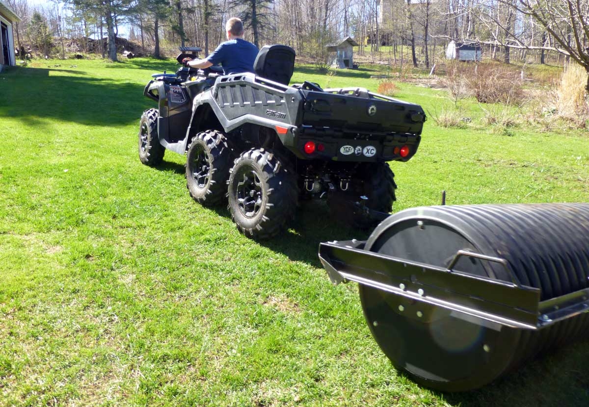

Exactly. Pulling ground engagement stuff has got to be hard on the drivetrain. Don't think they are engineered to handle that much constant strain. I burned out a belt on my Kodiak by pulling a full cord of wood on a trailer.
I assume you used low range? We used Grizzly's and Kodiak's for years and with pretty good luck... Note, these machines have CVT belt that are tensioned at all times because it also has a wet clutch. Most atv's and utv's use this setup todat. We replaced belts yearly.
