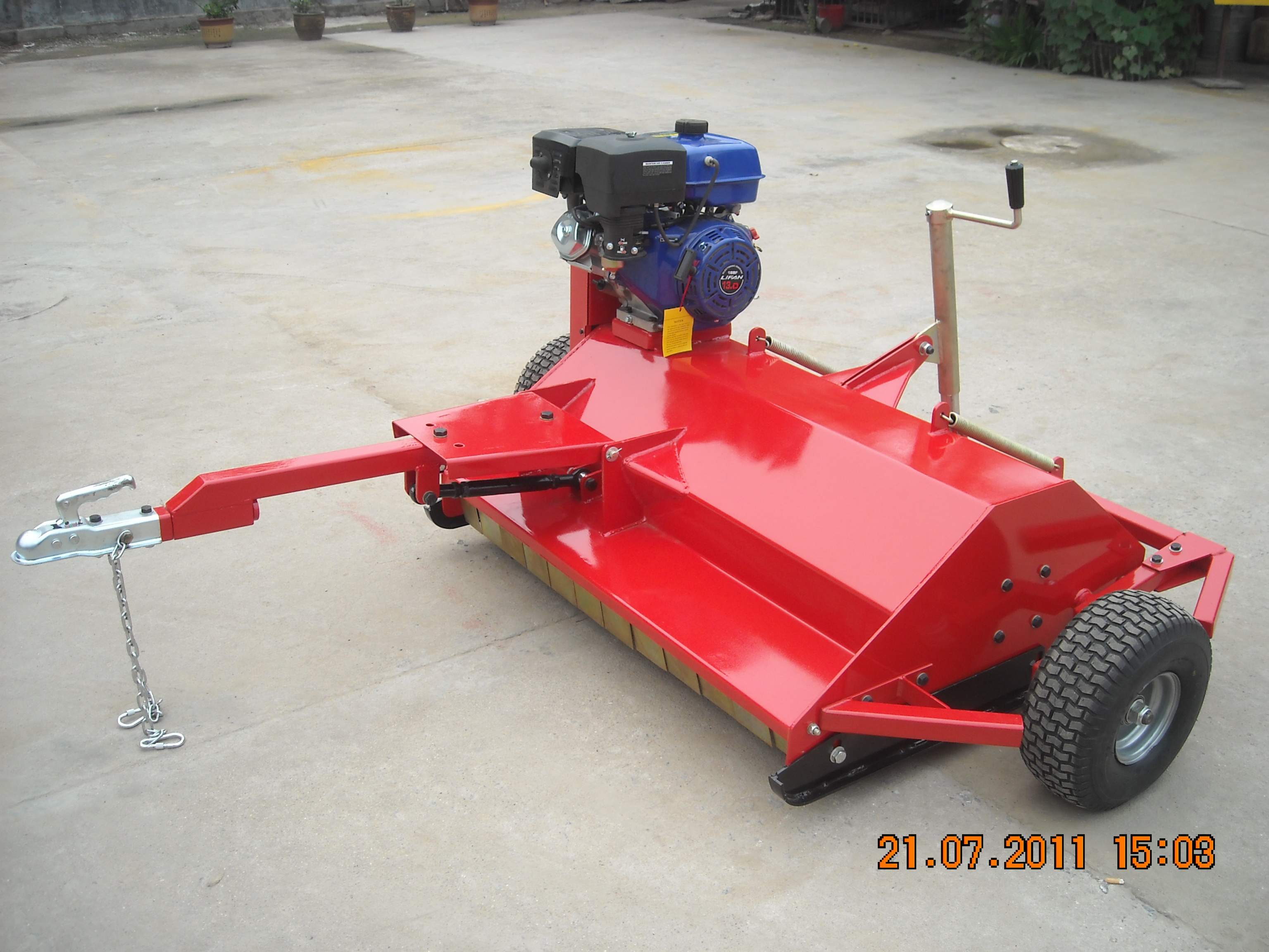

Hello all,
New to the forum, Looking to see if people are interested in self powered flail mowers to pull behind atv's or tractors. Mows very well. Cuts 5 foot plus tall grass and shrubs and 1.5-2 inch saplings. DSCN8571.jpg

How about some more data on the machine. What about a web site, or something.
/ atv flail mower
powered flail mower
will cut and mulch grass, brush and saplings 1.5-2.5 inches in diameter.
Rear roller to protect flails
Easy height adjustment with the turn of a handle
2 inch ball hitch
Weight:280 Kgs
Cutting width:48 inches
Efficiency:2500~ 6500m イ /h
Engine Model: Lifan 389, 13hp gas engine
Engine type: 4-stroke, 25 inclined, single cylinder with Air-cooled
BorexStroke (mm/inch): 88x64/3.46x2.52
Displacement (ml):389
Compression ratio:8.0:1
Max. output (HP/rpm):13.0/3600
Max. torque (N.m/rpm):19/2500
lgnition system:Non-contact transistorized ignition (T.C.I.)
Start mode Recoil and hand-operated/Electric start
Air cleaner Semi-dry, oil bath, dual, double silent and cyclone type
Fuel tank capacity (L/gal):6.5/1.7
Fuel consumption(g/HP-hour):290
Engine oil capacity (L/gal):1.1/0.29
Dimensions(LラWラH) (mm/inch):510x460x450/20.1x18.1x17.7
Will try to post video soon.

Just my opinion:
I can’t see how anyone could justify that price, when rotary cutters are so common and can be had for less than $1k.
No offense, but I don’t believe that it can cut trees 1.5-2” in diameter. At least, not without getting very beat up.
/ atv flail mower
Just my opinion:
I can稚 see how anyone could justify that price, when rotary cutters are so common and can be had for less than $1k.
No offense, but I don稚 believe that it can cut trees 1.5-2 in diameter. At least, not without getting very beat up.
I'll post a video soon, and yes it can cut trees 1.5 -2 inches and not get beat up, I would not recommend going through and cutting a forest of 2 inch saplings down, that is not what any mower is intended for. It has great ground clearance when needed, and this can also cut your lawn to a finish cut and bush hog. Great when you have more than 2 acres to mow, either to a finish cut or rough cut. I could probably get the price down a bit with larger orders, but probably only down to about 2k+shipping.
