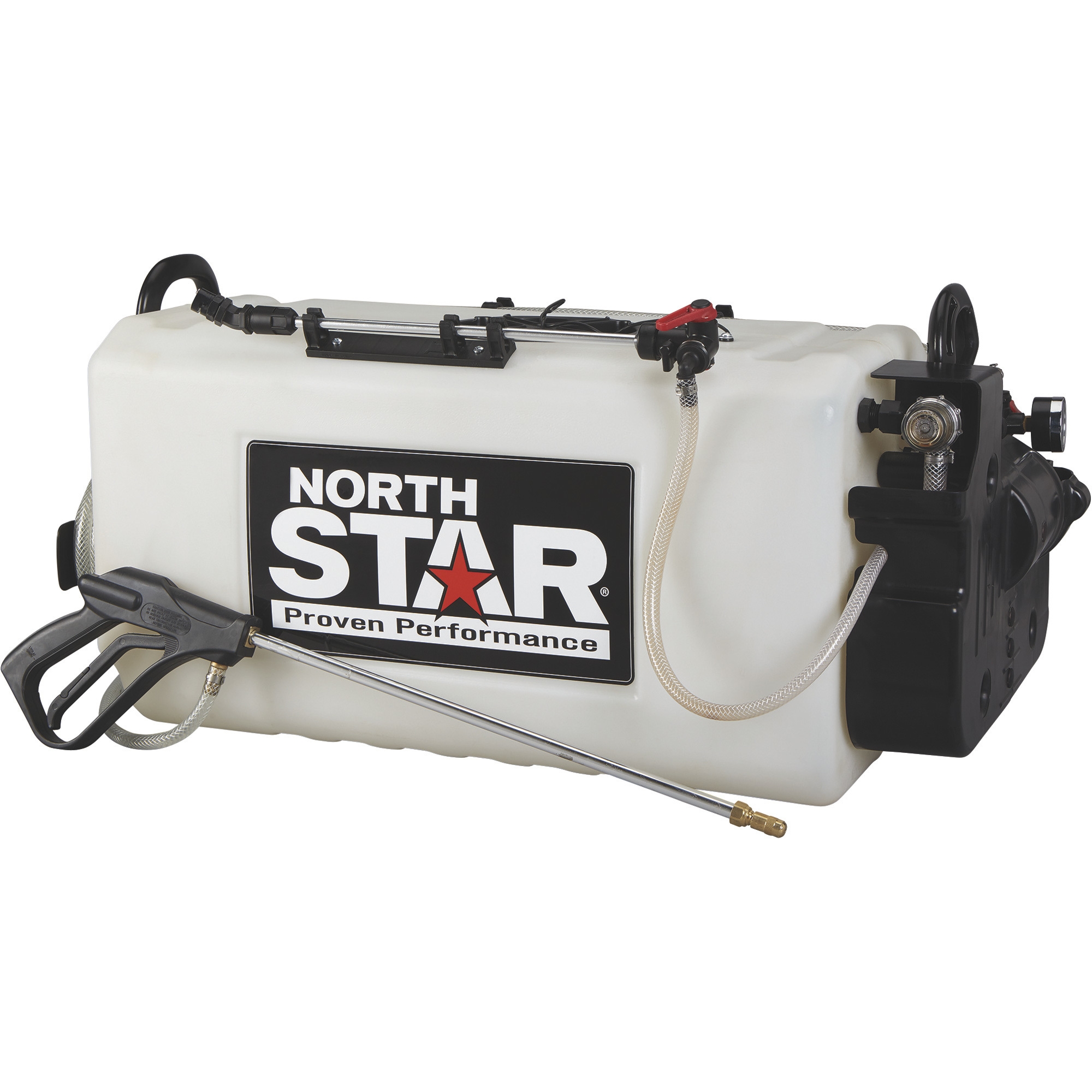

I got an old North Star 26 gallon atv mounted sprayer. It doesn't have an agitator.
How can i mix glyphosate with water in the tank? Just to fill half tank, add required
amount of glyphosate, and finish with water? Looking for suggestions...

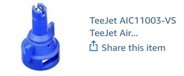

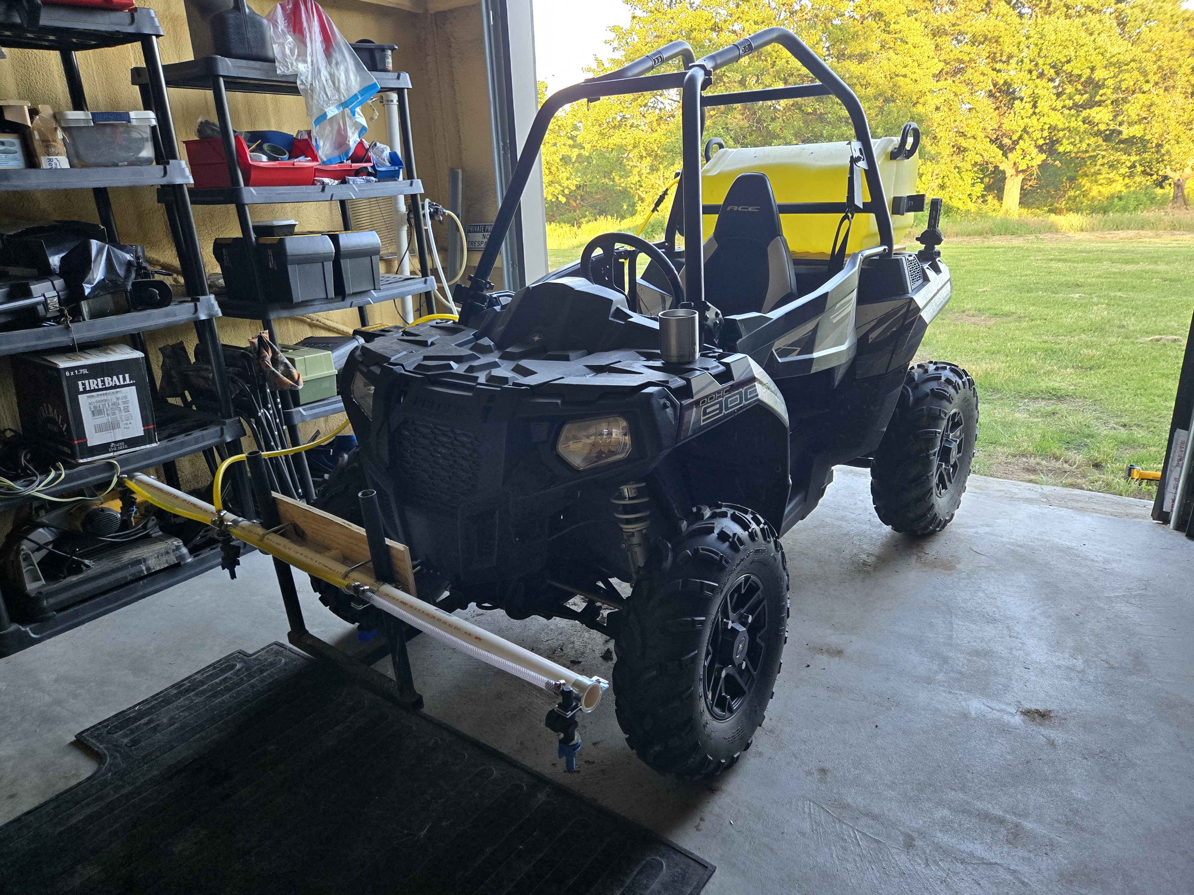

I have the exact unit. I love everything about it except the lid that just doesn't want to properly thread but whatever. Glyphosate will go and largely stay in suspension. I do what Sportsman762 does but in the end I use an ash shovel but you could use any large scoop or paddle and stir with a gloved hand of protection. You can watch it improve the mixing as the color changes.

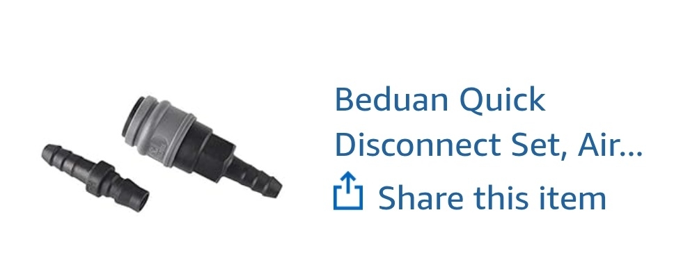

For chem that doesn't stay in suspension, I stir and have a dedicated mixing pump that pulls from the opposite end of the tank and then vents straight down into the tank...from the hole plug that replaced the lid (not depicted in photo). Now there's two round wood plates screwed together. One fits inside the lid hole; the other just sits on the top with a small pump mounted to the top of the new "lid". This seems to keep chemicals like pre-emergents suspension along with thrashing the thing around a bit with "drunk weave" driving. BTW, the quick disconnect is great for separating the tank from the spray assembly. The TeeJets are wonderful; they will tolerate about 125 psi IIRC but they pop at 5 psi which means they dribble what's below the internal valve but doesn't allow the entire hose to drain.

NorthStar ATV Boomless Broadcast and Spot Sprayer, 26-Gallon Capacity, 2.2 GPM, 12 Volts​

I can see the return port that they use for agitation in that photo above. I know, because I have the same unit, except I have the 12' boom attached
Your 26 gallon doesn't have it?
