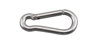

The frame didn't bend from pushing, it bent from being lifted up while there was a build up of wet heavy snow on the frame. His reinforcements look great to me. It is a strap winch which helps. If he wanted one other level of protection, he could attach a (deformable) spring clip, or a heavy spring between the strap hook and the plow.
