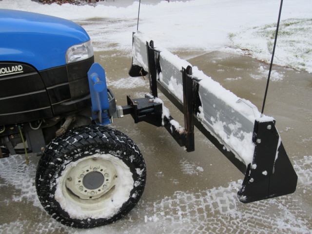

I have been looking for one of these Snowsport plows for some time (used) so I could try it. They seem like a cool idea.
I found the HD truck model that I can use in the receiver hitch on the truck or tractor.
