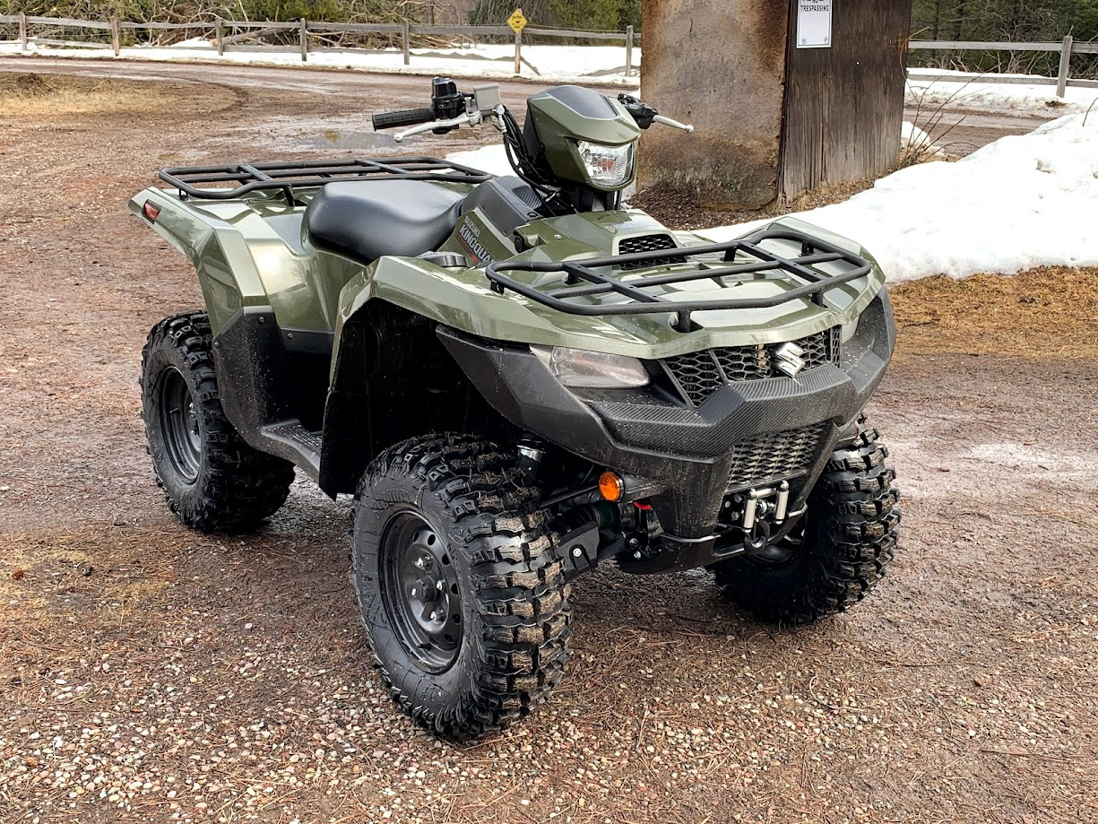

I love my Suzuki Kingquad, battery is under seat, air filter on cover where "tank" is traditionally. Oil dip stick easily available on left side, oil filter on front left side, turn steering wheel to access it. And together with Yamaha best CVT transmission as far as smoothness and reliability goes. I had 4000 miles/400h on my old KQ Powersteering 500 before it got smashed by a tree. Now I have a 2020 750 Powersteering. Separate front/rear brakes with manual front diff lock.......nice simple machines.
