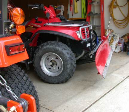

Well I finally found time to put on the new blade, I went right out and started pushing gravel around. You are all right I think I will like plowing snow with this set-up.
Thanks

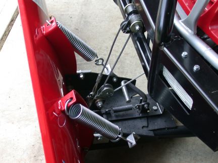

I had to get a little creative when I was attaching the blade to the winch.

One more picture. The winch is mounted very low in the frame on my ATV so I had to get to a higher lifting position, and I also wanted to slow the lift down with the pulleys so I can hold the blade up with the winch for doing the gravel.
