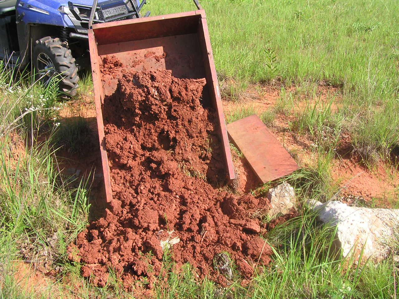

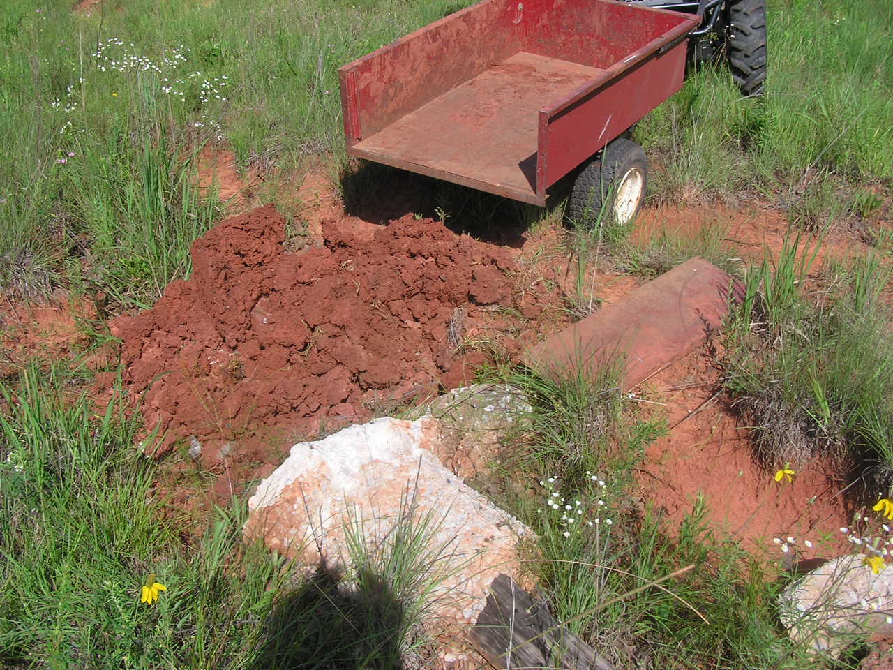

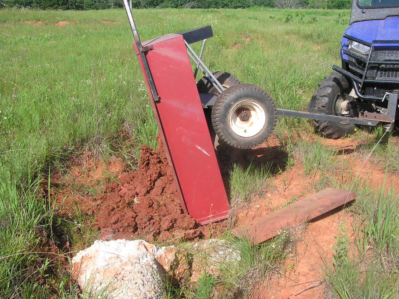

Here's one from an earlier post on this thread. It wasn't skinned then but you can see the dump angle. Pretty steep, and I doubt it will leave anything much in the bed.
Thanks, if it is like mine, it will go steeper.:thumbsup:
Just push it back further. :D

Yea the only thing stopping mine is the ground. So if I back to a downslope, it will stand straight up.
