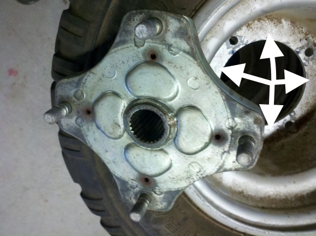

There was also a set of tires and wheels to go with it, and that is part of my dilemma. I have taken apart one of the front suspension setups, and have the hub and spindle cleaned up, since it has been sitting outdoors for years. My issue is the rear tires, my preferred ones, are 10.5" wide as opposed to the fronts that are taller and 7" wide. The issue I have is the hubs/rims for the rear. They are metric but since I don't any metric measuring devices, they measure about 4 bolt on 5 1/6" circle. Plus the rear axle on the old quad had the bearings in the center of the axle, instead of wheel hubs, like the front.
I hope this makes sense.
This is the hub for the rears. The splined axle it goes on, measures .976", so the hubs could be drilled out to 1.00" fairly easy, but there are no bearings in these hubs, so I can't weld or bolt them to a standard axle.
And here it is in the wheel
So my question for you folks, is can anyone suggest a way that I can adapt this hub to some load bearing axle? I could probably get a steel rod or tube that I could weld these onto, it I had a load bearing pillow block style of bearing. It would have to be able to support substantial weight. Also I need another one of these wheel hubs.
I have scoured the internet and cannot find one. I also priced standard hubs (4 on 4" circle) but that requires new tires, and rims, which gets way outside of my budget.

I one of the earlier pics you can see the hub for the wider wheel. I THINK I figured out a way to make this work. The inside of the wheel opening is just a smidge over 4" wide and I got to thinking that IF I can make a plate that fits into the wheel, and drill it for the existing wheel studs, then mark and drill it for a more common 4 on 4" hub,then I can bolt the plate to the wheel, and mount the wheel on a standard 4 on 4" hub.
Another method would be a ring inside the wheel opening, welded to the wheel. The ring could be marked and drilled to a 4 on 4 pattern. Since the wheel opening is basically 4" I think it would be fairly easy to mark and drill with a high degree of accuracy. I would only attempt this since this will be an "off road" setup, and top speed of 10-15.
My big road block is the wheels are aluminum and I cannot Tig weld. Now if I can find someone to weld it for me local, reasonably, it could still work. The first method would not require welding but is a little more awkward looking, but I don't care, as long as it works.
I am only considering this to keep costs down.

Another option would be to drill the wheel to fit a hub with bearings in it.
/ ATV Trailer build #10
A little googling shows that 4-on-137mm (5.39") and 110mm (4.33") spacings are pretty common. I like a simple plate with bolts welded on at 137mm, and holes to go on a 4-on-4. No rim welding needed, simple and direct.
There's also a bunch of 4-on-4 hubs out there for gocarts and such with simple ball bearings that would mount directly on a plain axle, as opposed to a full trailer axle hub with tapered bearings that mounts on spindles. Might save you a buck or two.

I don't think the simpler bearings would hold the weight if the trailer were loaded heavy. I might be wrong though. My trailer dimensions are 30 wide and 48 long, at the floor, but at 10" above the floor the sides taper out to just under 5 1/2ft wide. So if loaded with dirt or firewood it could weigh a bit.
Even the ones with tapered bearings are not too expensive, about $40 for hub/spindle combo. Mine is neither of those sizes, by the way. I do not have metric measuring equip, but at approx 5 1/16", that converts to more like 125-125mm.
I figure if I go with the 4x4 it would be easy to step up to other tires and wheels later, if I needed to.
Yea that was the idea with the ring or plate added in. Hmmm, I wonder if there is a 4 on 5.5? The other issue might be the hub outside diameter fitting inside that rim as well. That was one reason I thought of the 4 on 4 hubs, clearance would not be an issue.

Your odd mixed fraction threw me (5-1/6) if it's closer to 5.6 then yes, there seem to be a bunch that use 140, 143, or 144mm. Since most trailer hubs outer edge seems to be at 5-1/2", you will probably need some sort of intermediate way to go from that to your wheels, rather than just redrilling the trailer hubs.
If you have any old trailer wheels around (or can find some cheap) could you cut the centers out of a couple and drill those for the larger pattern?

No not 5.6 in fractions it comes to 5.166 it's 5" + 1/16" 5 1/16. It was a typo on my part. I corrected it.

In that case, you might be able to get away with drilling a 2nd set of holes in a standard hub.
/ ATV Trailer build #18
5-1/16 = 5.0625 =~ 128mm. 130mm seems to be a common size too...?
I agree, but the front hubs will not fit inside the rear wheels, by a long shot. The inside of the front wheels looks like it would allow a plate of approx 6.25", maybe slightly less. I would cut something from wood to test before making a metal one though. The front hubs are about 7.5" in diameter.
If I came across a cheap set of hubs on craigs list or similar, I would surely look into that.
Now another thought just came to me. If I can locate another rear hub, (I only have one) I could bolt those into the metric wheels, and obtain a set of 4" hubs (If I do not find a cheaper set to drill as above) and cut the center out of the factory hubs and use THOSE as my adapters (IF I can fit them into my lathe)
