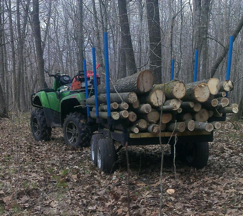

A couple pics of my ATV trailer in use. I've been using those 3/4" wooden boards for 15 years, a few patches here and there. If I get a chance this year, I'll replace them.
   / ATV Trailer build
#106
That trailer is sure rugged, are those tires on the pass side, different sizes? Optical illusion? I am picking up my steel angle tomorrow, 3x3x1/2" to make my brake, 20ft of angle for $50. Local shop wants $78 for 20ft of 3x3x1/4". Then once I get it built and get the cash for the sheet metal, I can do my own fabricating.

Mine's 6' and has never been a problem on firm earth. I have run into putting enough weight in it that it just sunk into the mud and when I winched it, it just rutted everything up.
The biggest problem with towing with an atv isn't being able to pull it, it's being able (or not) to stop it. If you end up with a heavy load behind you on a hill and lose traction things get ugly really fast. That's the main reason I didn't use my log arch more before getting my tractor. I could pull a 2,000# log easy - but I couldn't stop it if I wanted to on anything but an incline or flat land. I have a lot of hills on my North 40. The South 40 is almost text book definition of flat. Even so, I just parked the arch and held off since I couldn't stack the wood anyway.
