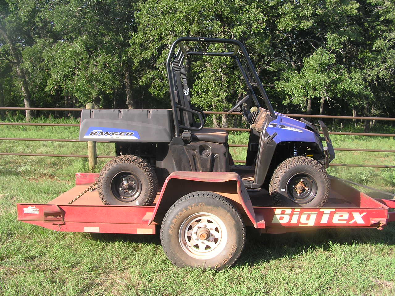

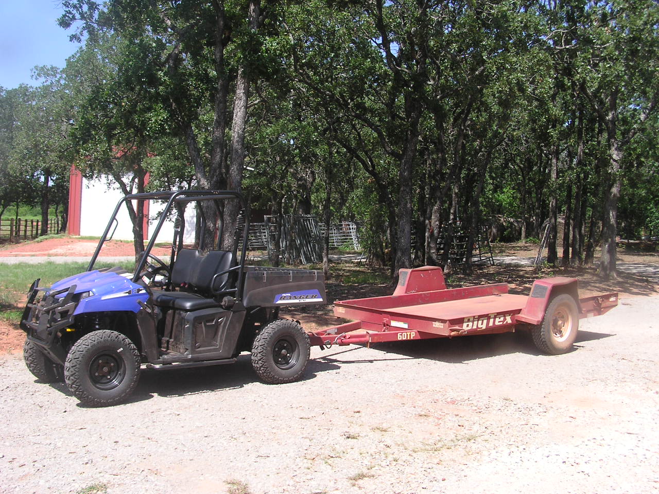

Interesting.. Never thought of the idea of getting a road worthy trailer that a ATV could pull. That sounds like a great idea. I always thought an ATV trailer would be small but I guess it will pull quite a bit.
Click to see what it will pull: http://www.tractorbynet.com/forums/...7792-electric-polaris-ranger.html#post3544626

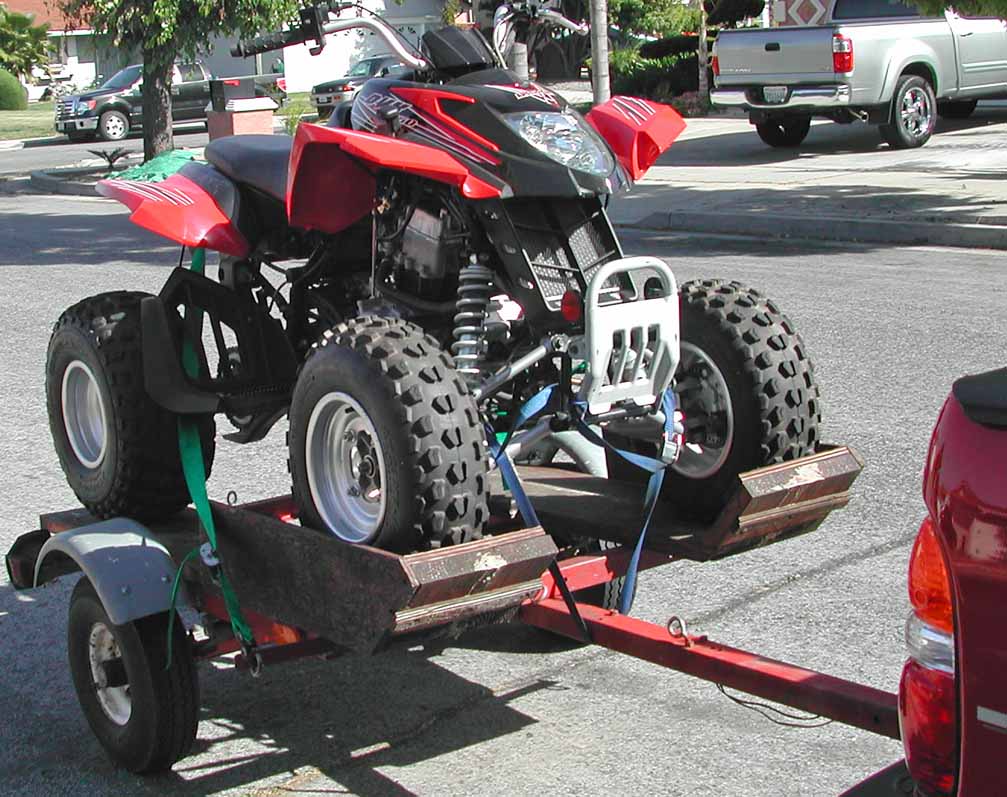

Why would you want to switch to ATV tires? The trailer tires (even the 8s and 10s) have MUCH greater capacity
vs. the 5psi flotation tires that come with your quad. Cost less, too, usually. You probably could mount
an ATV tire on the trailer wheel, if you really wanted to go in that direction.
Note that there are 6 or seven common ATV wheel stud configurations, while many of these trailers are 4/4.5".
ATV wheels are usually 4/110, 4/115, 4/130, 4/137, 4/140, 4/156, etc.
This old trailer is one of the earlier Home Depot units, made in Taiwan in the early 90s. It tows very well on the
highway, as well as behind an ATV.
I have had a few of those crappy off-road ATV dump trailers (Agri-Fab and others) and they are lousy, even
after you convert the pin hitch to ball hitch.

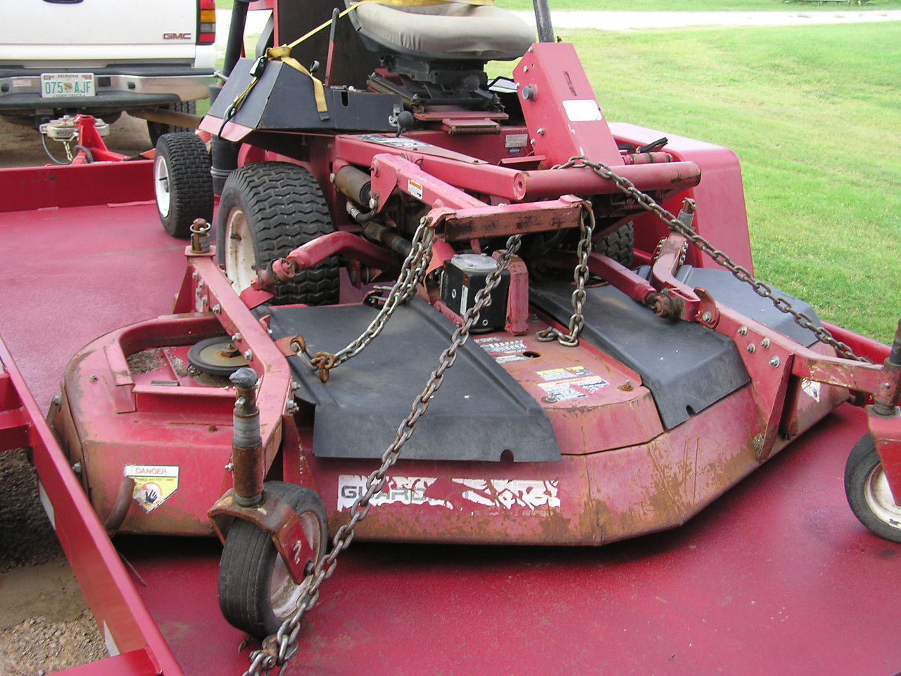

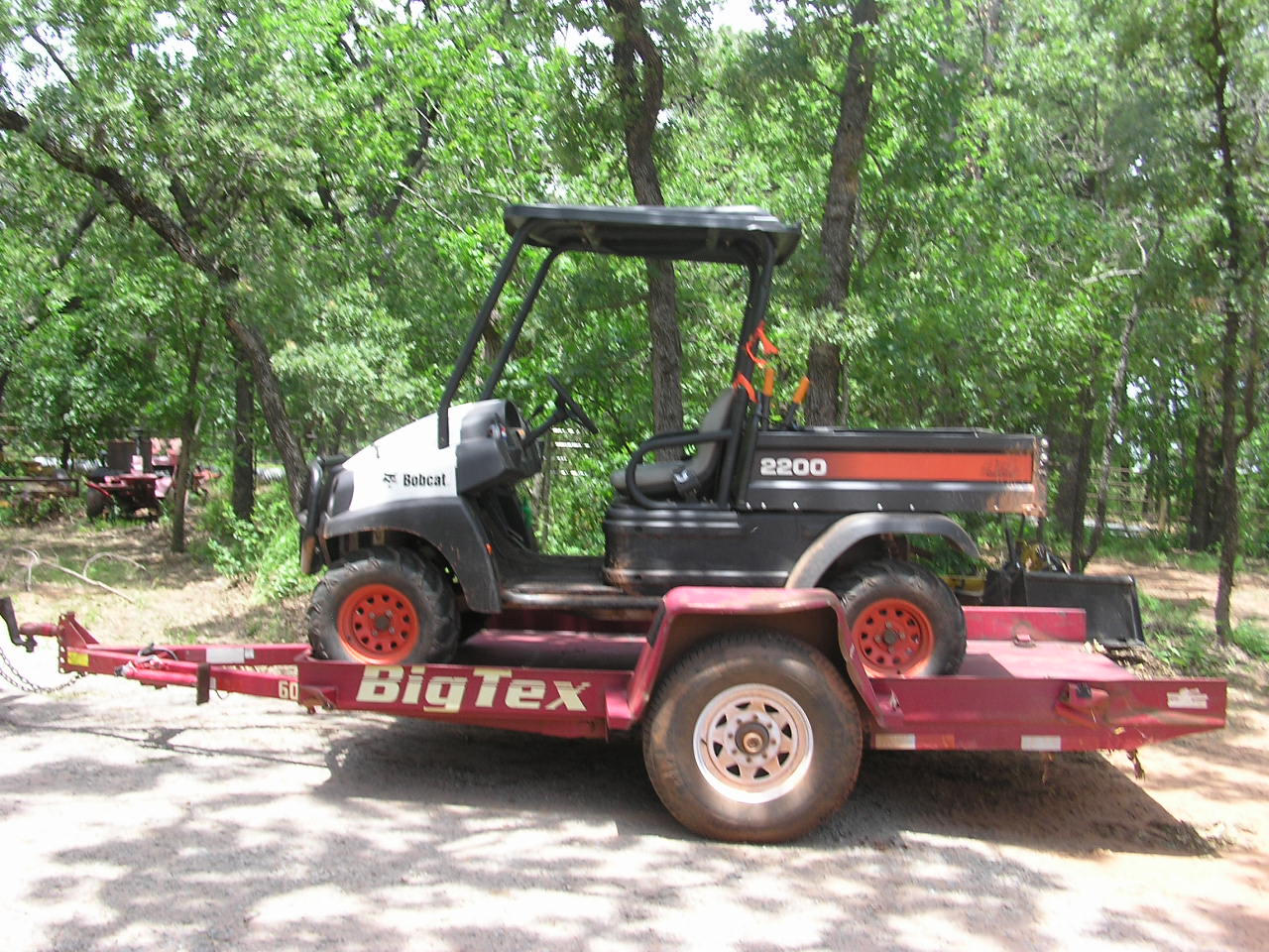

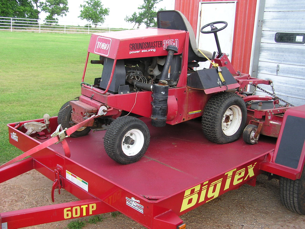

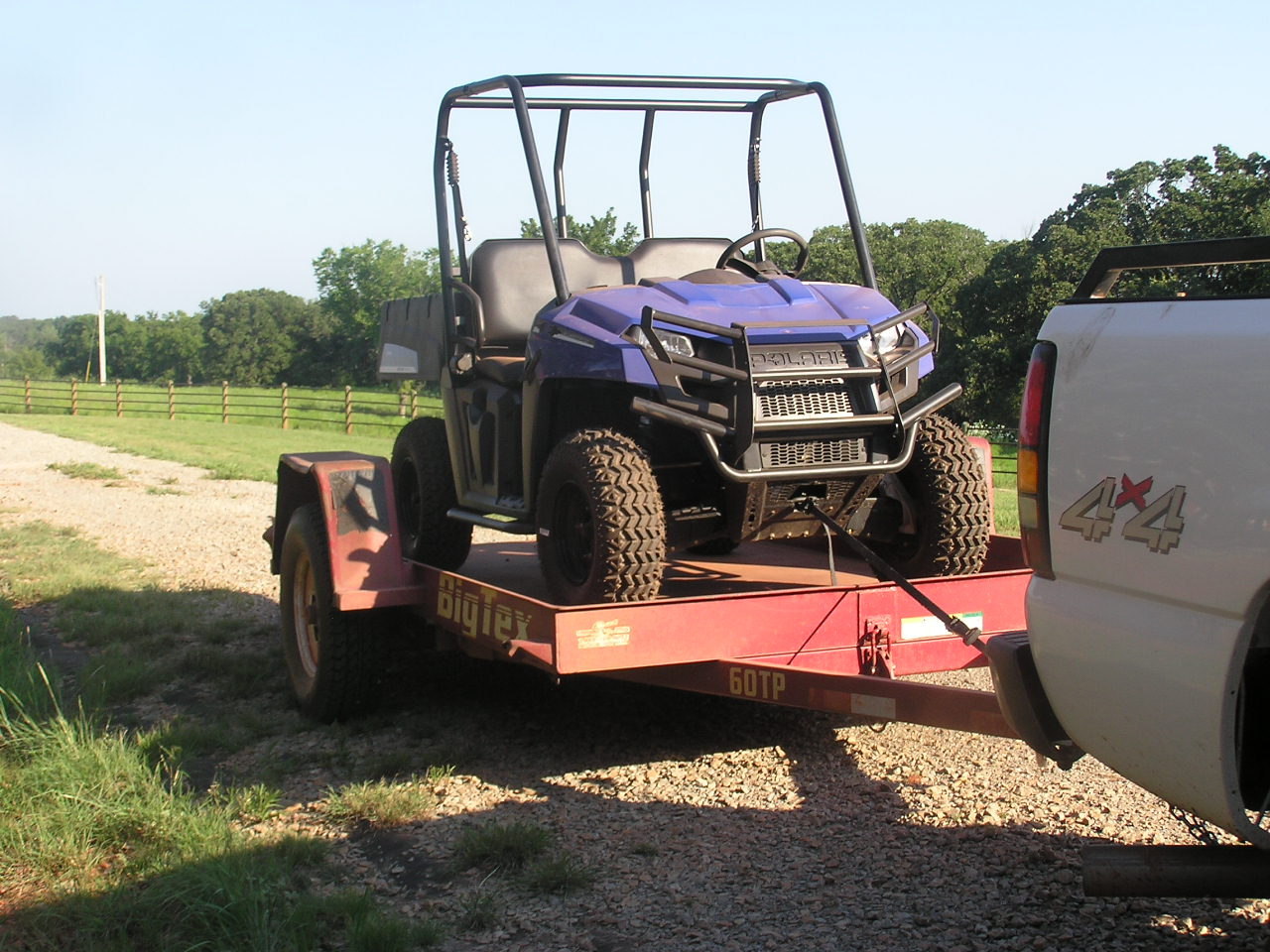

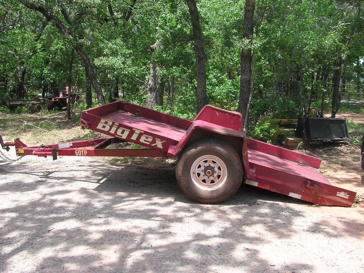

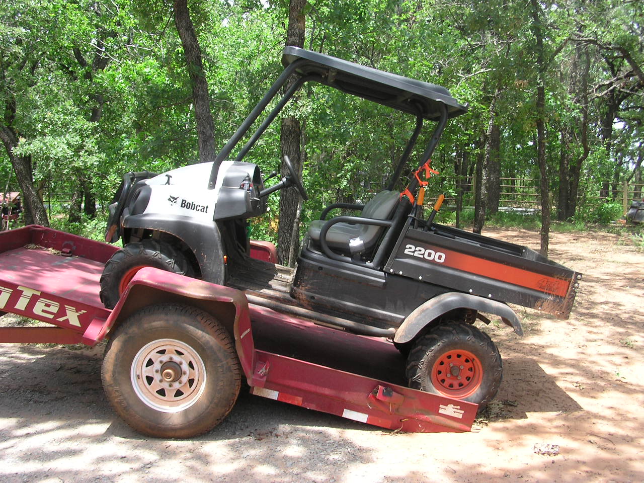

This one is a Big Tex 60TP Single Axle Pan Tilt Transport , rated heavier than I needed, at 6K, but I needed the width. I think it weighs about 1700 pounds.
I bought it about 7 years ago to haul a 6' deck mower, over to mow my MIL's place.
It is so nice not to mess with ramps! :D

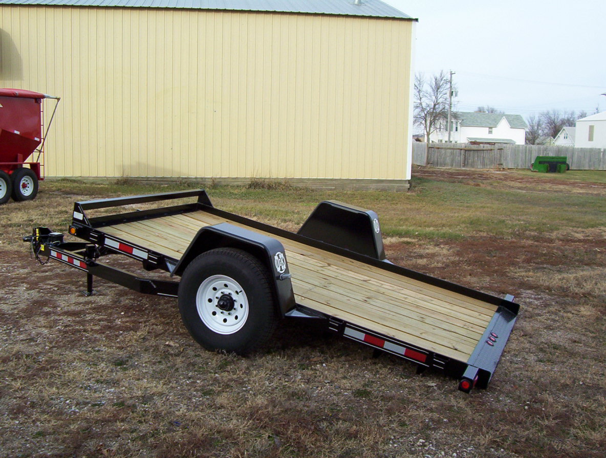

There are other brands of single axle tilt trailers that are narrower.
Here is one:http://www.dktrailers.com/trailers/Tilt Deck Trailers/index.htm
You can search for "Scissor Lift Trailer": https://www.google.com/search?q=Sci...7&sourceid=chrome&espv=210&es_sm=122&ie=UTF-8

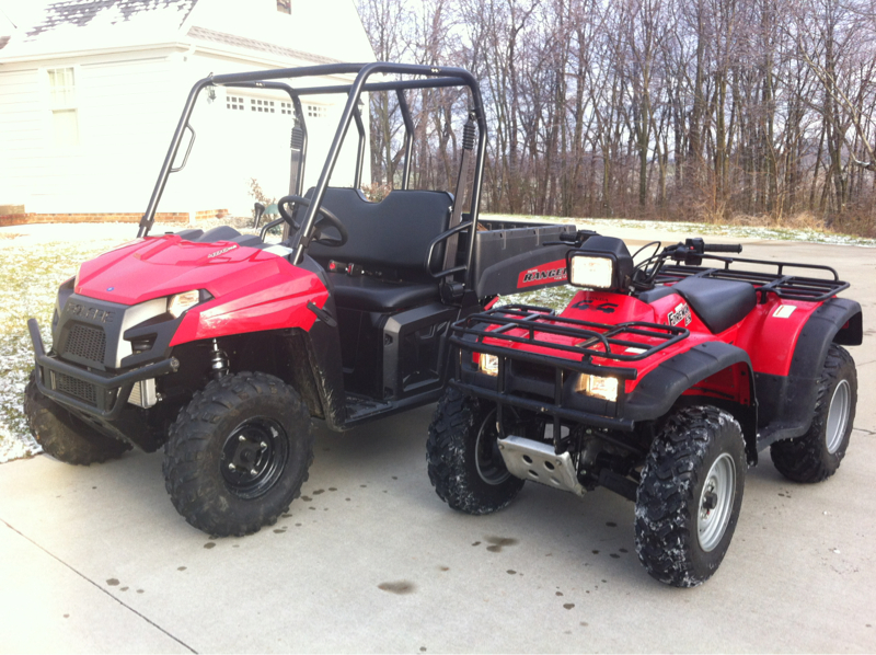

I really like my Polaris Ranger 400 HO and Honda Foreman 450 ES.
If I only could have one I would get the UTV! Handy around the house!!! Has unlocking rear diff!
