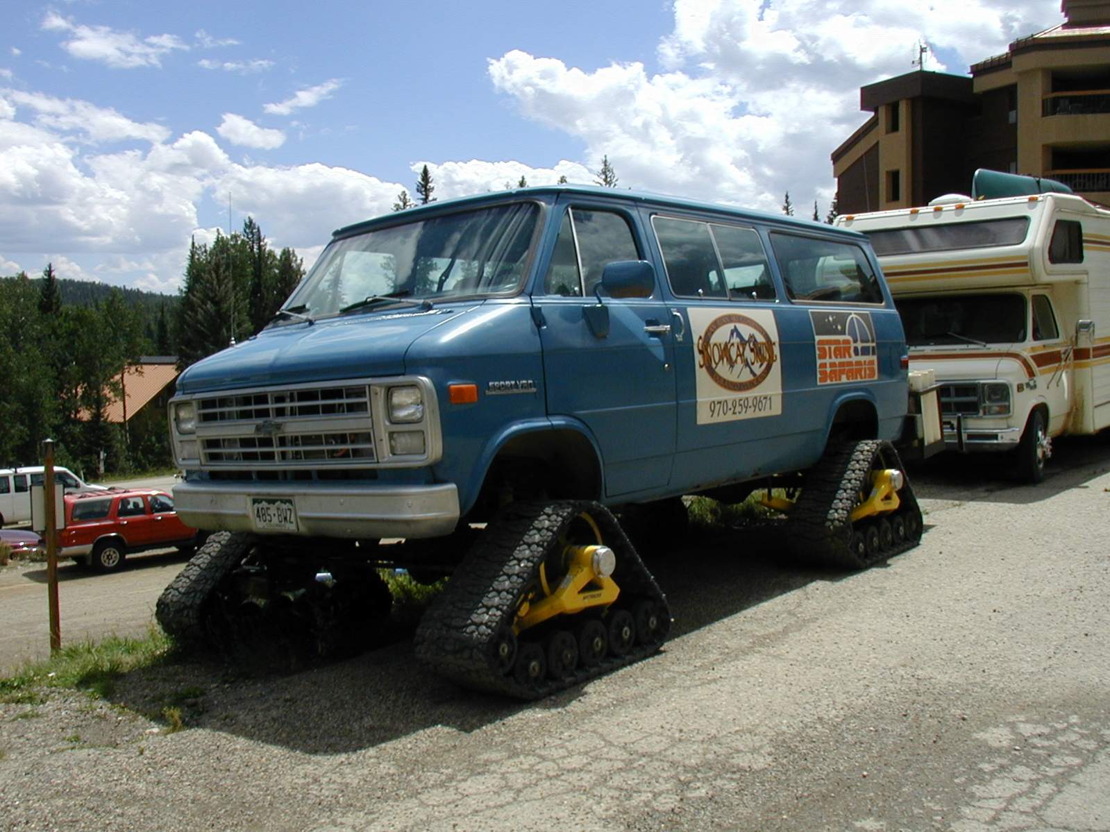

Just another "Tracked Vehicle", I would like to give this one a try in the snow.

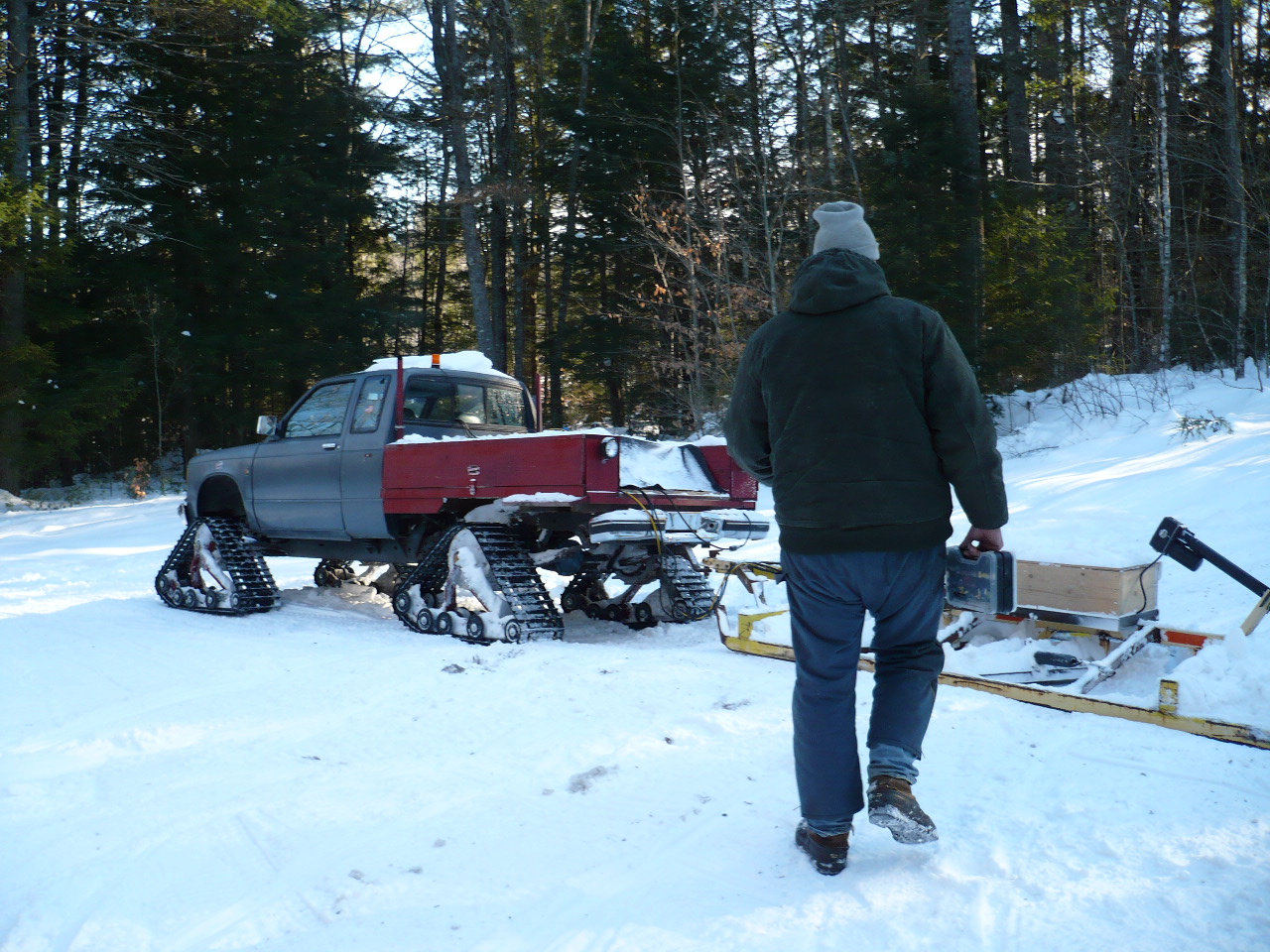

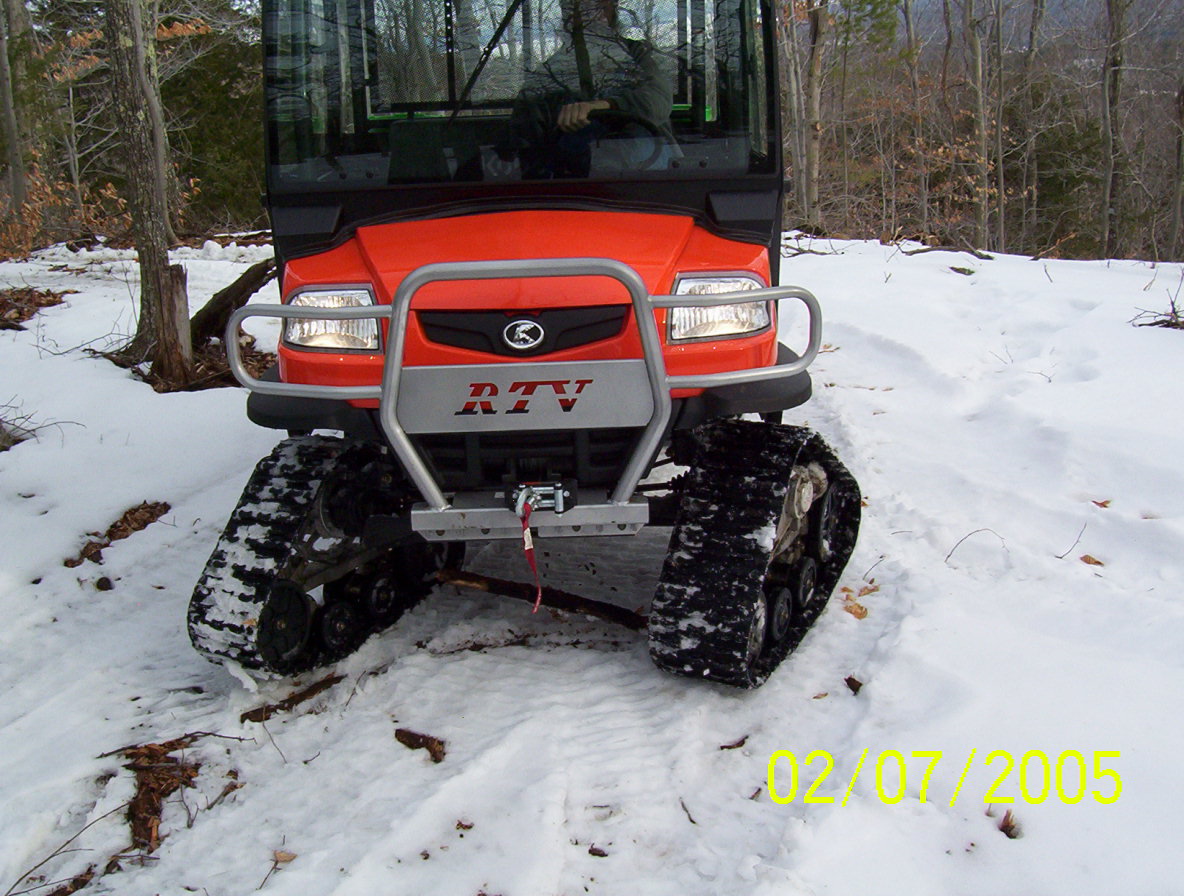

My father runs a RTV with tracks. Honestly, the thing sucks. Granted he's up on top of a mtn dealing with more snow and steeper terrain than average, but the thing is pretty useless. Once the trail is hardpacked the tracks spin like crazy. On unpacked trails the rig sinks like a rock. Even with some cleets on the tracks it isn't much. Tires with diamond studded chains go better as long as he keeps a trail open after each storm.
Here's some pics of the clubs S-10 with tracks and the RTV. Dealer said there was two types of tracks, all season and snow. The all season didn't work well so they bought the snow tracks. No better. And after getting stuck the rtv rolled the track frame up under the machine. Was a chore getting this unstuck. I'll try to find the pics, took the excavator to get the thing out and back to the shop.
If I were to do it for riding I'd definitely get the power steering and the snow tracks. My big boss Polaris is getting over the wheel tracks soon, not sure what to do about the front wheels. :confused:
I am suprised that the tracks cause more stress, as they seem to gear down the machine allowing more torque to the tracks than if it had wheels, but less speed. Seems like that would lessen the strain on the drivetrain but certainly increases the rpm that the equipment is turning.
As for trails, I groom for the local club, have for 21 years, anything that is tracked is welcome on our trails. ATV tracks seem to tear up less trail than an 800 cc snowmobile with a 15 yo kid on it.:mad:

Interesting. Would think the RTV with tracks would be a tank. I've watched some awesome footage of tracked big-bore ATVs plowing snow and running mud with a latest version of tracks.
   / ATVs / RUVs with tracks #19
I think the problem is an RTV weighs maybe twice that of an atv, and has almost the same track footprint. Also, I have read some of the ATV's don't do all that well with tracks in deep snow. Not as good as a snowmobile at least.
