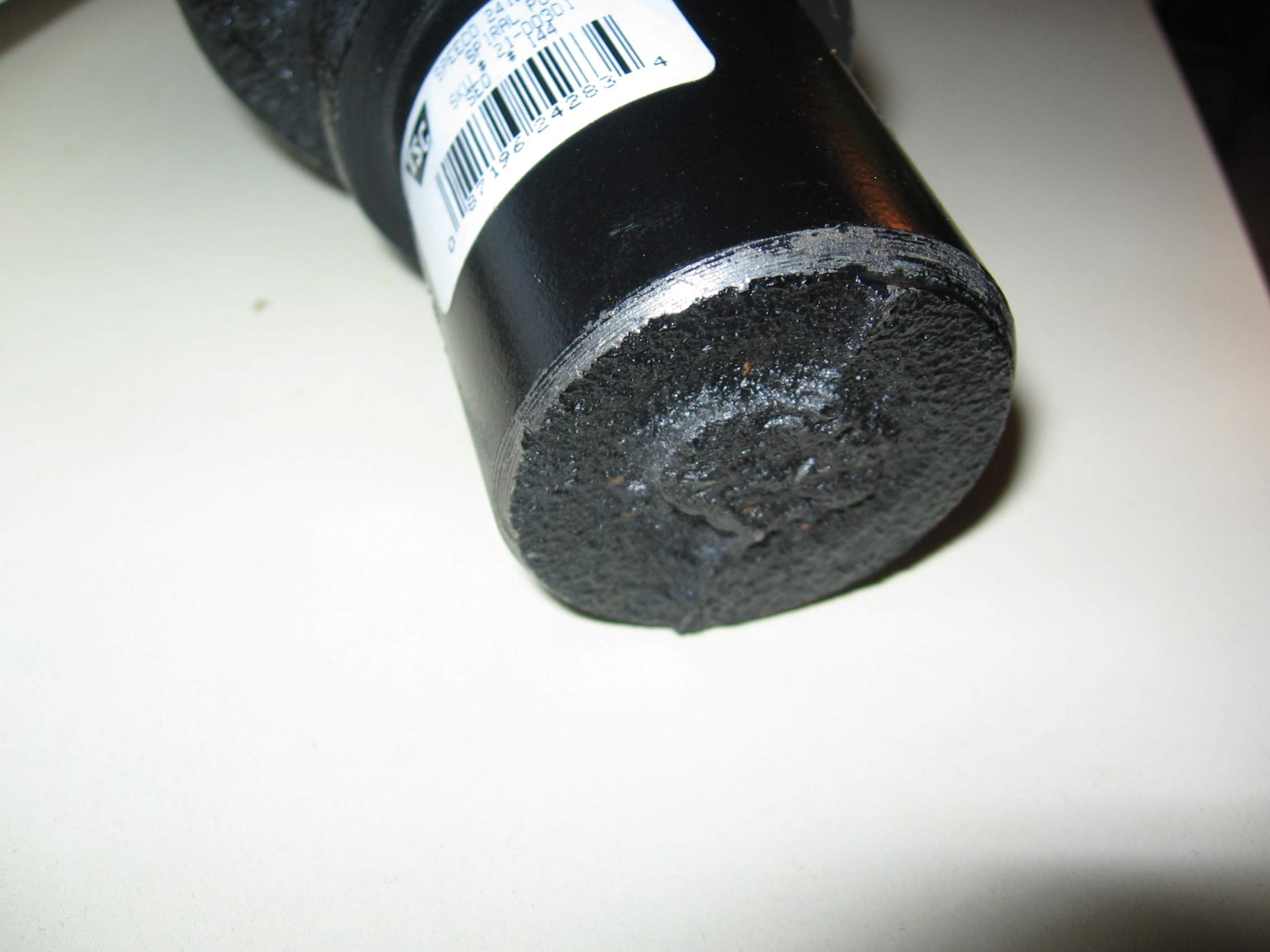

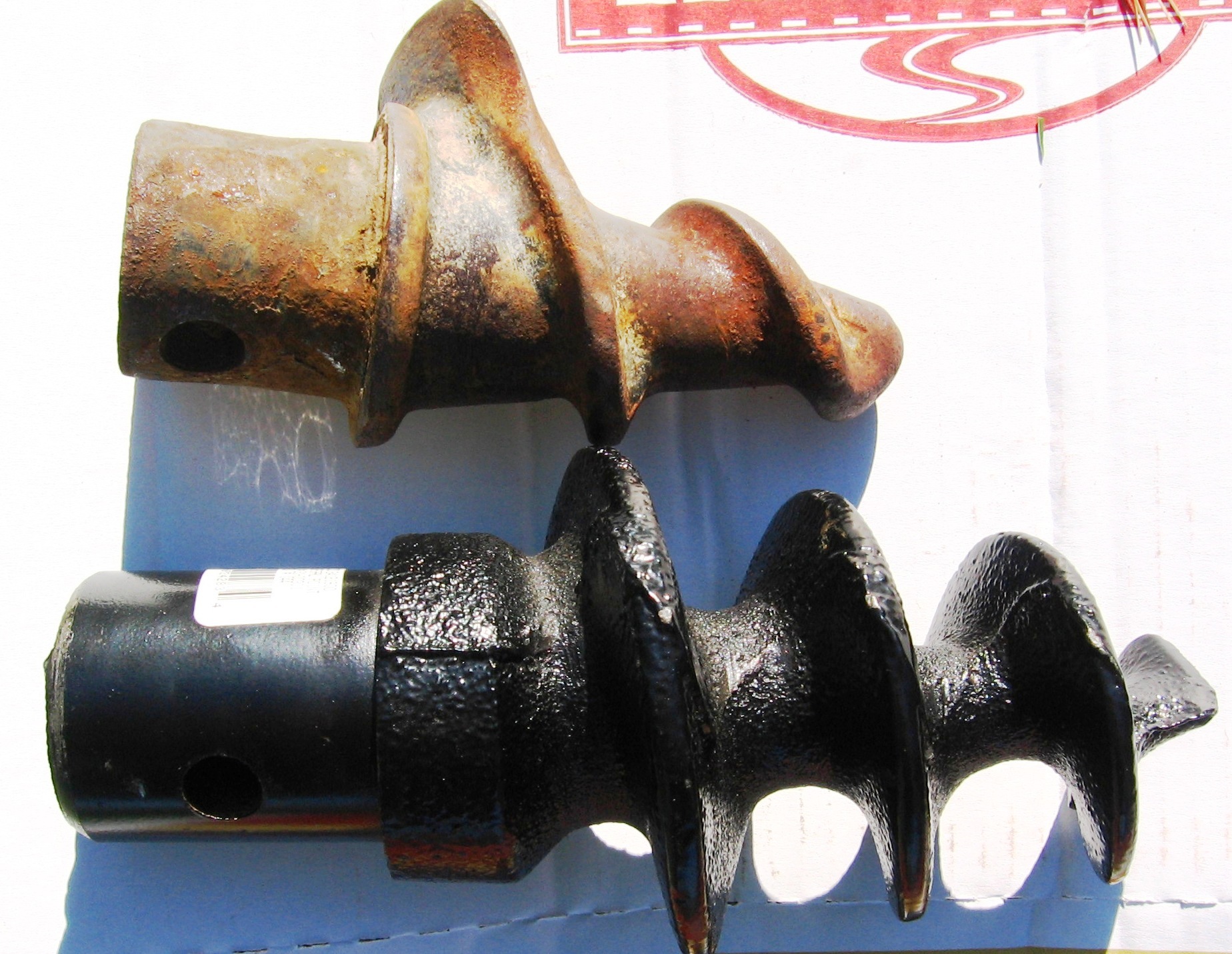

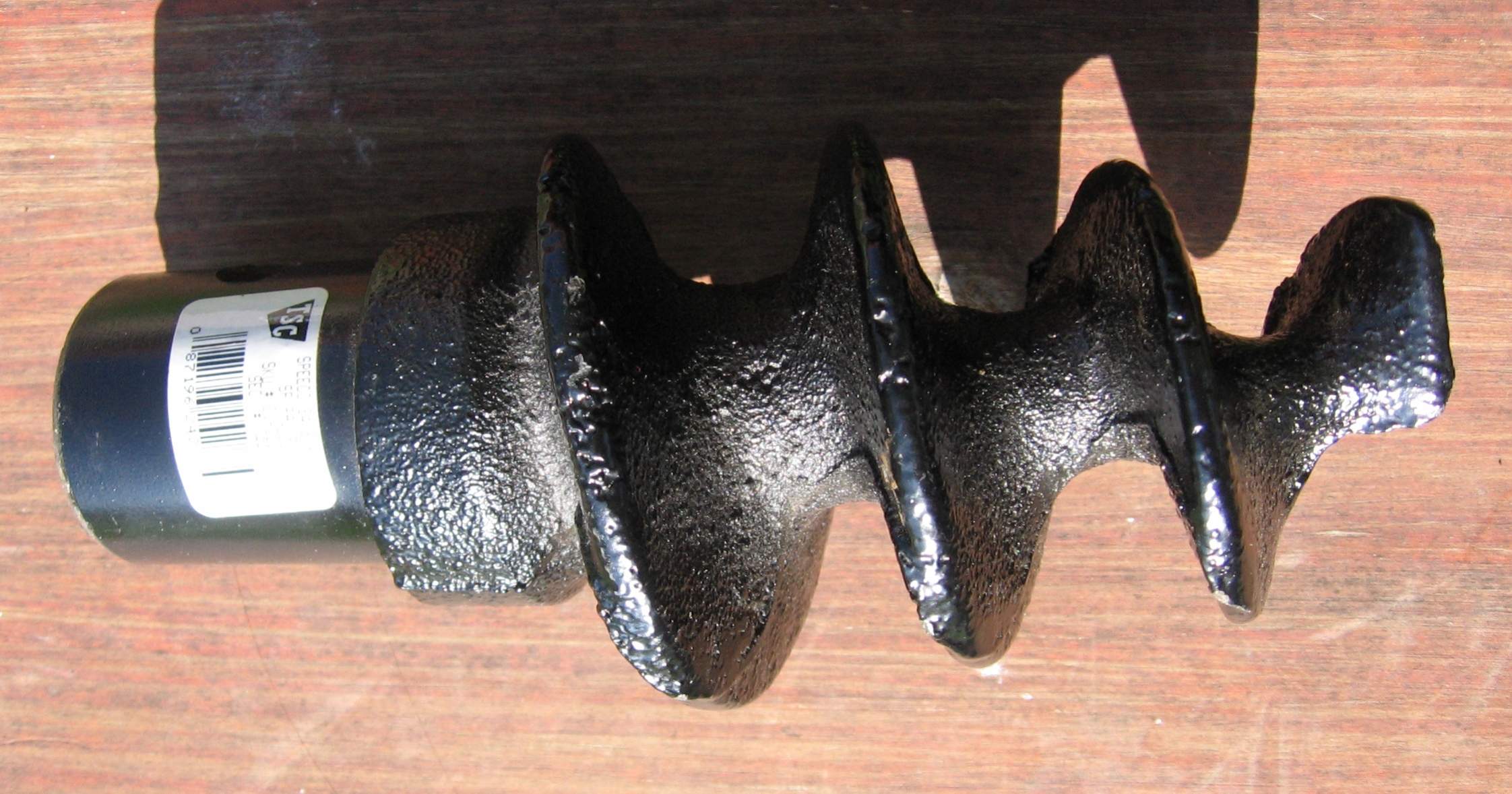

After looking high and low for a replacement point for a 12" auger I finally found what I thought to be a suitable fit. After returning home from TSC with the new unit, I was disappointed to find that the diameter of the non-business end of the point exceeds its receiver by about 1/8".
Three questions: 1. Would it be costly (or even possible) to take this to a machine shop and have it turned/shaved by 1/8"?
2. As seen in photo, the replacement point is longer than the original (although maybe not as I got the PHD used and the old point may have been equally as long as the new a while ago). Should I be concerned about the discrepancy in length?
3. Any alternative solutions?

Make sure the end of the tube isn't mushroomed inward. If that's the case a half round file might fix it.
It's crude but you may be able to grind the OD down to fit. I don't see an easy way to chuck it in a lathe.
   / auger point #3
That piece will easily chuck in a lathe, take it to a shop their standard 3 or 4 jaw chuck will expand and catch the ID of the work piece... How thick is the metal? Can a 1/16 be removed without it being too thin? If so it's an easy turn down... KennyV

I'd take the new one back & build up the old one with hardfacing welding rod. MikeD74T
That's a mighty nice offer Mike but it would be quite a trip for you from New Hampshire to Central NY.
All joking aside, I simply don't have that skill set ... yet.

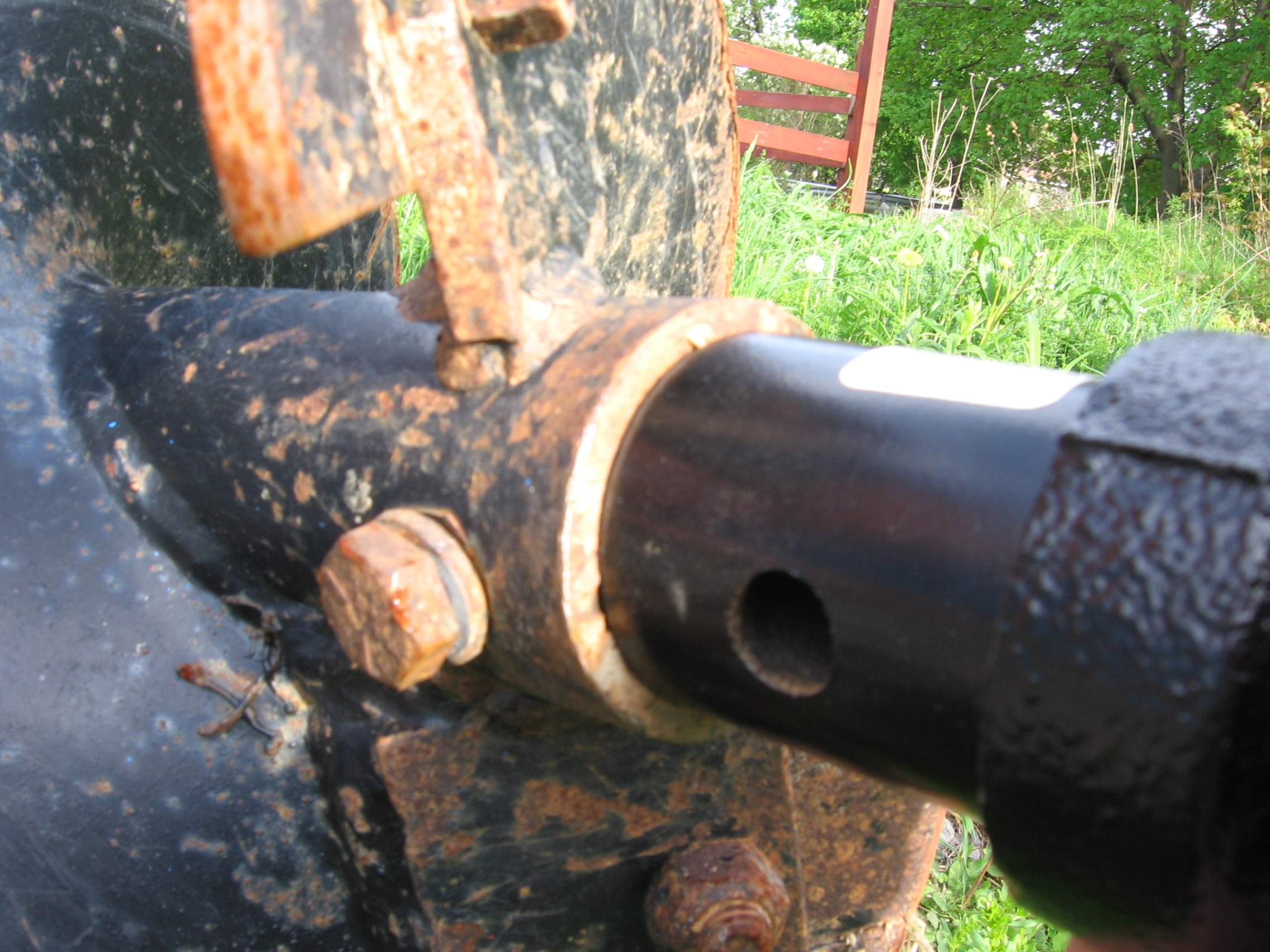

The ID of the female receiver = 1 7/8"
The metal is solid Kenny, as seen in photo. I take it that you think that as long as the lathe chuck can securely grasp the point, shaving 1/16" from the 2" diameter male (non-business) end of the point (facing us in the photo below) shouldn't be a problem and should slim the diameter of the bit down by a total of 1/8".
Comments?
