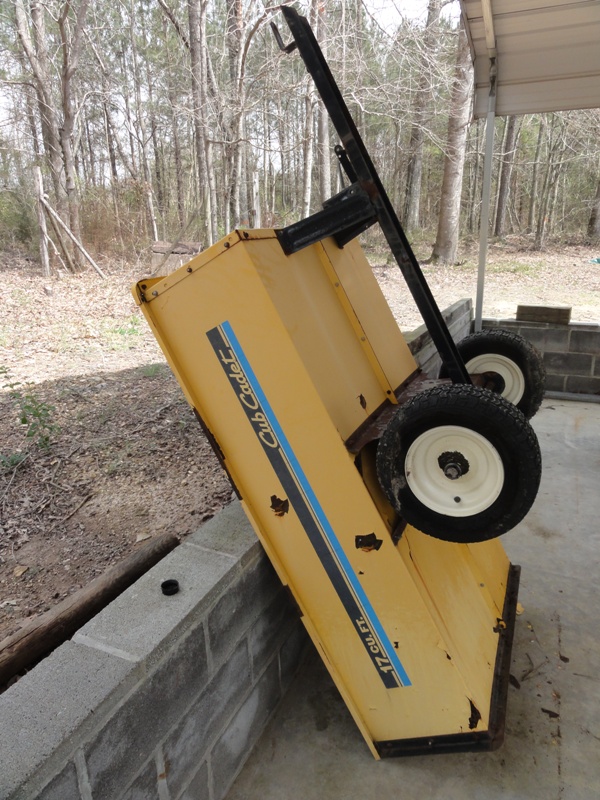

This is the bottom of a 17 cu/ft Cub Cadet cart that I am planning to restore soon.
All that paint is peeling and I will be able to get lots of it off.
I was planning to get the loose paint off, prime it and paint it.
My question is will the bed liner material stick straight to rust? Primer? Ospho rust treatment?
Do you think this stuff is better than paint considering dirt, rock and a shovel will be used to wear the bottom?

Cost will be the key factor. Everything not to be coated needs to be bordered with wire tape (to pull the edge) and then completely masked. You'll want a complete sand blast and some sort of a good phosphate wash then prime with a good etching or epoxy primer and paint.
Talk to your bed liner guy to see if he recommends primer only or what.
You may want to refinish and then drop a piece of 1/4" sheet poly (HDPE) in the floor. Anchor at the front edge only and let the sheet float.

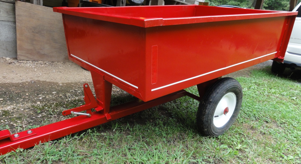

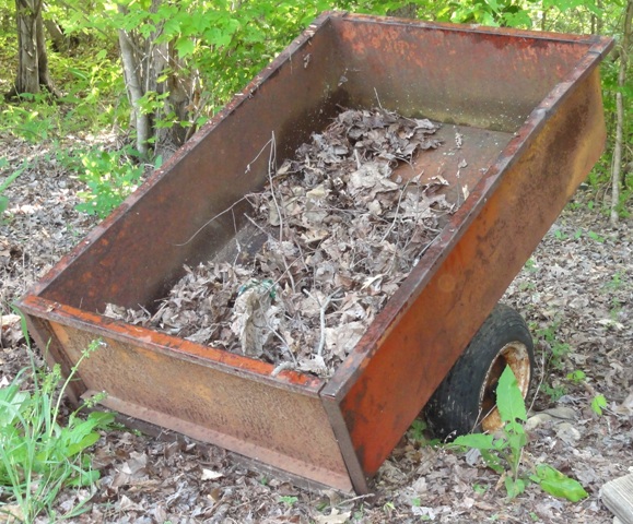

I suppose I am a cart nut as I have 3.
This is one that is over 30 years old that my deceased father-in-law used.
I restored it and have yet to haul one stick with it. It's in the barn now with dust on it. NOT for sale...
Before:
