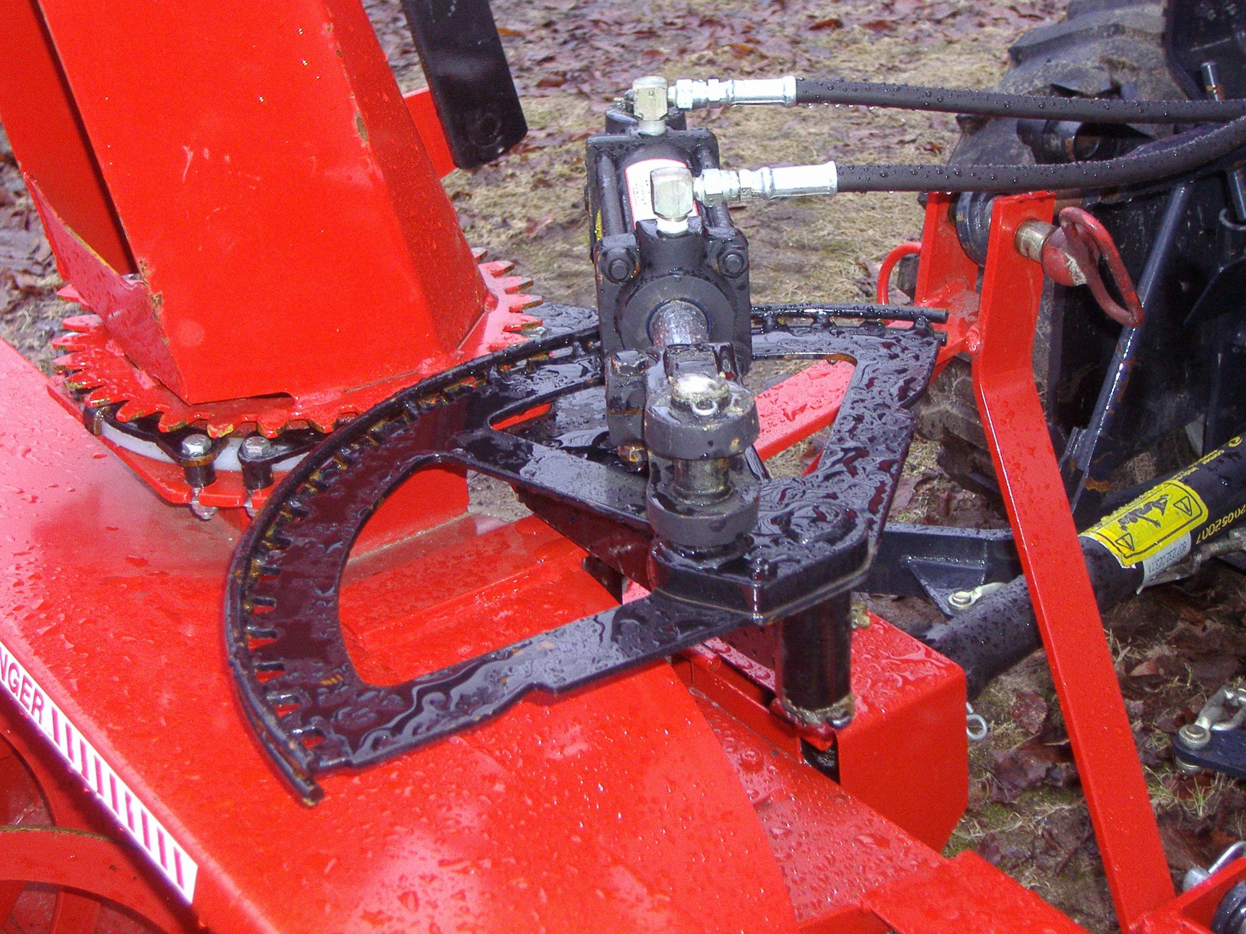

Well, I have been following all kinds of threads on automatic chute rotation and discharge and here is my plan. Since Massey wants about $800.00 for the kits I went to the local junkyard and pulled a window motor out of an old Buick $10.00. stopped at an electric salvage place and got a couple of on-off-on switches $2.00 for both, Ordered the connection bracket from Massey to mount the window motor $31.00 (lines up perfectly:D), ordered a 12V linear actuator with a 4" throw online with attachment bracket $87.00 (most expensive item:rolleyes:) and wire I got $00.00. ;) Lemme See.
Window Motor $10.00
Switches 2.00
Conn. Bkt. 31.00
Lin. Actuator 87.00
Wire Etc. 00.00
Total $130.00
Est. Savings $670.00
OOPS! I have to pick up a can of spray paint:eek: There goes another $5.00 out the window!

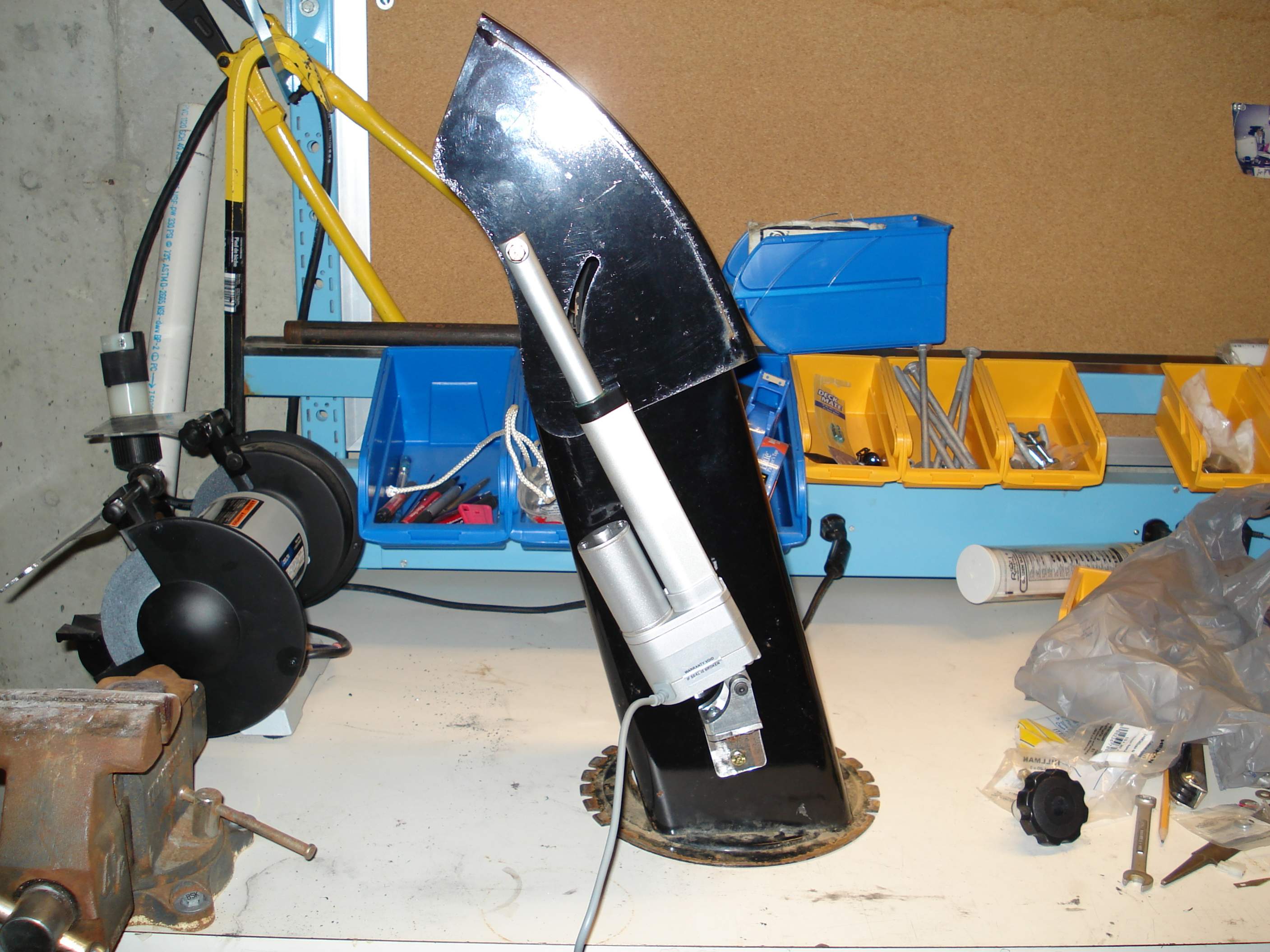

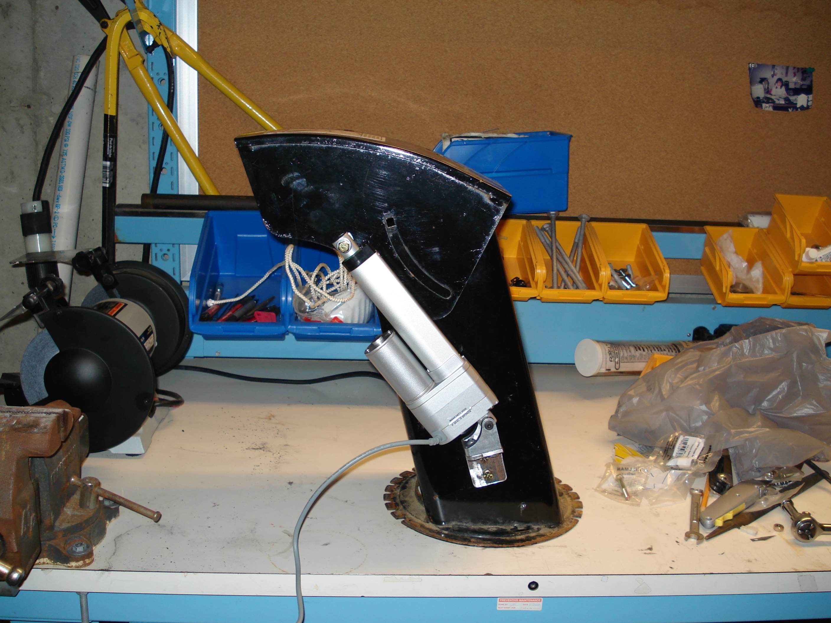

Well I got the chute sorted out today. Works great!

Any chance you could share the source and part number of that linear actuator?
   / Automatic Chute Rotation and Discharge (AGAIN)
Sure! "BURDEN SALES SURPLUS CENTER" IT HAS THE "3.93" STROKE PN 5-1577-4 WHICH TRANSITIONS INTO A FULL STROKE OF THE CHUTE DEFLECTOR. TOOK IT ALL APART TODAY SANDED AND REPAINTED THE CHUTE, NOW I CAN'T WAIT FOR NEXT WINTER!:D
That looks as good or better than the MF unit! Lots cheaper than what I paid as well. Congrats.

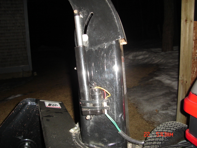

Come on, bobzap-- doncha miss those wire ties and the cute little colored wires hanging out??:D
Mine came with the MF set-up as a package.
I like yours better.
Sorry about the job, man--that's gotta be tough. Hope you find something soon.

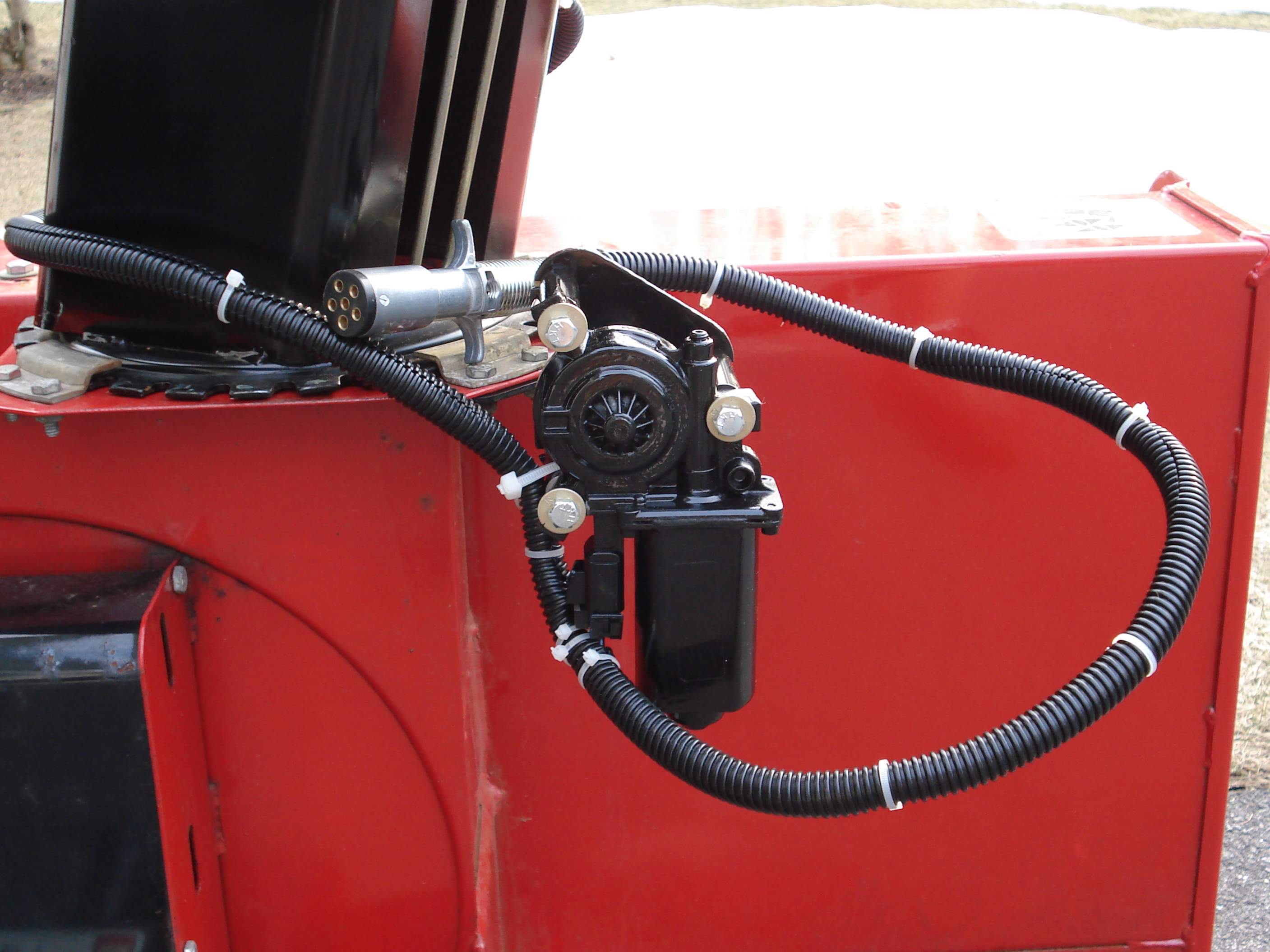

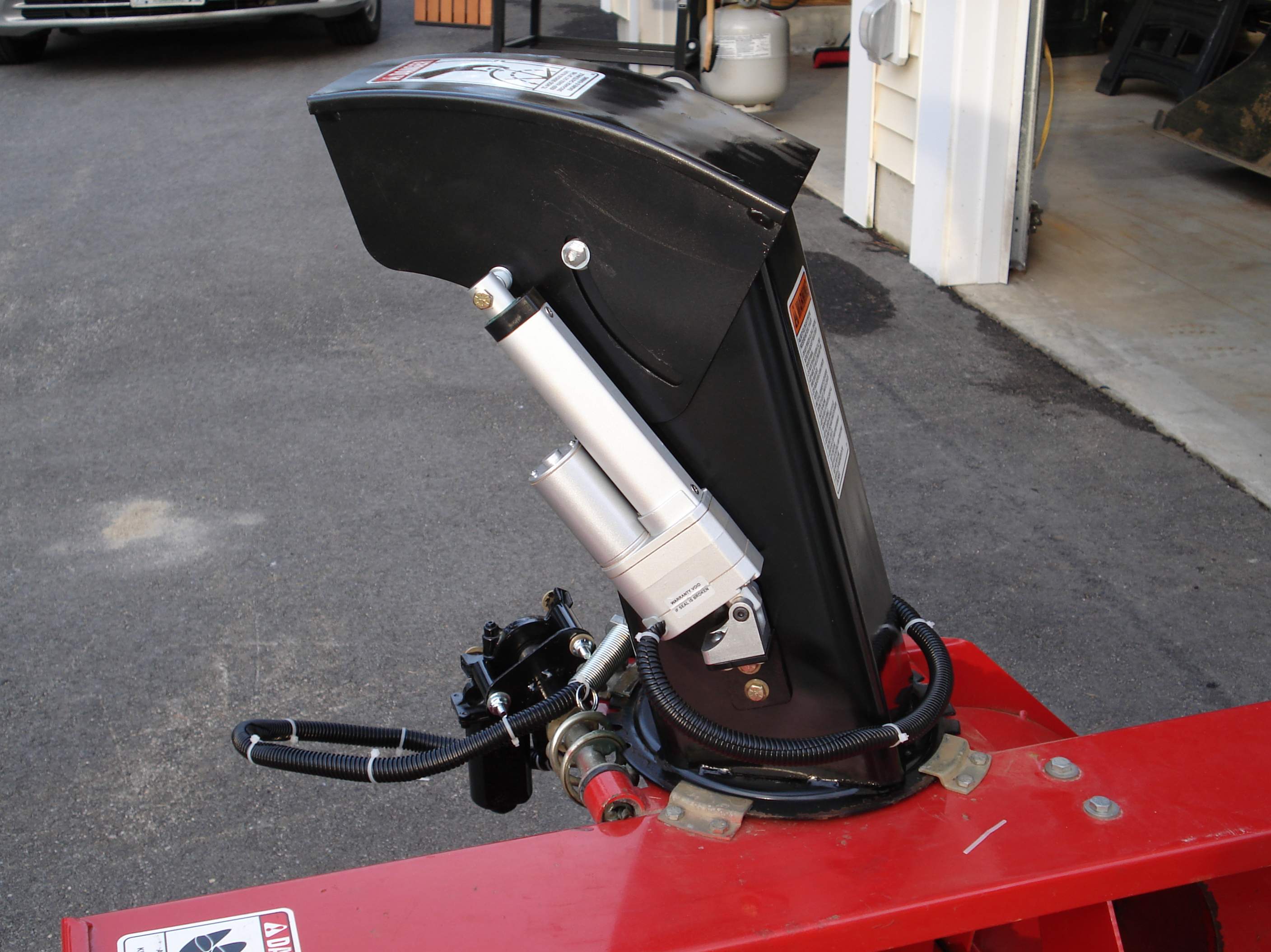

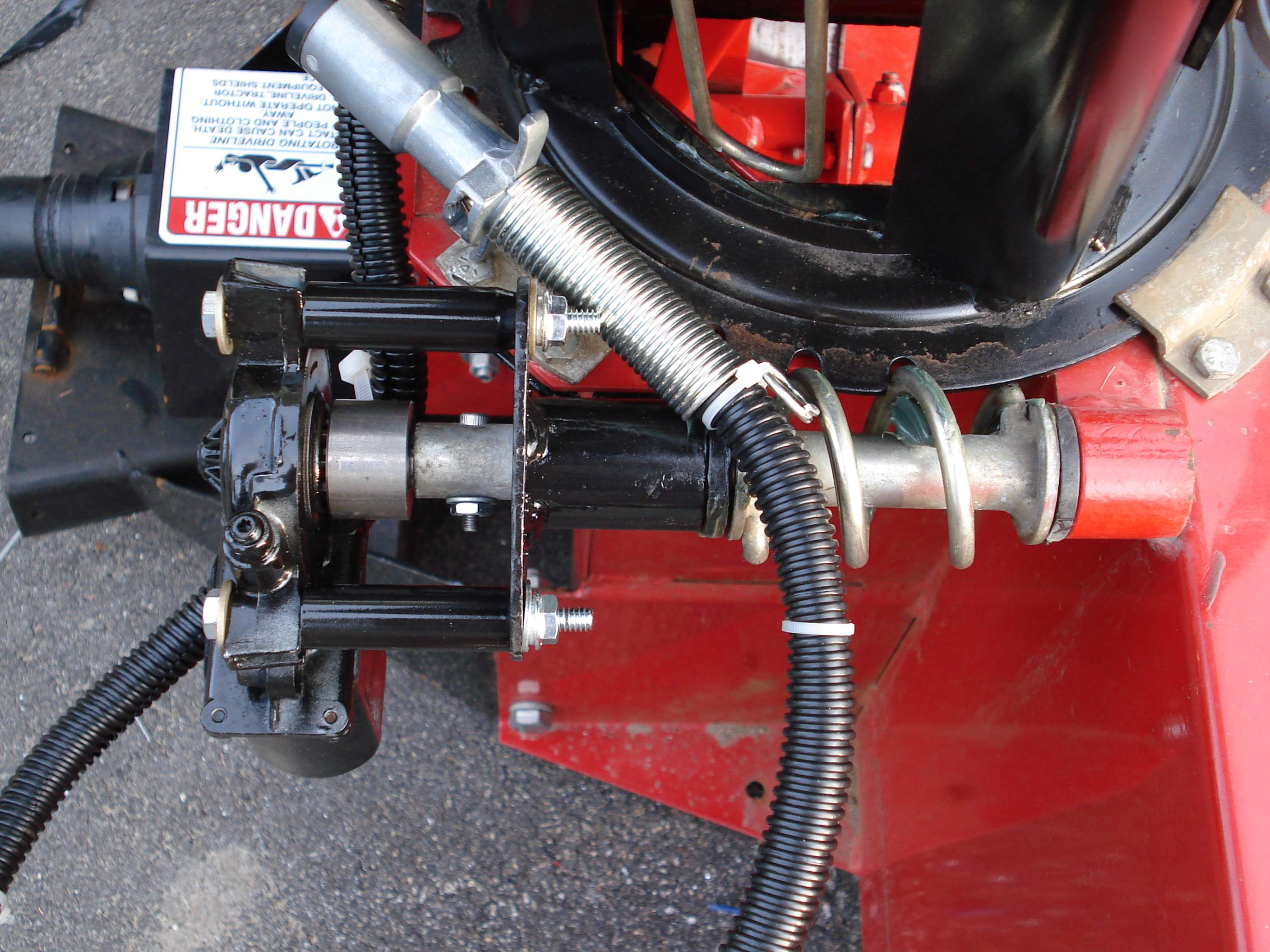

:DWell she's all done and kinda neat! my wife says I should put together kits and sell them.. I gotta get a job and get out of the house!

Very nicely done. Your wife is right, you should make kits. I really like your plug in. The knucklehead at the MF dealer hardwired the snowblower chute deflector wiring. Imagine my surprise when I went to take it off.
