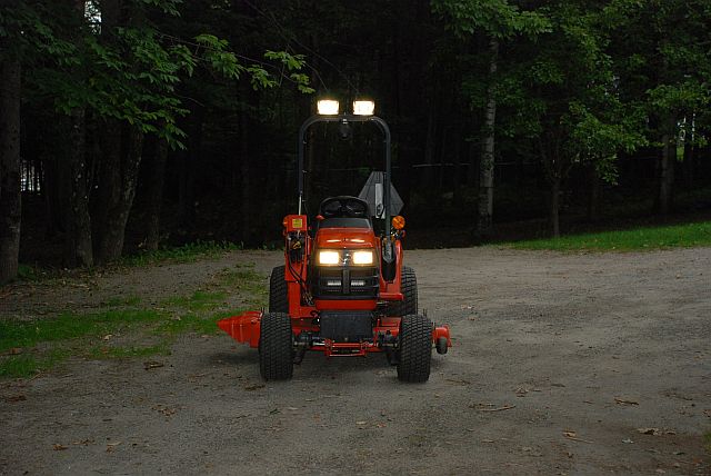

Also, I'm wanting to add lighting mounted to the underside of the ROPS bar. Anyone have pictures and what type of lights were used. With the lights being behind the operator, was there any concern with glare/seeing??
   / AUX Light Question Please advise #12
I have lights mounted on top of the ROPS, but initially tried them on the underside. My ROPS is fixed, so it's a little shorter than the folding version, but when I tried mounting the lights on the underside, the light was obstructed by the top part of my head.....and the lights blinded me when I turned from side to side. I get some glare with them mounted on top, but not nearly as bad. I just need to be more careful when I get in around tree branches with the lights on top. These are Hella 55w flood lights....pretty cheaply priced from any parts store. Dyer, retired

I just completed the alternator upgrade, with an awful lot of help from Shaun (Blackmagicwoman,) so I can run all my lights without worrying about taxing the battery. I turn on all the lights I have when I'm near the road during snow removal. Prior to the alternator upgrade I would run the battery down to the point that it wouldn't start the next morning, so I put the battery on a maintenance charger after each use....now I won't have to worry about doing that. If you decide to do the alternator upgrade, it can be done for about $180.00, which is just about $500.00 cheaper than what the dealer would charge for the kit, installation labor, pickup of the tractor and drop off, etc.
The lights were mounted by drilling down through the ROPS. I also have a flood light that hangs down behind my head that faces to the rear for back blade work. That light is mounted the same way. I installed the lights about 4 years before I discovered TBN and read all the threads regarding drilling ROPS bars, so I would probably go with one of the many other methods of mounting if I had to do it again. John
