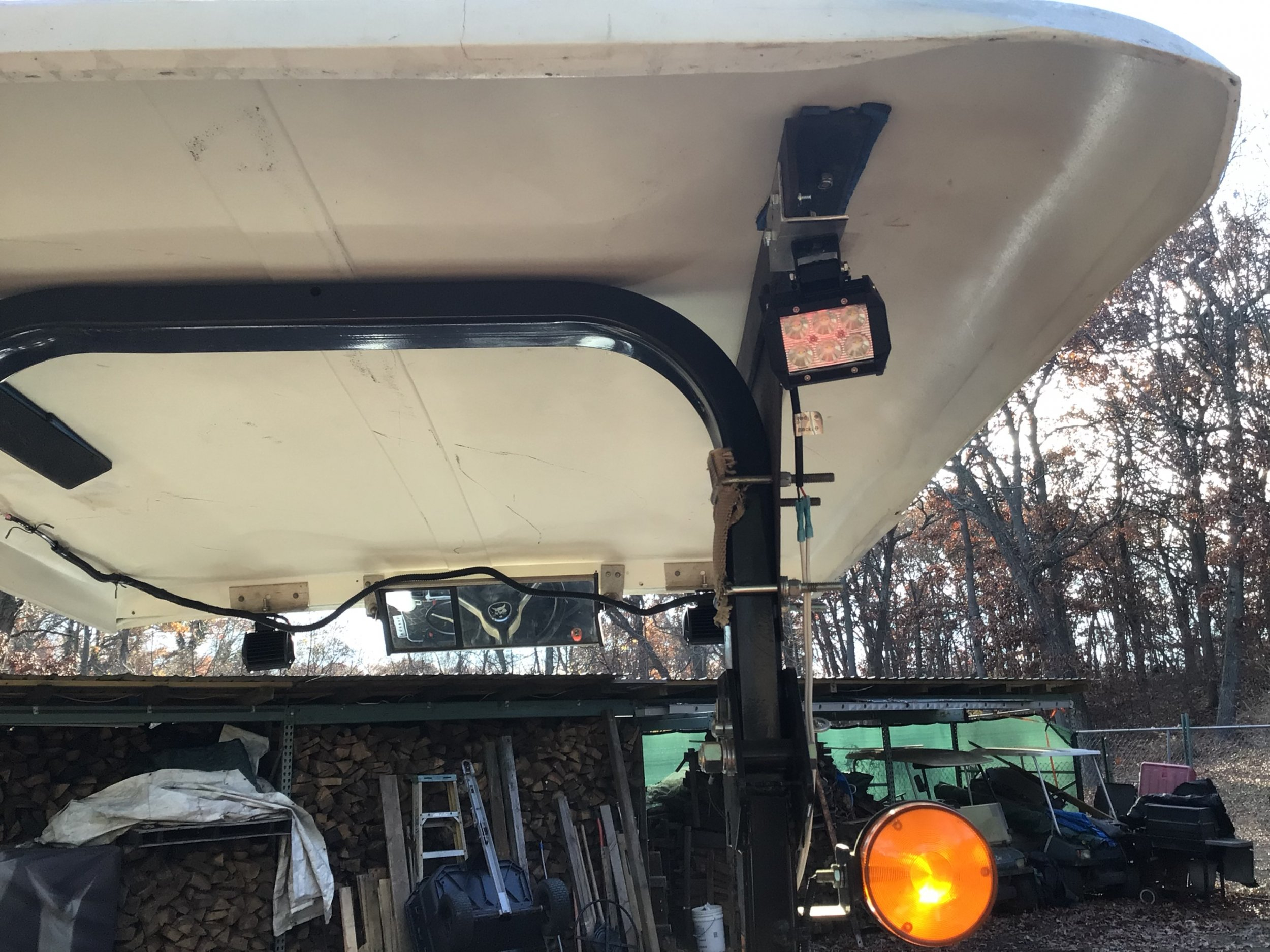

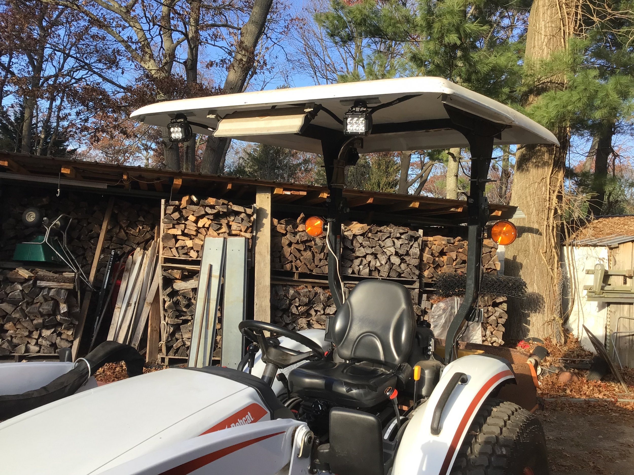

This thread got me thinking about needing more light for plowing in the winter. Ordered lights and wiring harness. Harness was way too short as sold. Needed an extra 13 ft. Of wire to go up Rops and forward to front of canopy (made from an old Jeep CJ hardtop that I cut up and repurposed).
Super bright floodlights.
Switch lights up blue when on.
Just stopped for today with more finishing to do but will take some picks when dark tonight.
Found a spot for a work light wired into tractor harness at bottom of right Rops so I added one.
Had bullet connectors so I got a light for that too! Haven't found a way to shut off work light on dash so till I do I just unplug a bullet connector.
I was gonna make my own harness but most wire for sale is copper clad aluminum and I want to solder everything up eventually (after this winter).
This company's harness was solid copper so I can solder it up in spring.

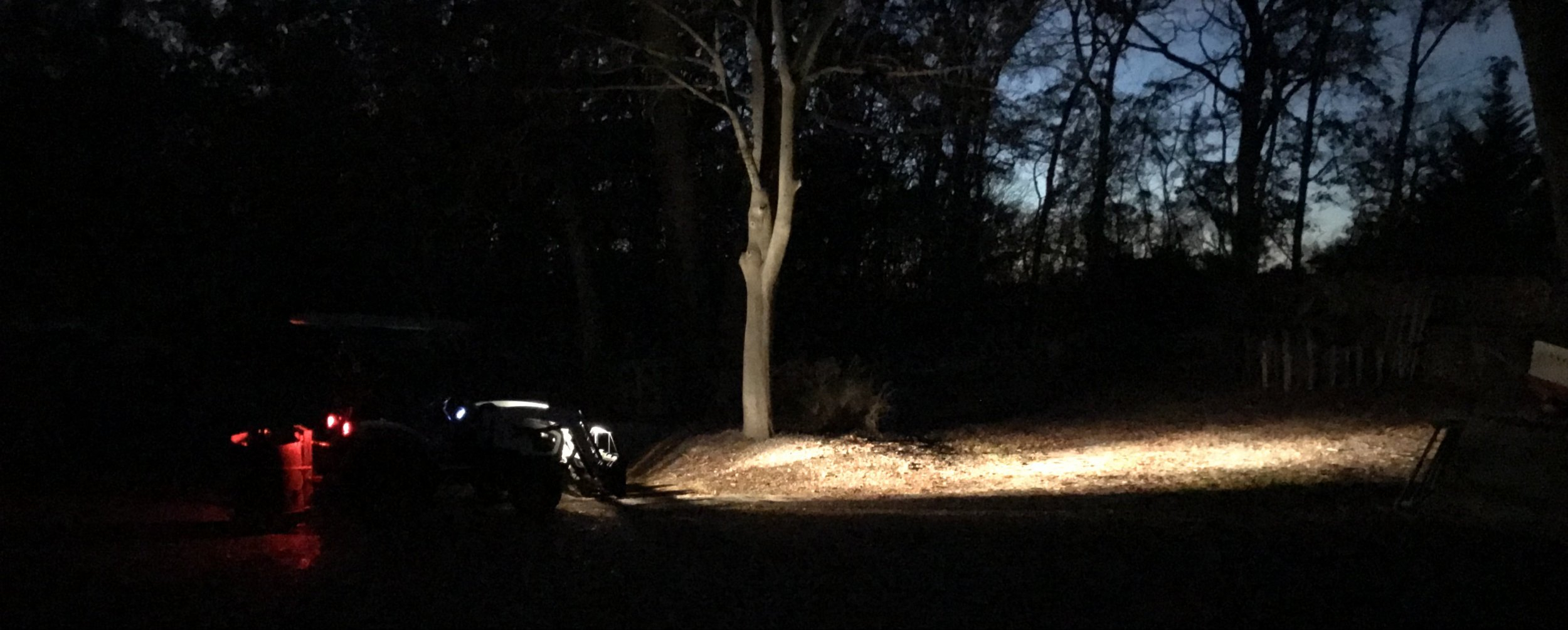

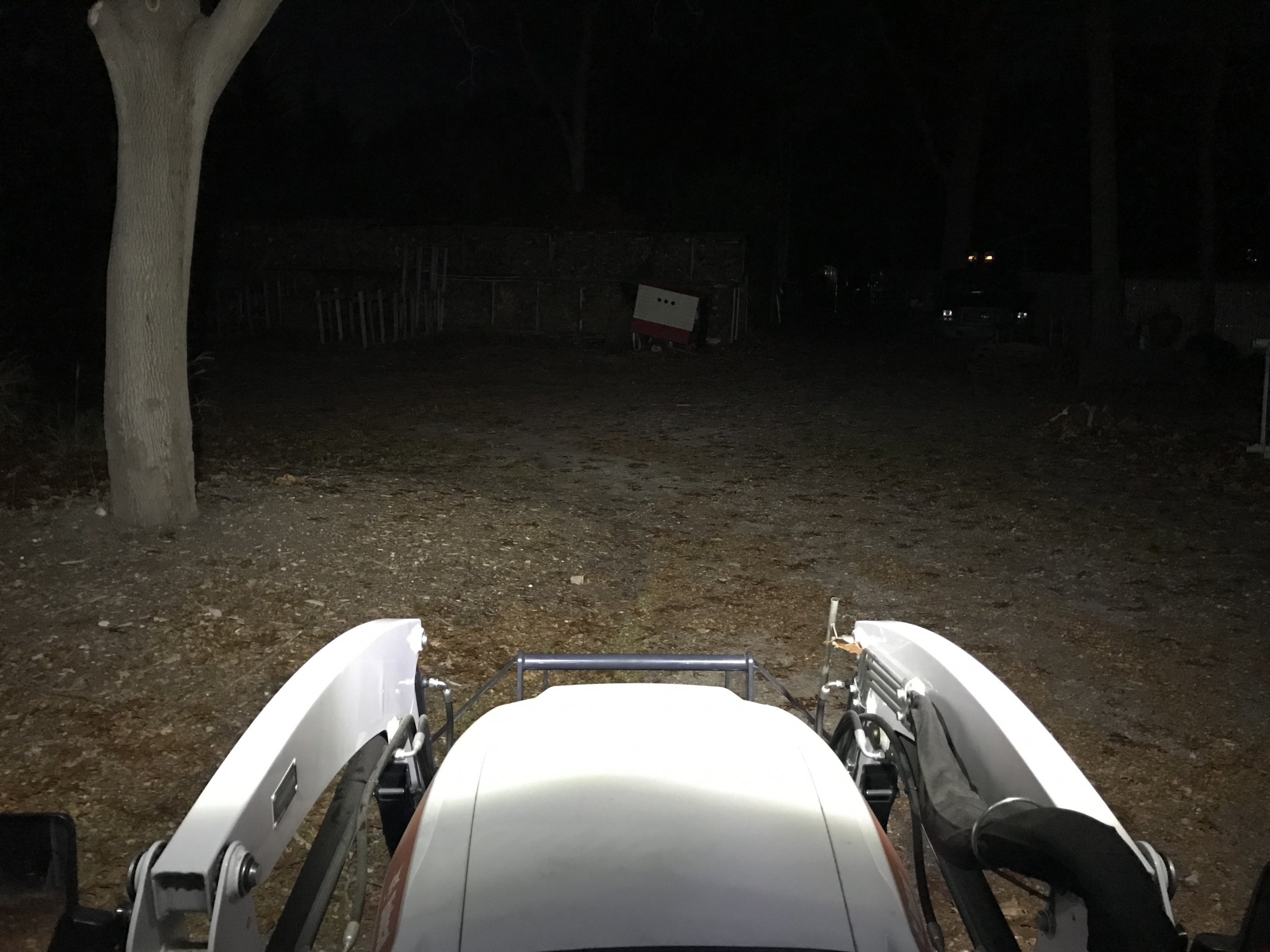

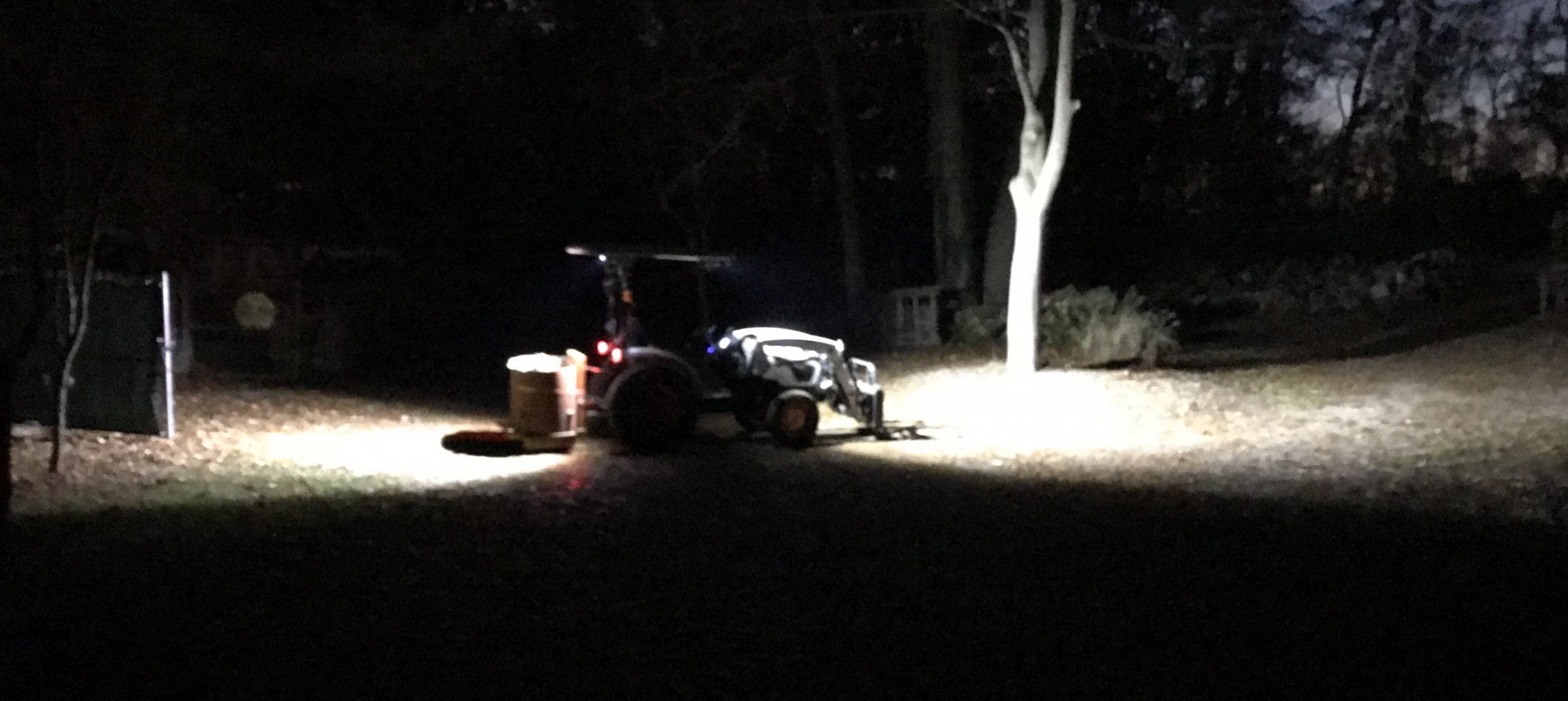

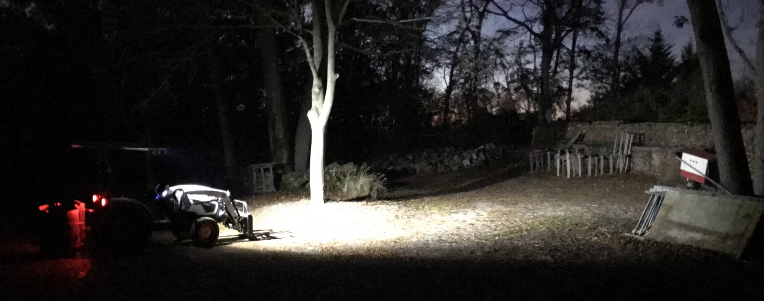

Ok went out and took some pics
First pic is tractors headlight then shut them off to check the led lights
Second is 2 leds to front
Third has rear work light on
Last 2 show viz from seat
you can see from the intensity of the light that I have them really angled down and they still light really far in front and rear. What a difference!
FYI the headlight switch does not control the work light. It comes on with the key switch and other lights off.
