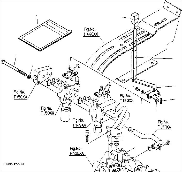

Gentlemen,
What all is required to add an aux. valve to a Kubota L5030. A customer of mine is buying a piece of equipment that demands auxiliary vavles and he has none on his Kubota. Is this a simple "bolt on" or is there more to it than that? Is there a hydraulic block that can be tapped into? Thanks for help in advanced.
   / Aux. Valve instillation ? #2
YOU CAN PUT UP TO THREE REMOTES ON THIS MACHINE. GO SEE THE SERVICE MANAGER AT YOUR LOCAL KUBOTA DEALER. IT IS A WHOLEGOODS KIT AND ALL PARTS ARE INCLUDED. IT WILL FIT AND WORK BETTER THAN TRYING TO "TAP IN" AND THE RELIEF VALVES ON THE TRACTOR HYDRAULICS WILL PROTECT THE TRACTOR FROM PUMP DAMAGE.
   / Aux. Valve instillation ? #3
This is for a L3130, but I'm sure they are set up the same.
   / Aux. Valve instillation ? #4
Part numbers and installation for the remotes for all Grand L series Kubotas are the same. You will probably have to remove the wheel to make it easier.

   / Aux. Valve instillation ? #10
MSRP for the Grand L valves is just over $1400 for all 3 spools. That breaks down to just over $600 for the first and a little over $400 for each additional spool. Add another $50 per spool to add float. These are the factory stackable valves with lever assemblies beside the seat.
