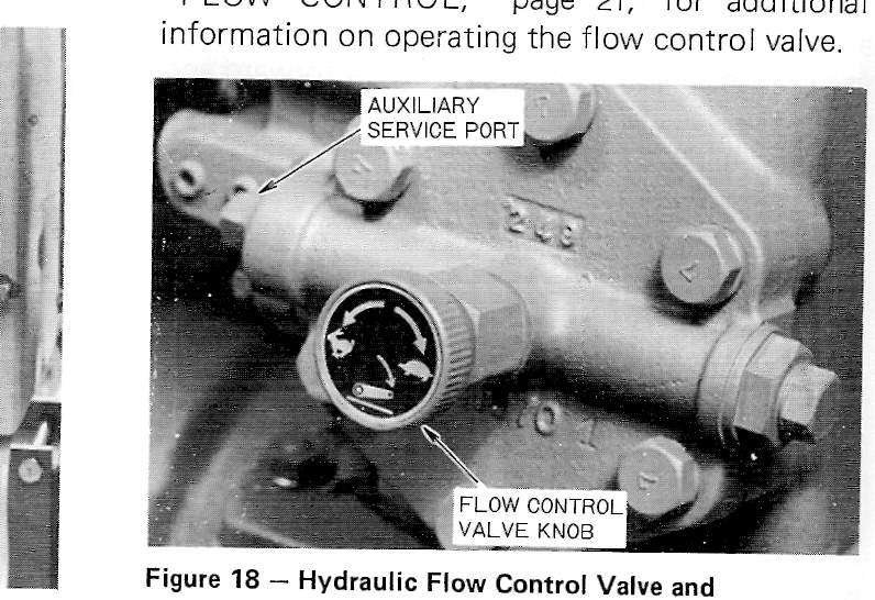

   / Auxiliary Port
OK, this is exactly the same setup I am going to try, only I can't tell where he plumbed in his return. I think the square head plug right in the center of the picture is where you would return the fluid back to the case. And I don't understand why you say the flow stops. This is not a test port, the manual describes it as an "auxiliary port for rear cylinders and motors". Has anyone else had any experience with this?
   / Auxiliary Port #9
Yes , you can use that square plug as return path to the diffy. I have taken that off and it does open to the diffy. Where the aux hose is connected is downstream of the spool. When spool goes to neutral all flow should by-pass thru the spool back to diffy bypassing that point. I hope I'm wrong as that would be an excellent connection point to plumb up a very simple PB port. It might work with one way cylinder. I'll be interested to see how it'll work as I said I have not personally tested that port. Why don't ya post a picture of what you have. On my manual that plug is clearly shown as a pressure test port.
JC,
   / Auxiliary Port
I have attached an image of what my manual shows.
