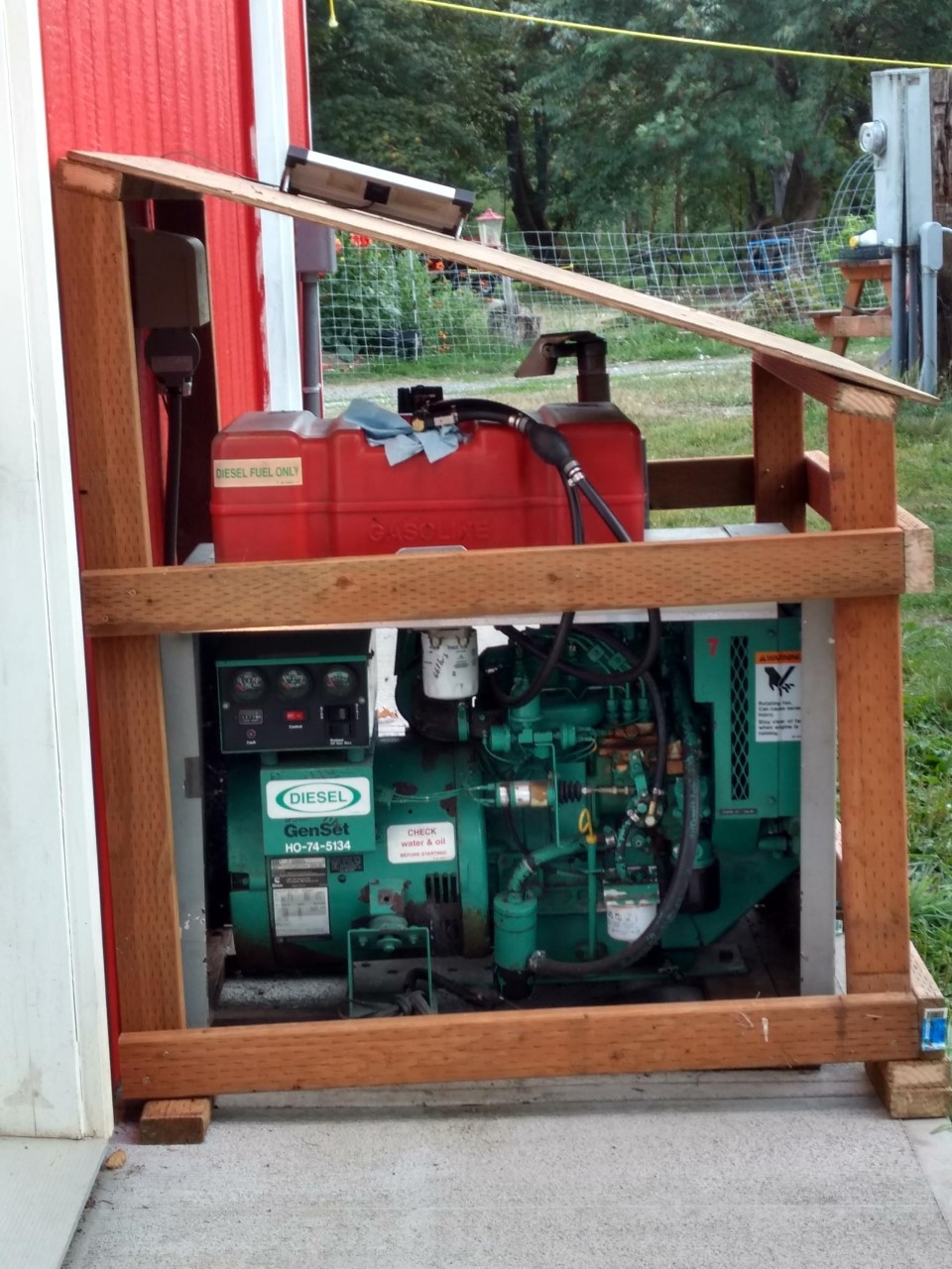

I'd mount the aux fuel tank at the same level as the installed fuel tank and tee into the supply line. That way the aux tank draws down along with the main tank. You're just effectively increasing the size of the main tank.

You can do it with a tee as long as you keep the tanks above the engine. Add a tee, and a check valve for each tank so they don't back feed each other. It will use the fuel out of the tank that is the highest due to gravity pressure. When the fuel in the 2 tanks reach the same level, it will draw from both tanks. Then back to the lowest tank when the first tank is dry. Get a tank with the hose barb at the bottom because it won't suck from the top.
You probably need to make a stand for the second tank. I see generators that are dead all over, maybe able to find one with a good tank to sit next to it.
My ZT has 2 side tanks with the same check valve setup.
Check valves. Check your hose size, most likely 5/16"
https://www.amazon.com/Return-Check...l+check+valve&qid=1559755546&s=gateway&sr=8-4
If you have any issues, you can add a fuel pump, but shouldn't need it if you keep the tank higher. Most mower engines use the side mounted pump that is piped to the crankcase. They use the crankcase pressure changes to run the diaphragm pump. Can add if you have an issue.

Lots of people, including me, did it for their camp generators. Teeing into the line doesn稚 pan out as good as feeding to the cap.

I understand this works well with these Honda generators cause they have a fuel pump. My Onan does not

Since your generator has the Low Oil Shut Down Switch, you might get away with a larger tank, I think your execution with the second tank needs a little revision.
I would say no to the siphoning of gas without seeing the generator, IF you use the OEM Tank and the Aux Tank above, the gas will siphon into the OEM Tank but as I said before you need a Liquid Tight Cap on the OEM Tank !
AGAIN, my worries are the low oil, and gas overflowing... fire !

Post pictures of what you have, where you are going... could be interesting for future reference.

Ive been looking for a throttle but didnt get serious about it till you posted, I hate the fact my generator is just screaming when I start it, I found it and have turned it down to an RPM that I consider more appropriate for the longevity of the machine, I dont know how that is gonna affect power output and may not know until I try it.
I have a second Onan Generator that is much older, it has a throttle lever ( versus the difficult to locate setscrew Ive located on this newer one ) so Im guessing it dosent have to be set at full blast all the time.

Im prob gonna try this, I need to find how how much fuel Im consuming since now Ive throttled it down, I bet it wont use nearly as much gas.
