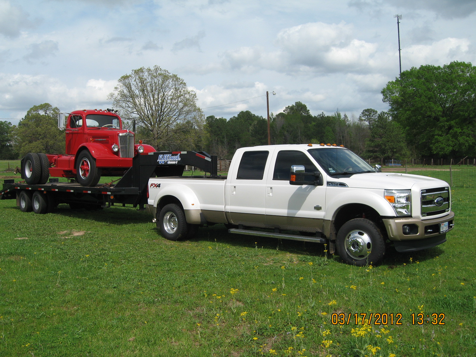

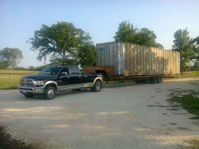

The F-450 pickup is only available as a diesel 4x4 crewcab dually. Only gear ratio is a 4.30 and combined with 400 hp and 800 ft/lb torque it definately is a master tow vehicle. Fuel mileage is decent, have gotten as high as 17 mpg non-towing interstate driving. It also has a wide-track front axle that gives a very short turning radius. No major engine problems that I'm aware of.
