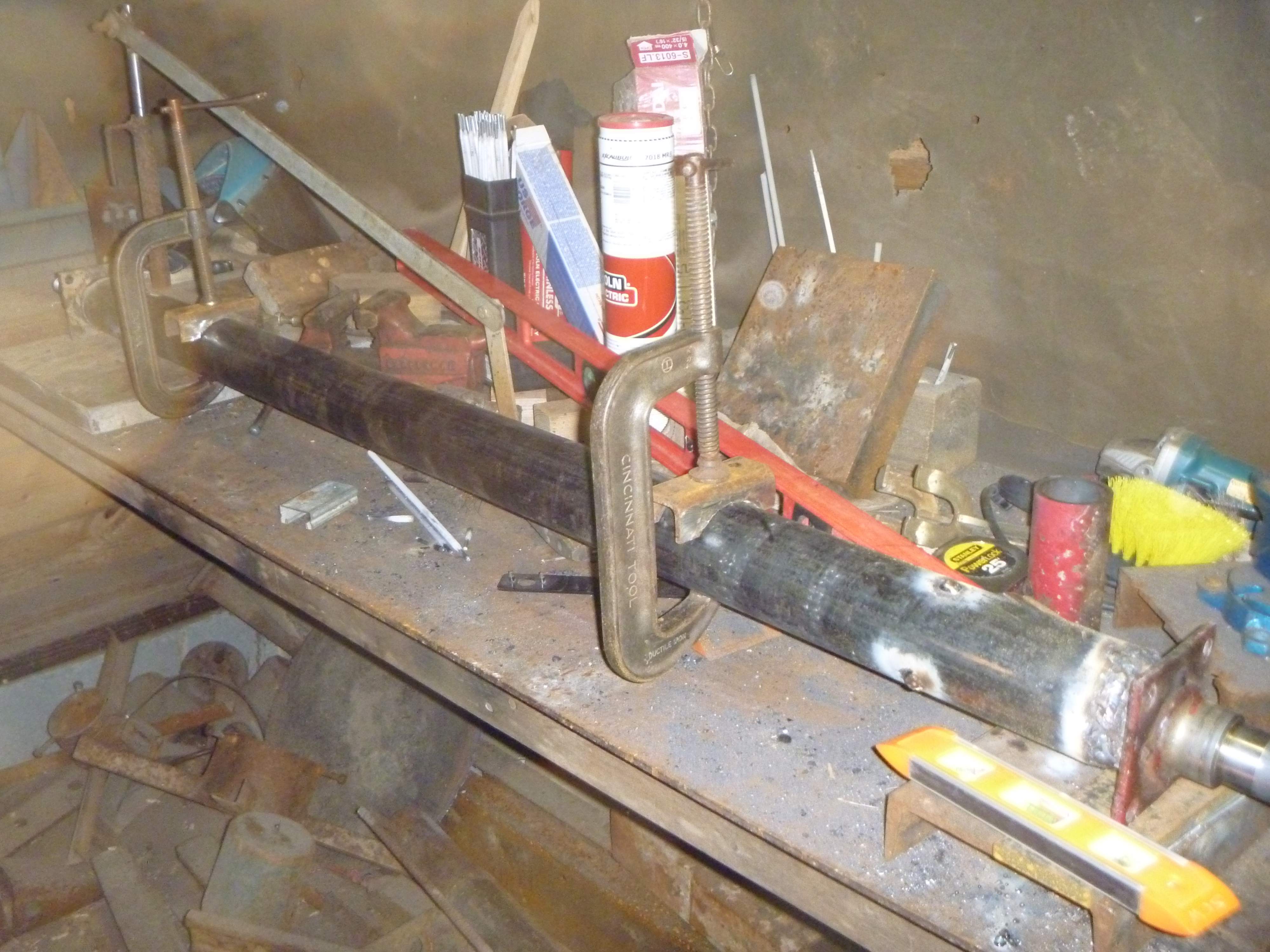

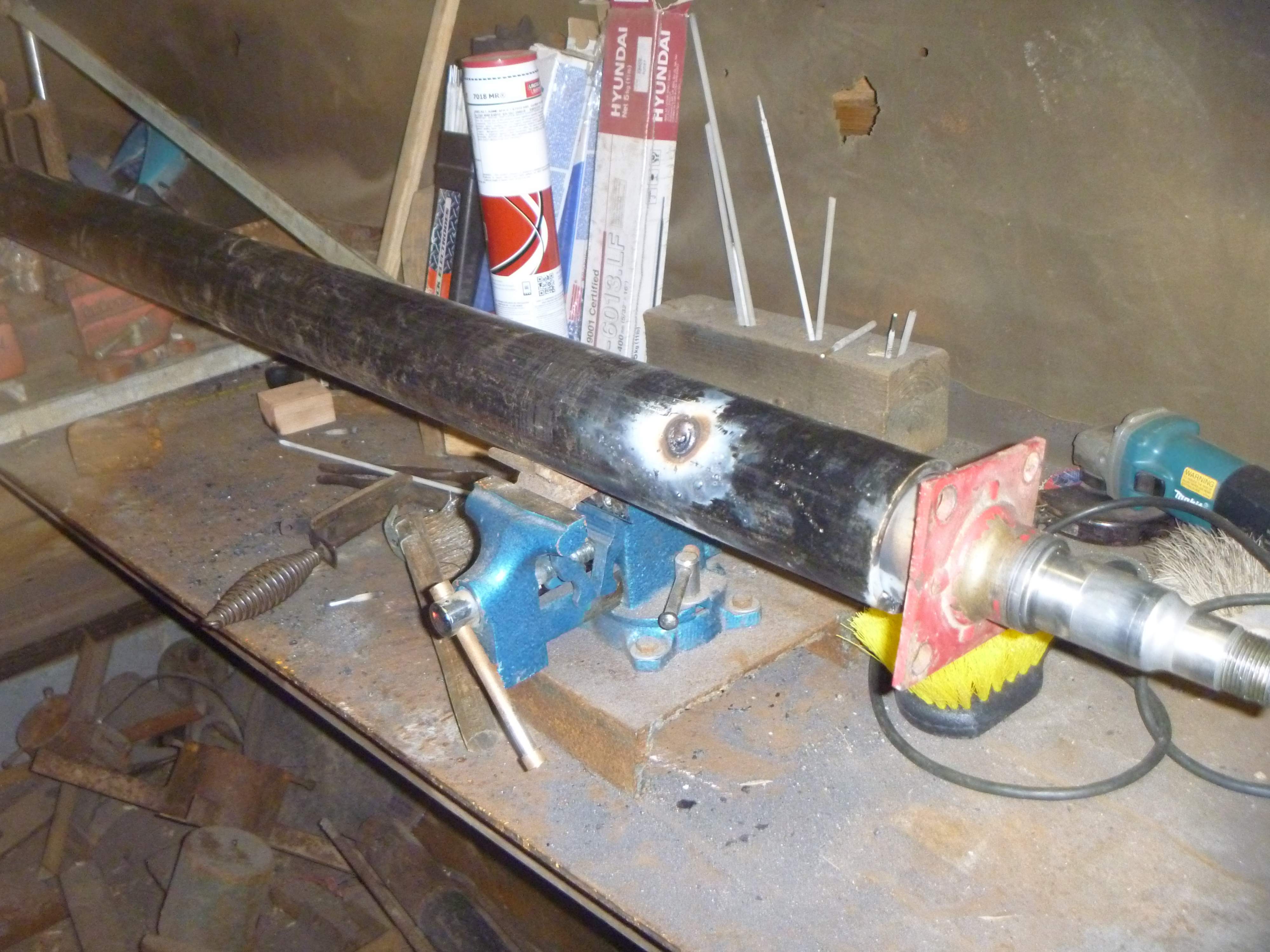

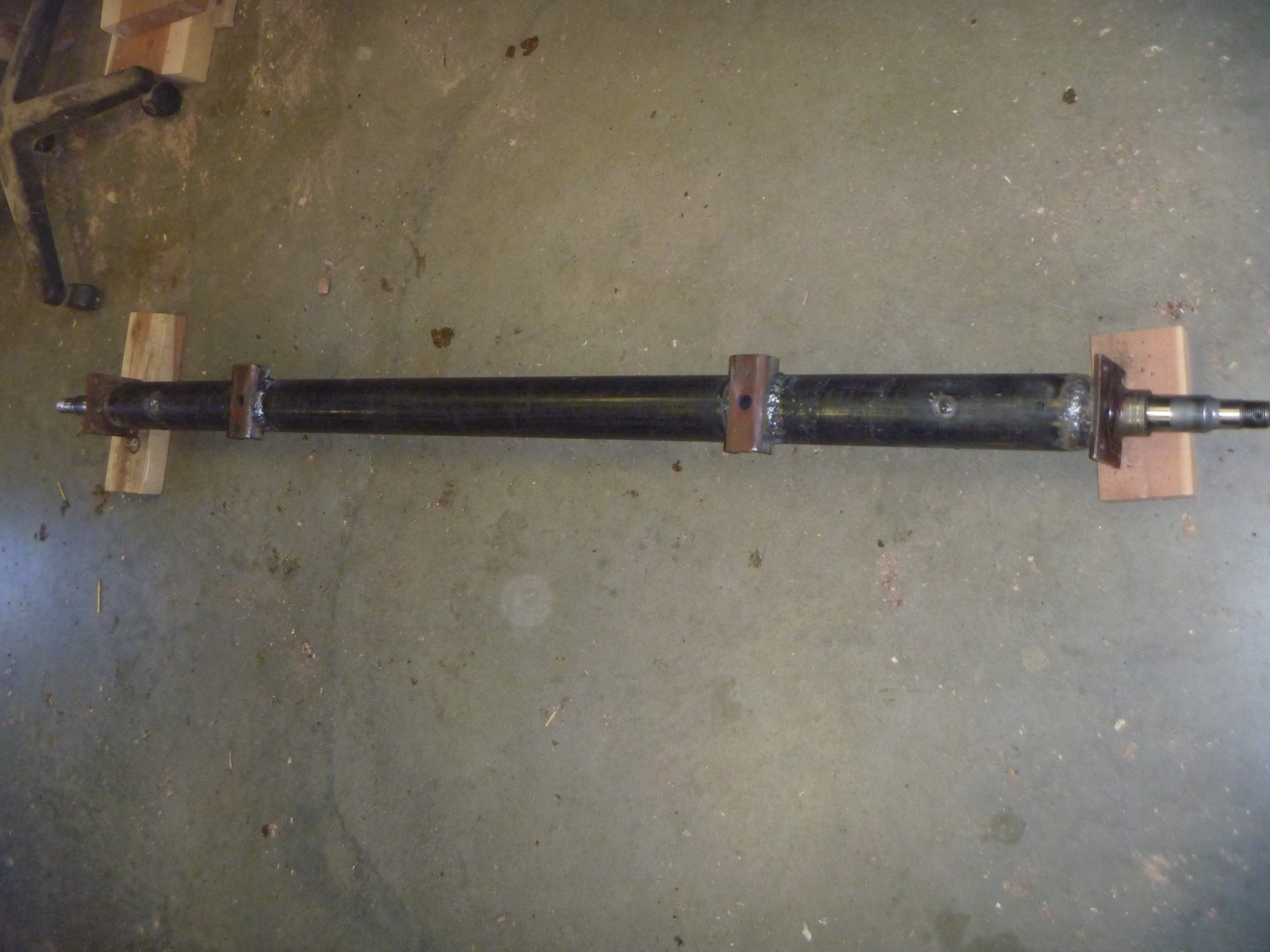

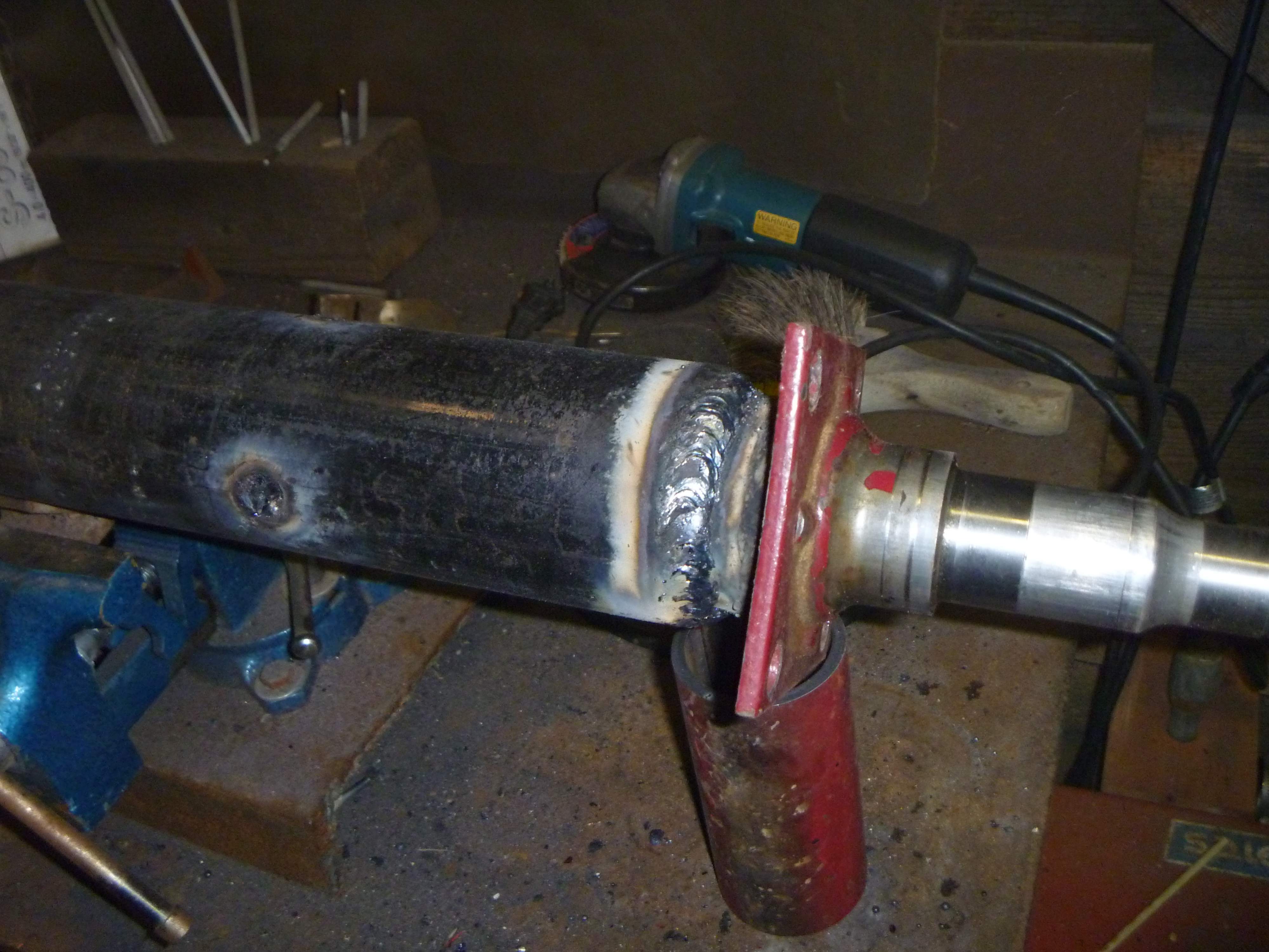

I pretty much followed my plan in post #11. Today I got the pipe back from the machine shop where they bored out the OD to receive the old axle (cut off to 6" long). I drilled suitably places holes for plug welding, inserted the axle/spindle assembly into the sch 80 pipe, plug welded and welded around the end of the pipe. Then I placed, leveled and welded the spring seats. Electrodes were E6011 and 7018 both 5/32". Went pretty fast. See pics.
I made pretty careful measurements to assure my torque wrench would still fit over the brake mounting flange nut with the larger diameter pipe.
Tomorrow I fish the brake wires thru the axle, put the brakes and drums on and hang the axle under the sawmill and mount the wheels. :cool2:

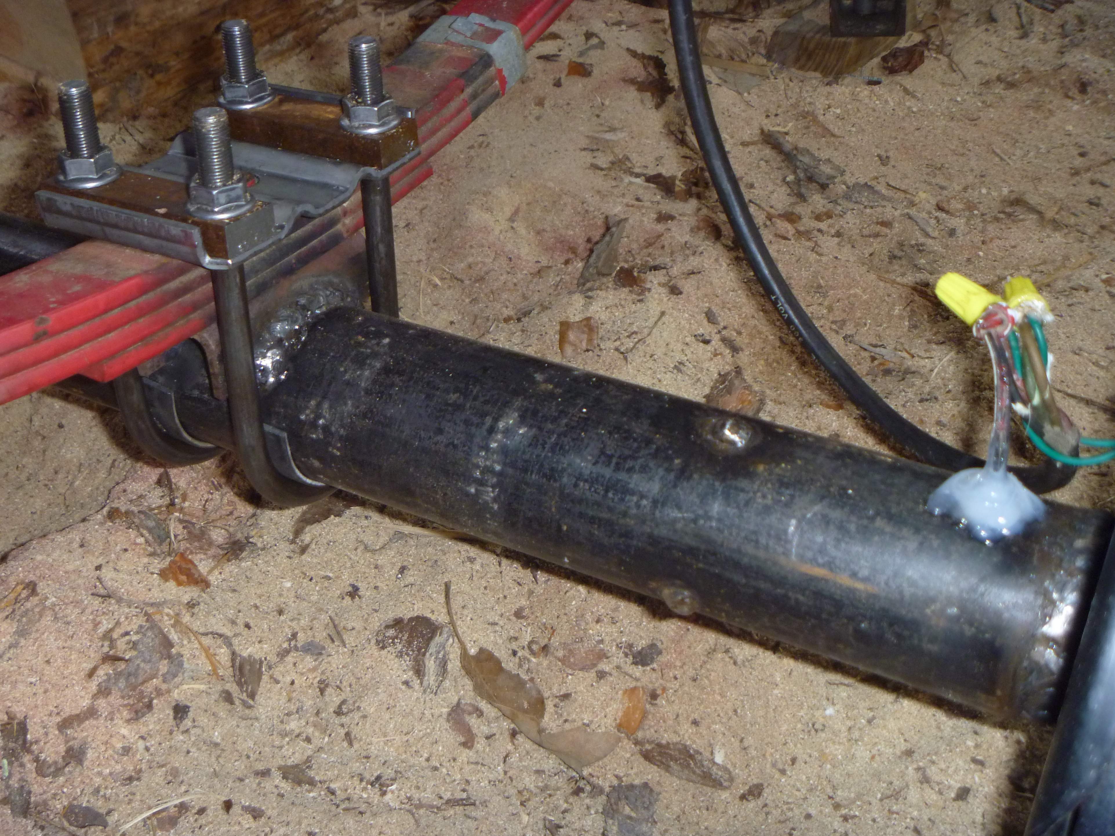

The axle is installed. The Ubolts are for a 3" axle and the sch 80 pipe I used is 2.9" so I inserted a u shaped shim around the Ubolt to take up the gap. Don't know if that was necessary but it was easy to do. Also the threads on the Ubolt were not long enough so I added a 1/2" bar on top of the plate. See pic. Its torqued down to ~60 ft-lbs and ready for wheels to go back on. All-in-all it was a pretty straightforward project.
