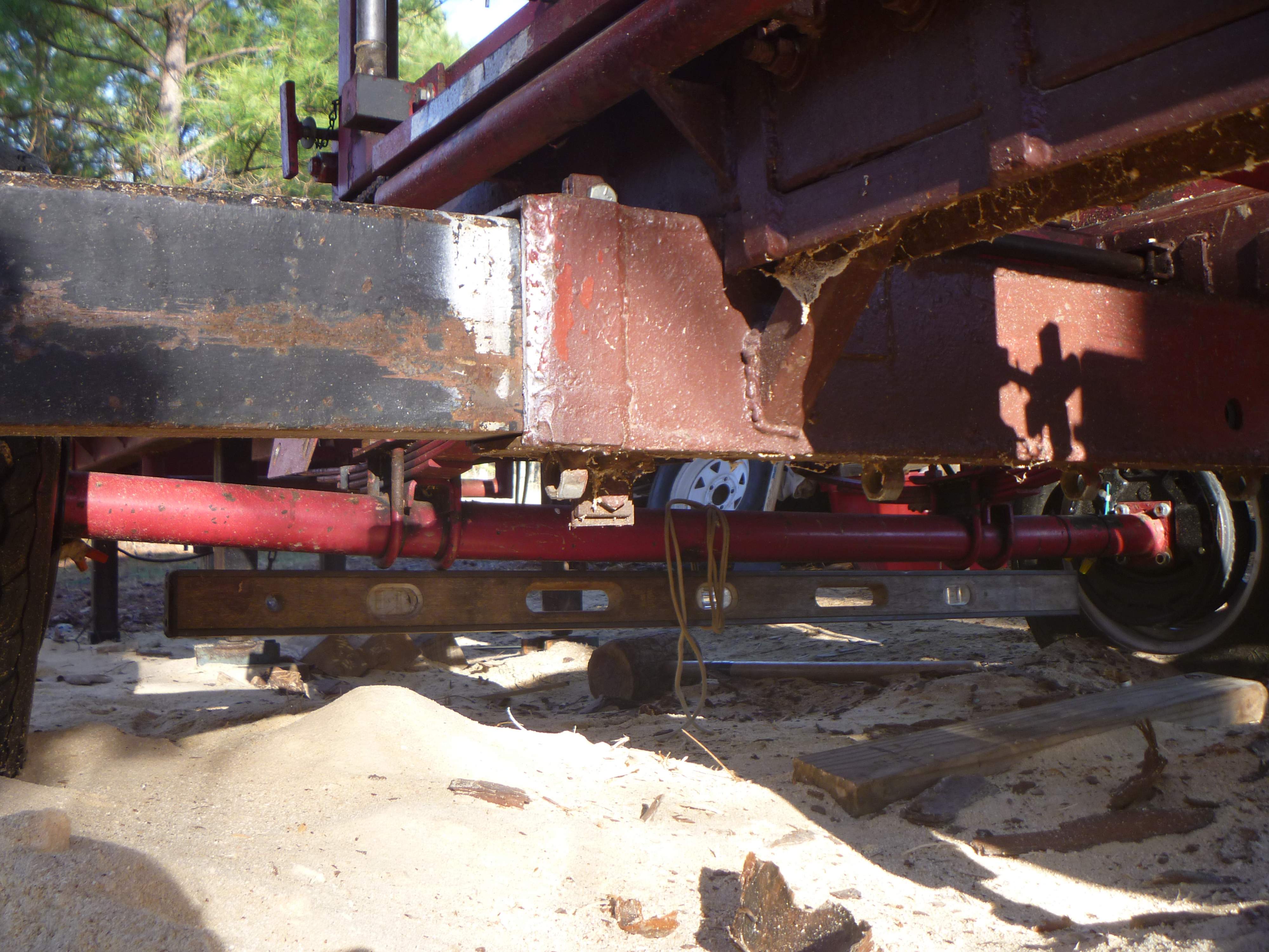

My portable sawmill has a 3500 lb axle (2.375 inch dia) with brakes and 13 tires. Trouble is, the axle is bent on one side (see pic) presumably due to bouncing over roads over the last 12 years. I need advice on replacing it. Obviously a heavier one is needed or the present one straightened and beefed up. I prefer to go with a heavier one but a 5200 lb one will have a different brake mounting flange requiring new brake assemblies and therefore new wheels and tires also a very expensive modification. I would like to get a 2.375 inch axle but with a thicker wall, say シ? and with the same brake mounting flange and spindles so I don稚 have to replace anything else. I can weld and could put it together myself but I need a source for parts. I immediately thought of the expertise of TBN members for advice. Any suggestions?

First question how often do you move it and from where/distance?
If short trips once or twice a year maybe not worry much and replace tires as needed with free junkers.
If half dozen time a year then maybe fix it by using heavy jack and chaining bent end down under a heavy beam & chain. might need a bit of heat but could reinforce axle with some angle iron after it is straightened. notch it for the leave spring U bolts and by tacking it to the axle it reinforces it all.
3rd buy a all new replacement for couple hundred bucks from REDNECK or one of many places for trailer parts.

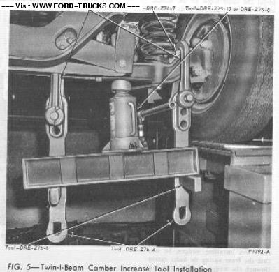

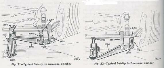

on my sons trailer we built an axel bender, and saved a lot of tires, over the years, (the trailer came from the factory with a bent axel they dropped in building it,
we had a old plow iron about 1"x3" inches and made a few loops of flat stock and the iron was filled with holes so we use a stubby 20 ton jack and have straighten a few axels,
pictures are of fords axel benders that is where we got the idea is from some old ford truck manuals,
on yours one could take it off and find a metal working shop and have it pressed back in a press,
then I would truss it a little,
a rod and a few blocks near the U bolts, or a piece of flat with the U bolts area notched out and just run it across the bottom of it a 3/8" by 2 1/2" flat welded under the axle.

Your sawmill probably weighs less then the rating of your current axle the problem is in the spring mounting points. They are supposed to be much closer to the hubs. BUT!!! It would prevent the proper access to the mill while sawing lumber and would be awful tippy to tow. I would go with a heavier axle or straighten and reinforce the current one.

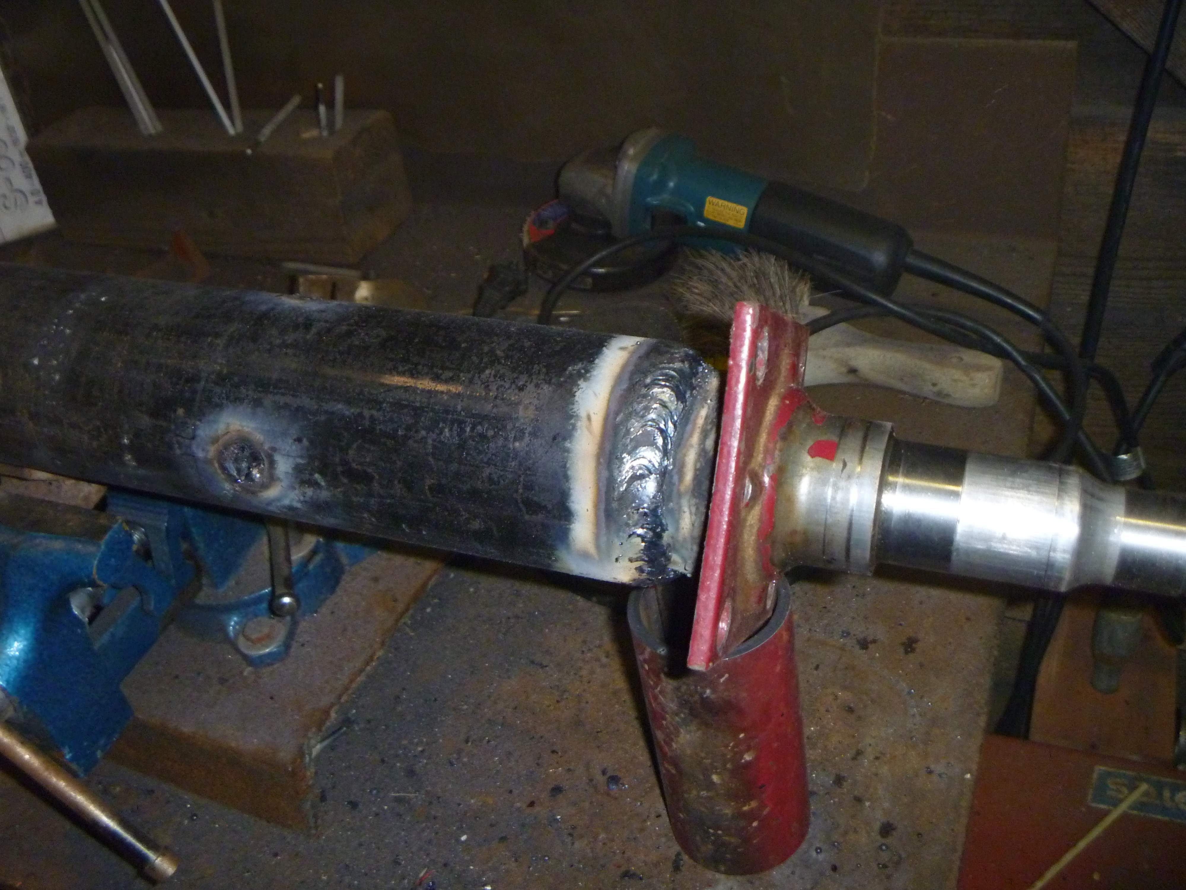

From all the suggestions I have received, I plan to do:
1. cut the axle about 8" from the brake mounting flange
2. slip/press a larger 16" tube/sleeve over the cut end leaving enough room for a torque wrench to fit over the brake plate nuts and weld
3. slip/press a pipe (~2" sched 80) in the other ends of the sleeve and weld.
The 3" sleeve will rest on the springs so I will change the u-bolts to acommodate them.
I need to locate the steel and the sleeve will need some machining. I'll post pics when the parts are ready to assemble.

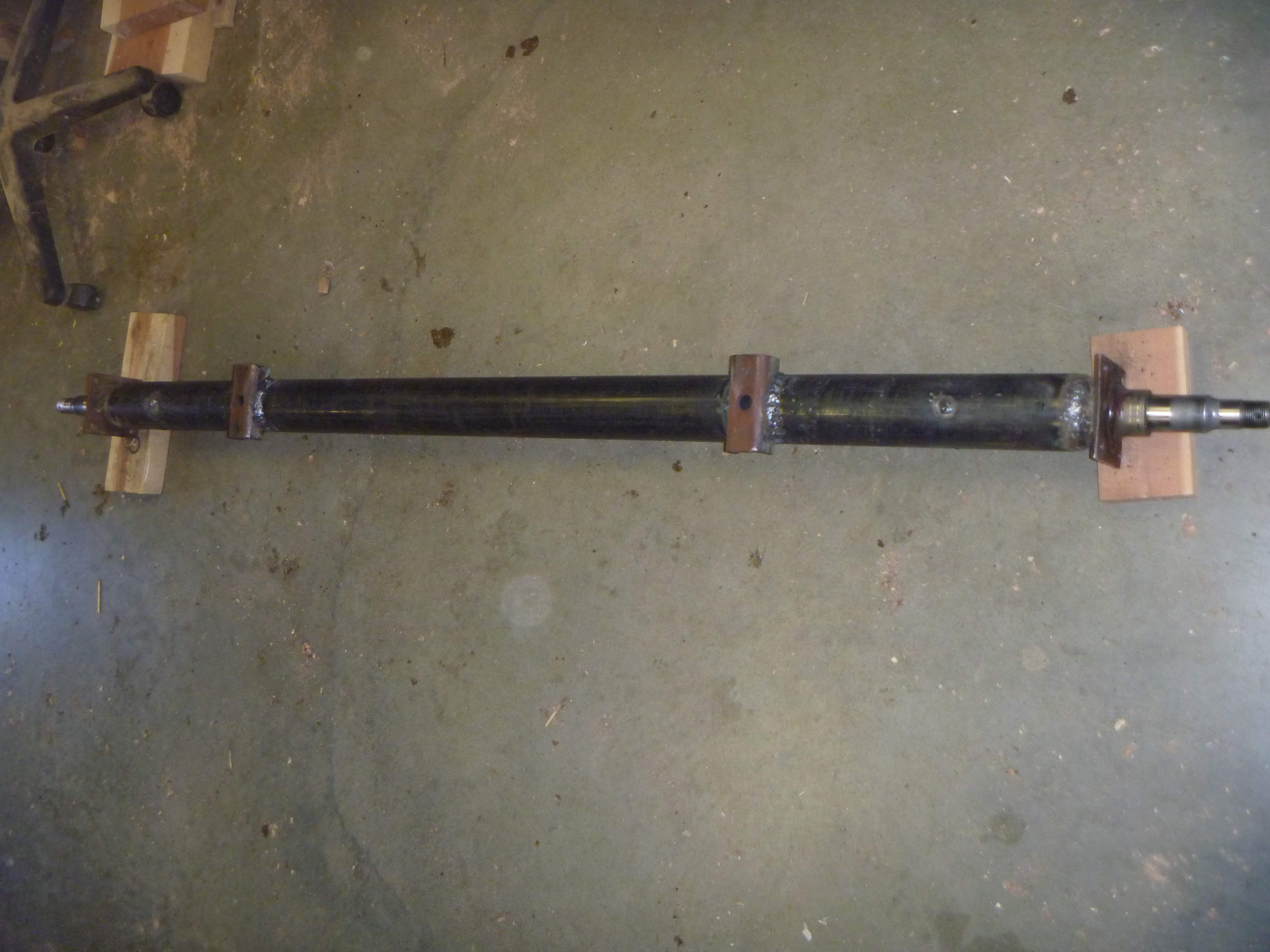

I pretty much followed my plan in post #11. Today I got the pipe back from the machine shop where they bored out the OD to receive the old axle (cut off to 6" long). I drilled suitably places holes for plug welding, inserted the axle/spindle assembly into the sch 80 pipe, plug welded and welded around the end of the pipe. Then I placed, leveled and welded the spring seats. Electrodes were E6011 and 7018 both 5/32". Went pretty fast. See pics.
I made pretty careful measurements to assure my torque wrench would still fit over the brake mounting flange nut with the larger diameter pipe.
Tomorrow I fish the brake wires thru the axle, put the brakes and drums on and hang the axle under the sawmill and mount the wheels. :cool2:

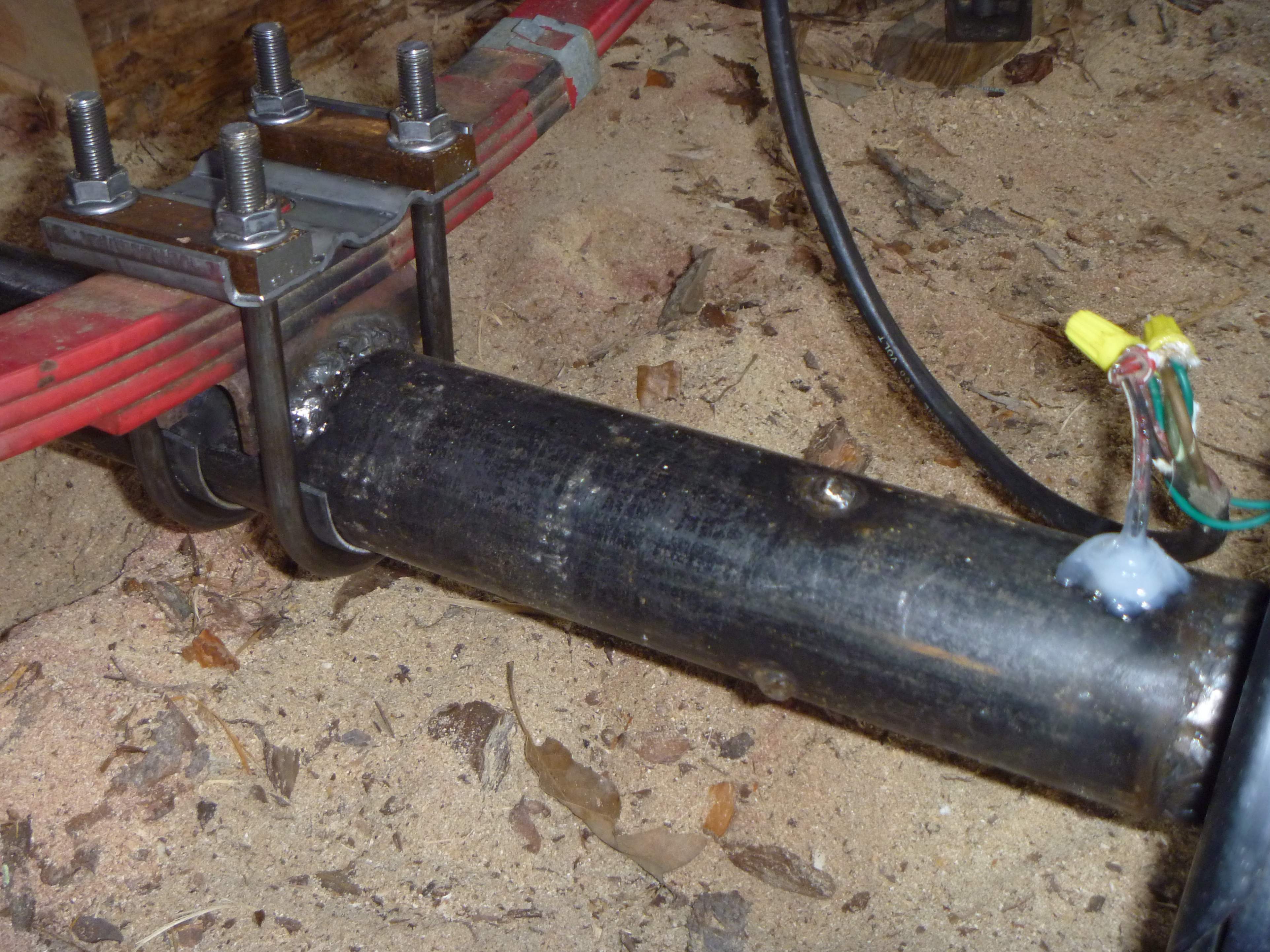

Yes. I bought new Ubolts. New axle is on the mill now. Pics to follow when I get the brakes connected.

I was just wondering if they were available for the new tube size, but apparently you knew they were before setting the saw in the axle :)

The axle is installed. The Ubolts are for a 3" axle and the sch 80 pipe I used is 2.9" so I inserted a u shaped shim around the Ubolt to take up the gap. Don't know if that was necessary but it was easy to do. Also the threads on the Ubolt were not long enough so I added a 1/2" bar on top of the plate. See pic. Its torqued down to ~60 ft-lbs and ready for wheels to go back on. All-in-all it was a pretty straightforward project.
