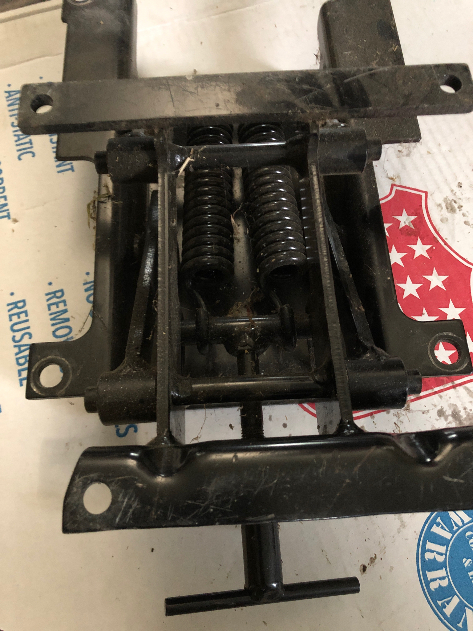

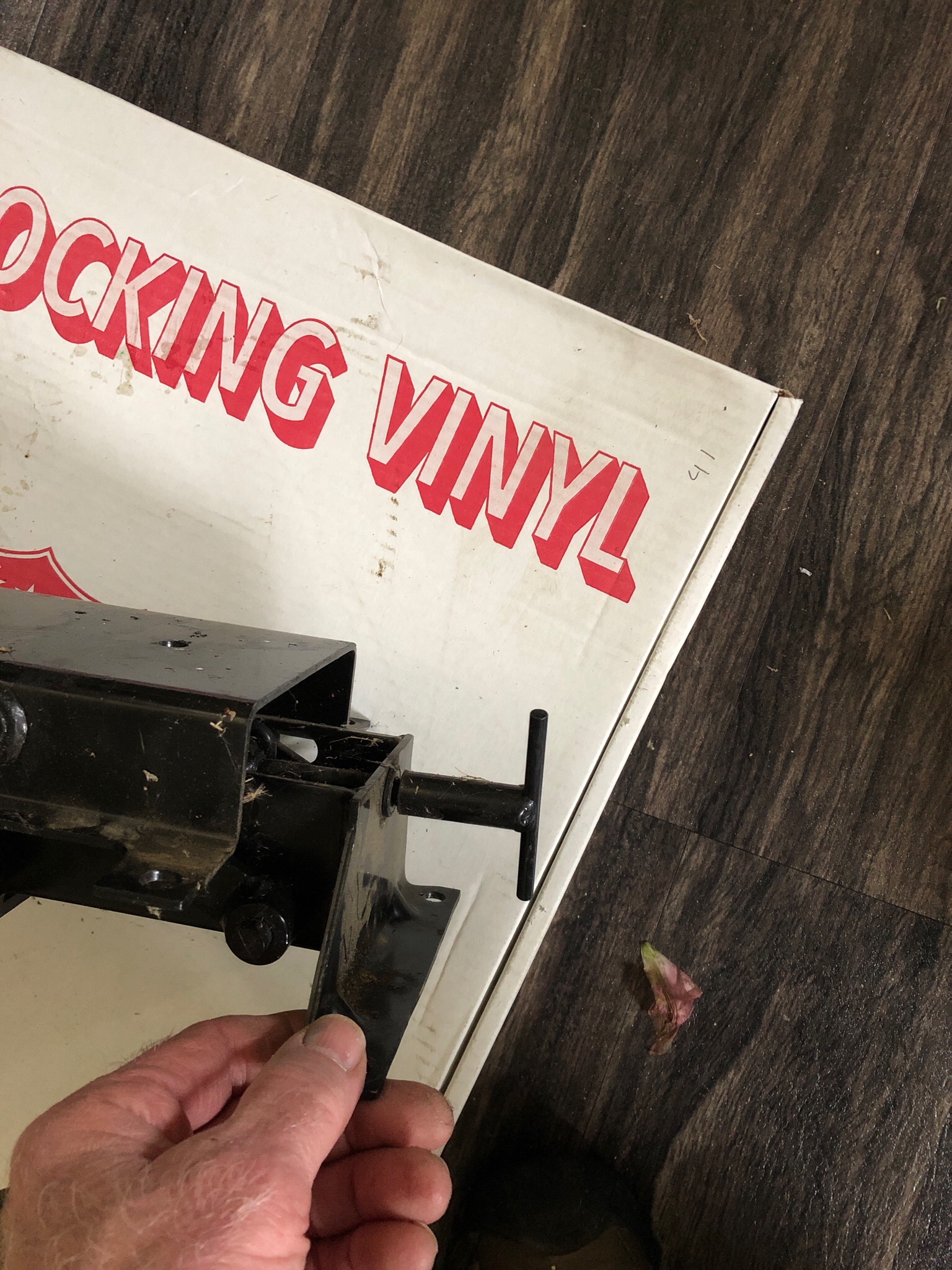

You have a weight adjustment on that seat.
With a backhoe on the 2650, the regular seat is replaced with a swivel base on the seat.
That is the reason I asked about a bh.
Murph I don't see any "weight adjustment on that seat". All I see is the standard front to back leg length adjustment. Please clarify?
Picture maybe.
Thanks
   / B-2650 Seat #12

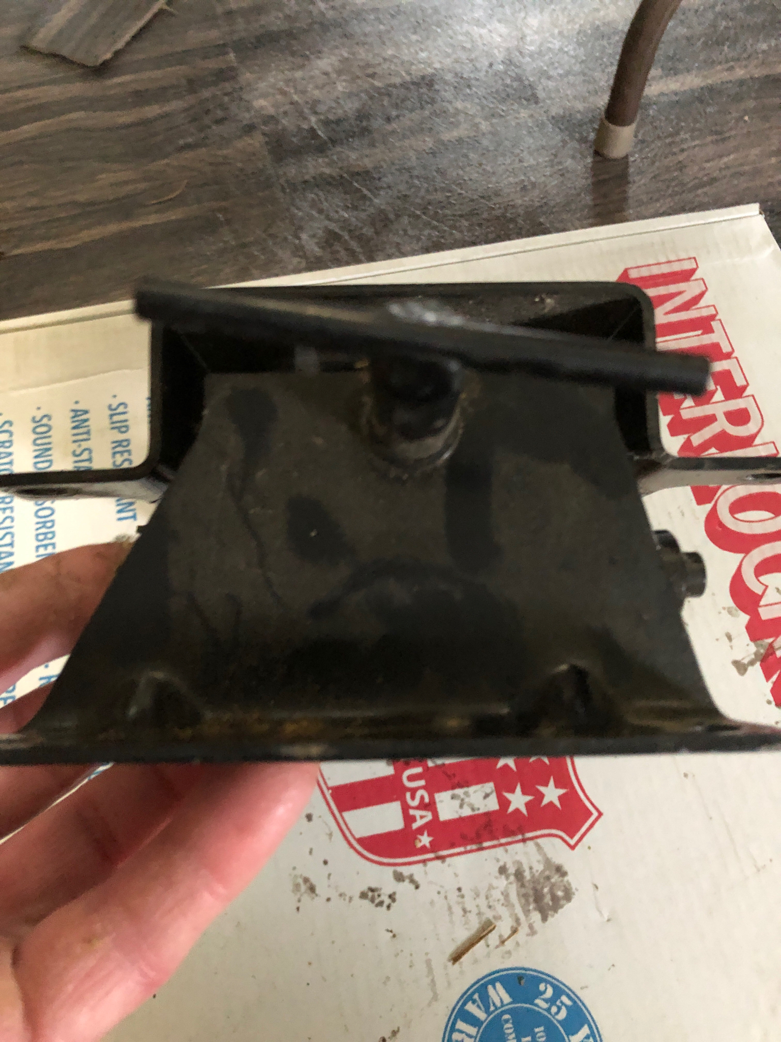

On the standard seat, on the rear, there is a T handle that screws the dual horizontal suspension springs tighter or looser.
   / B-2650 Seat #13
Here is the T-handle
This is the seat base on the B2650.
You can see the springs in the last photo.
   / B-2650 Seat
#14
Well slap me silly. There it is!. I guess it came with no tension on those springs. I gave the T-Handle 3 turns tighter.
This TBN site is the best...........Thanks Guys.
Mike
   / B-2650 Seat #16
   / B-2650 Seat #18
I know this much, spending 4 hours in my father in laws rutted up pasture makes you really appreciate riding in that spring instead of rebounding off of the coils from the backhoe seat. I don't I'll lever install the backhoe seat base again. I despise that worthless junk.20190524_162133.jpg20180827_163647.jpg20190519_093725.jpg20190519_100803.jpg
