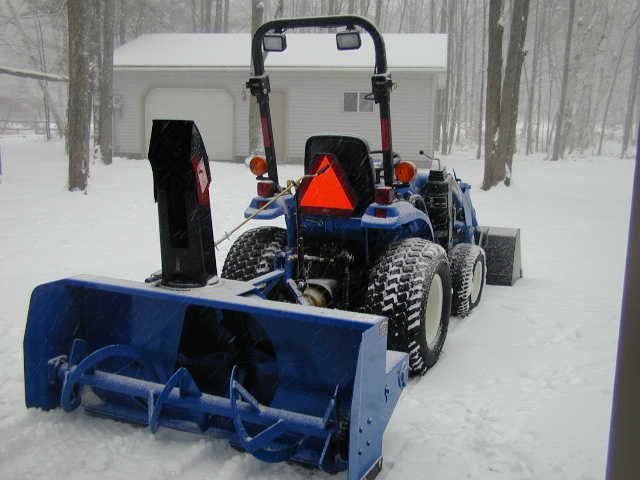

We used to go up to Munising in the in the summer, to compete in a High Power match they held at a gun range just out of town. Beautiful up there. Ray, if you like to snowmobile your in luck! Wev'e had plenty of beers & burgs at the Dog Patch over the years. I have a 64" rear blower on a TC24DA, I have only used it once in about 6" of snow so I don't have much in the way of feed back to give. Will know more when there is a couple two or three feet on the ground.
Pete
