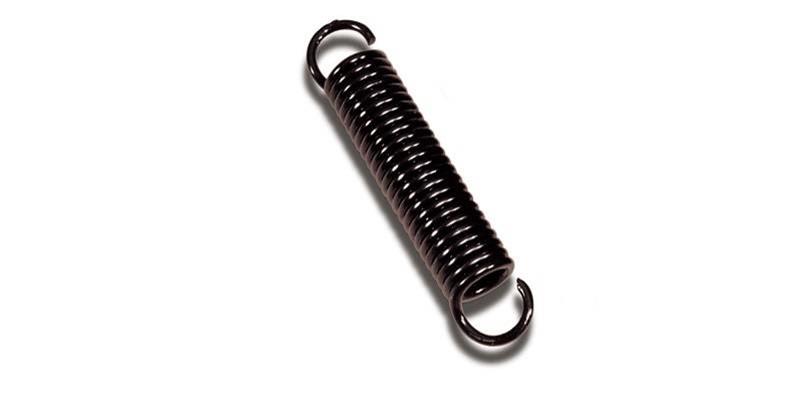

Maybe you folks can help with this plows spring dilemma. (like after the winter? :eek:) The original Moose ones had been stretched so I had to add spacers to get them tight enough for the plow testing... I was thinking that I'd add slightly stronger ones than the originals. These are 10" long, have a 1.5" coil which could be slightly larger and made from .220 spring coil. Is there another spring out there that close to that, made with .250 coil???
