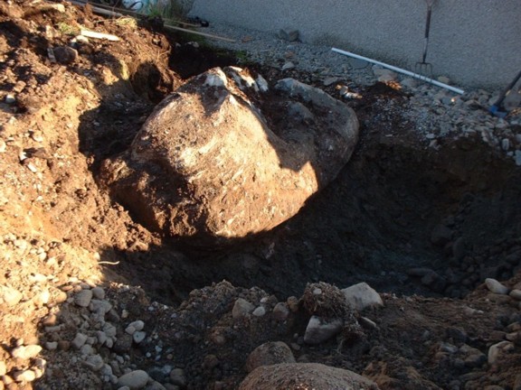

There we are. One big hole at the side of the rock which seems to just get bigger.

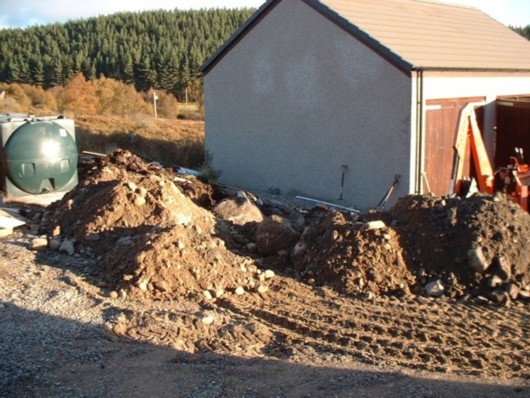

Well after lots of digging and then trying my theory of pulling into the hole I admitted defeat. I measured the rock and it is 6 foot long 5 foot high and 4 foot wide. Oh yes it is granite by the way. Well I think I will have to call in reinforcements when the weather gets better.
Well that's me up-to-date on my adventures in the tractor seat. I will keep you posted when I arrange for someone with a rock breaker attachment on a large machine to come and get rid of the rock.

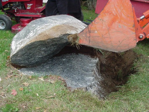

Try some "feathers and wedges"! /forums/images/graemlins/smile.gif

I'm glad you enjoyed the pictures. A colleague at work offered me a stick of explosive to dispose of the rock. He was being serious at the time! I declined politely /forums/images/graemlins/wink.gif. The next suggestion was "feathers and wedges" which DaveNH mentioned in his post. I didn't take my colleagues suggestion seriously after his first one! /forums/images/graemlins/crazy.gif What are they and how do they work? Is it possible to hire them? I must admit that I would like to get rid of this rock myself as I don't like being defeated.
   / B2150 working #30
I think they are refering to the old time method of drilling holes in a rock and then placing the feathers in the holes and then tapping the wedges down. The rock should split along the line of holes. I've never done it but have seen lots of rock that was split that way. It entails considerable work and skill with a single jack.
