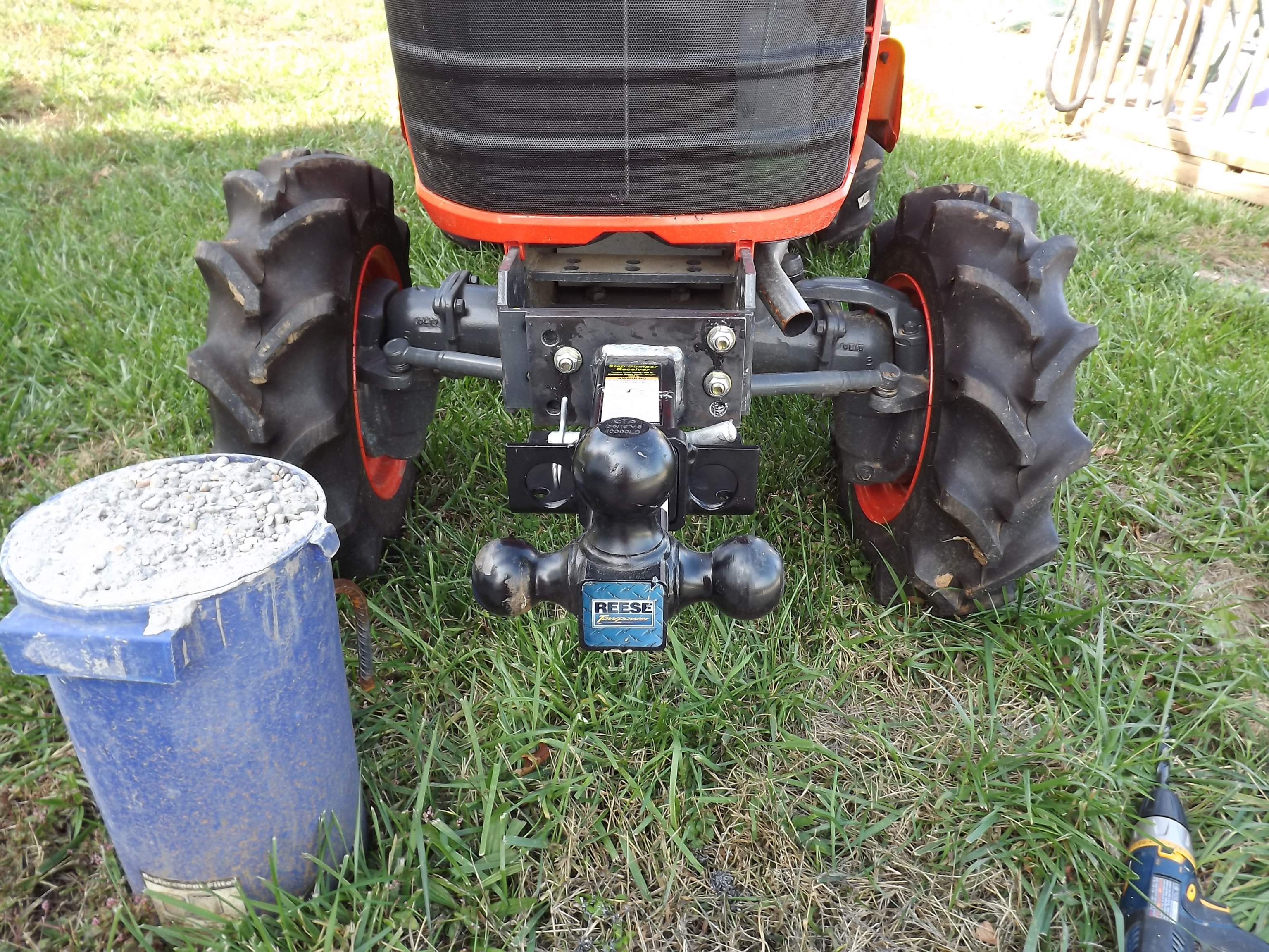

You may not need loaded tires but if it were me I would add weight to the front .
/ B2320 Advice #4
Had a B2320 with no FEL and had to add weights to front end for tiller and rotary mower. It was a gear (my first and last gear drive tractor) and would do wheelies.
/ B2320 Advice #5
I'd say with that 50 gallon sprayer (loaded) on the 3 pt you should have some weights on the front end, and would probably help control that rotary mower as well as immobilize the chipper/shredder when parked.
I've never loaded the R4 tires on my B2620 and it works fine with BB, Tiller and other tillage attachments.

I have a B2620, and I put 135lbs of weight on the front when I use my finish mower. Makes a big difference-without the weights I can wheelie going up small slopes!

Sounds like the R4's would be best for you, since you'll be in the rough quite a bit. I'm not familiar with the front weight specs from Kubota, but I'd guess that about 100-150 lbs would be plenty. Your dealer might help on that item, or another TBN'er.

You will definitely want the front weights. I would add as much as the factory bracket would allow. I used to have a B7410 with weights on the front and they were a must in my opinion. Seems like on mine there were four weights totaling about 160lbs.
/ B2320 Advice #14
I second that. I have 5 at 50lbs on my BX they work good for something like my rear blade. When I lift something 700lbs+ the front gets light.
