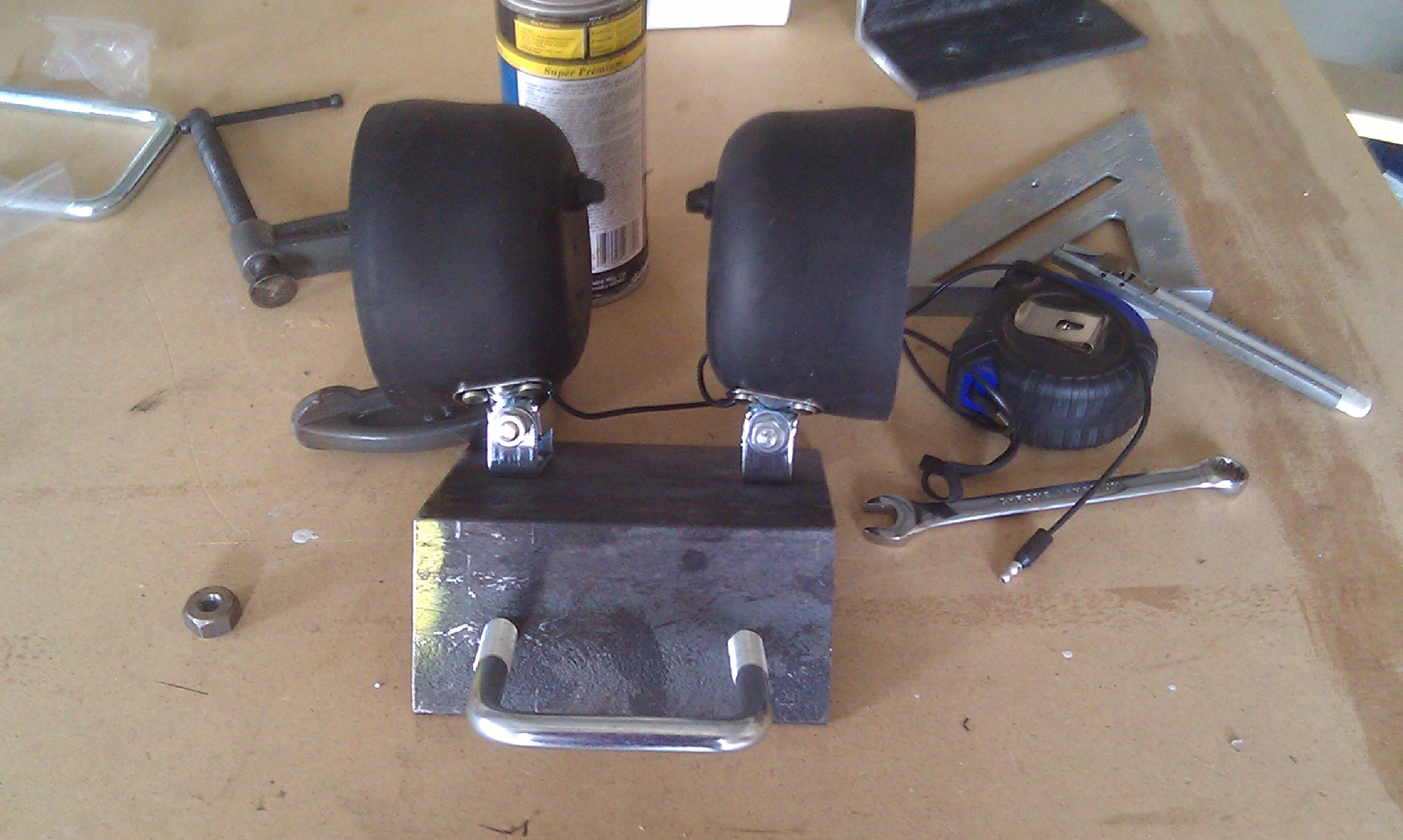

   / B2320 work light harness location? #22
just in case you don't want to run a switch you can try some of these lights, At $20 bucks apiece. the switch is in the light. I was going to my M-F dealer and they wanted $93.00 each. you can get these at your local napa store
