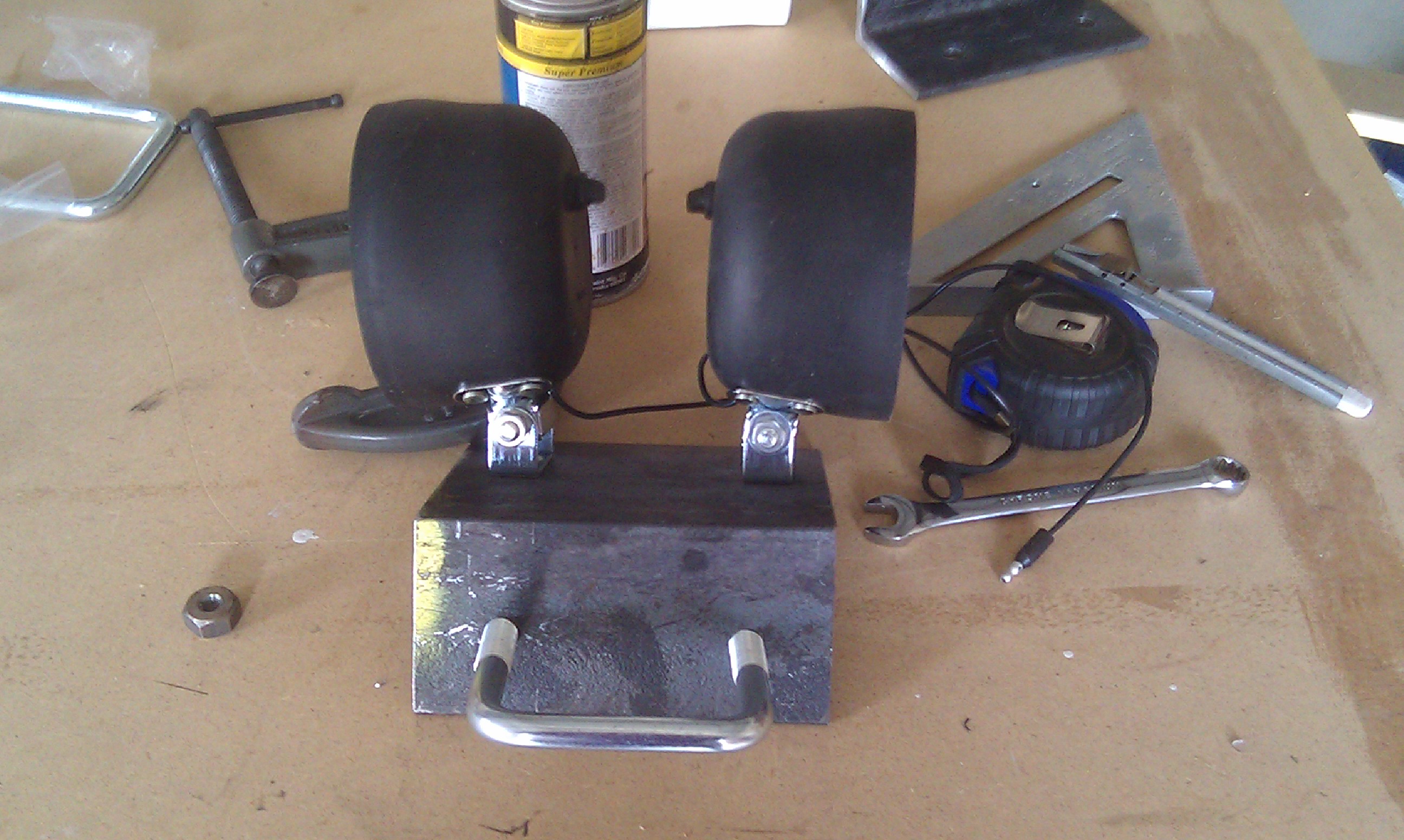

Found it, blue tape and all. Bad news is the BXpanded lights won't work as is. Wiring harness is too short. I'm going to use the light heads and the brackets and rewire it all.

From the lights down to the switch and to the bullet connectors. It probably would have worked if I wanted to put the switch box on the rops and run the wires straight down to the power connection. The rops sits back a bit further than on the BX and I wanted to move the switch forward, if that makes sense.
The lights sure worked great on the BX and took me all of 15 minutes to install. Truly plug-n-play.
My plan is to run the wiring through the ROPS and mount the switch on the blank panel on the right fender. It should work well and I'll still be able to easily change the lights from front to rear facing as needed.
