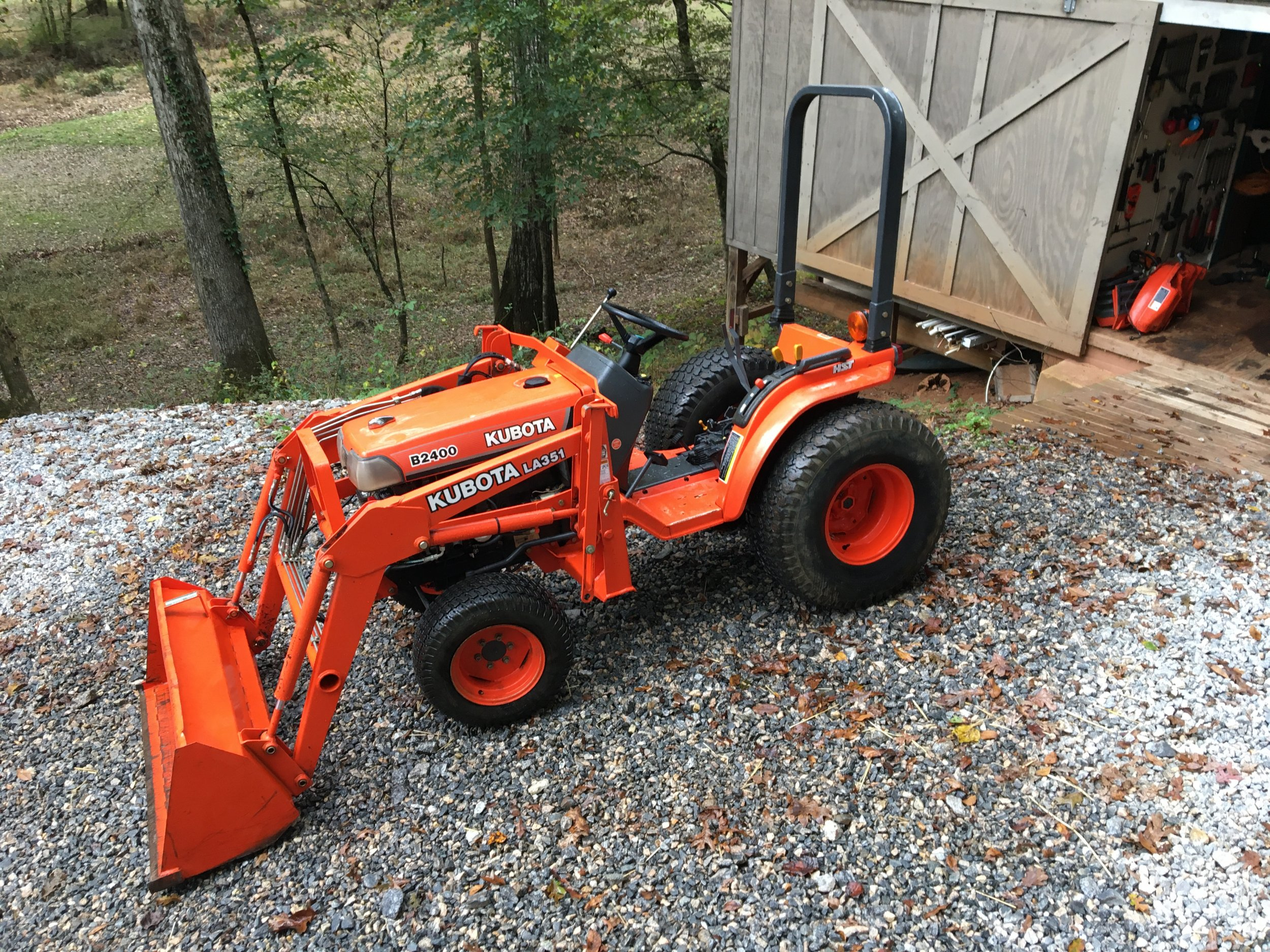

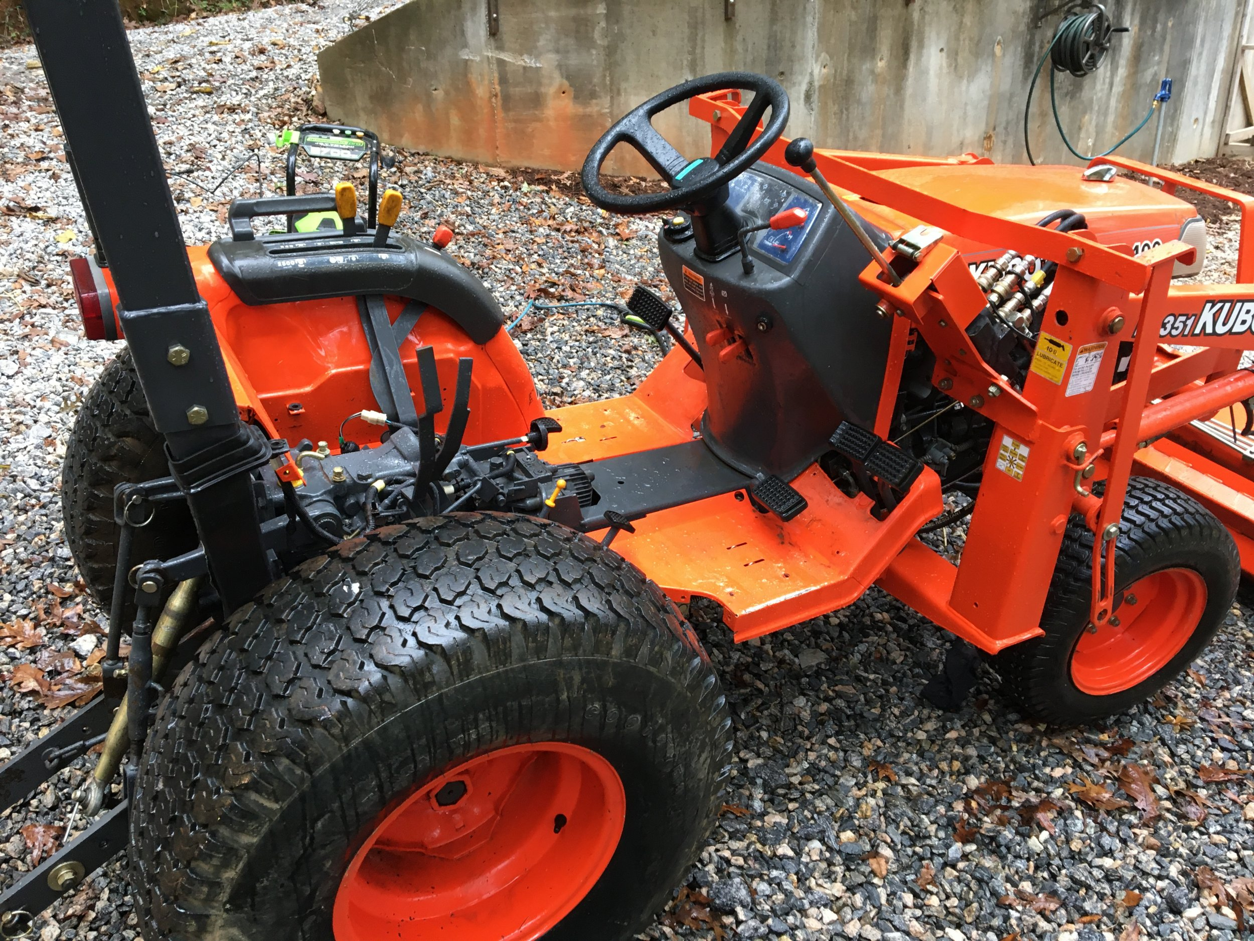

Great post. The direction of the washers was exactly what needed changing!
thanks!
Repair done!
did a quick pressure wash of the tractor to knock of all the sludge and now just have to get the seat and fender back on.
Now that I have the leak issues fixed I’ll do the 200 hour maintenance later this week.
thanks again for all the help!

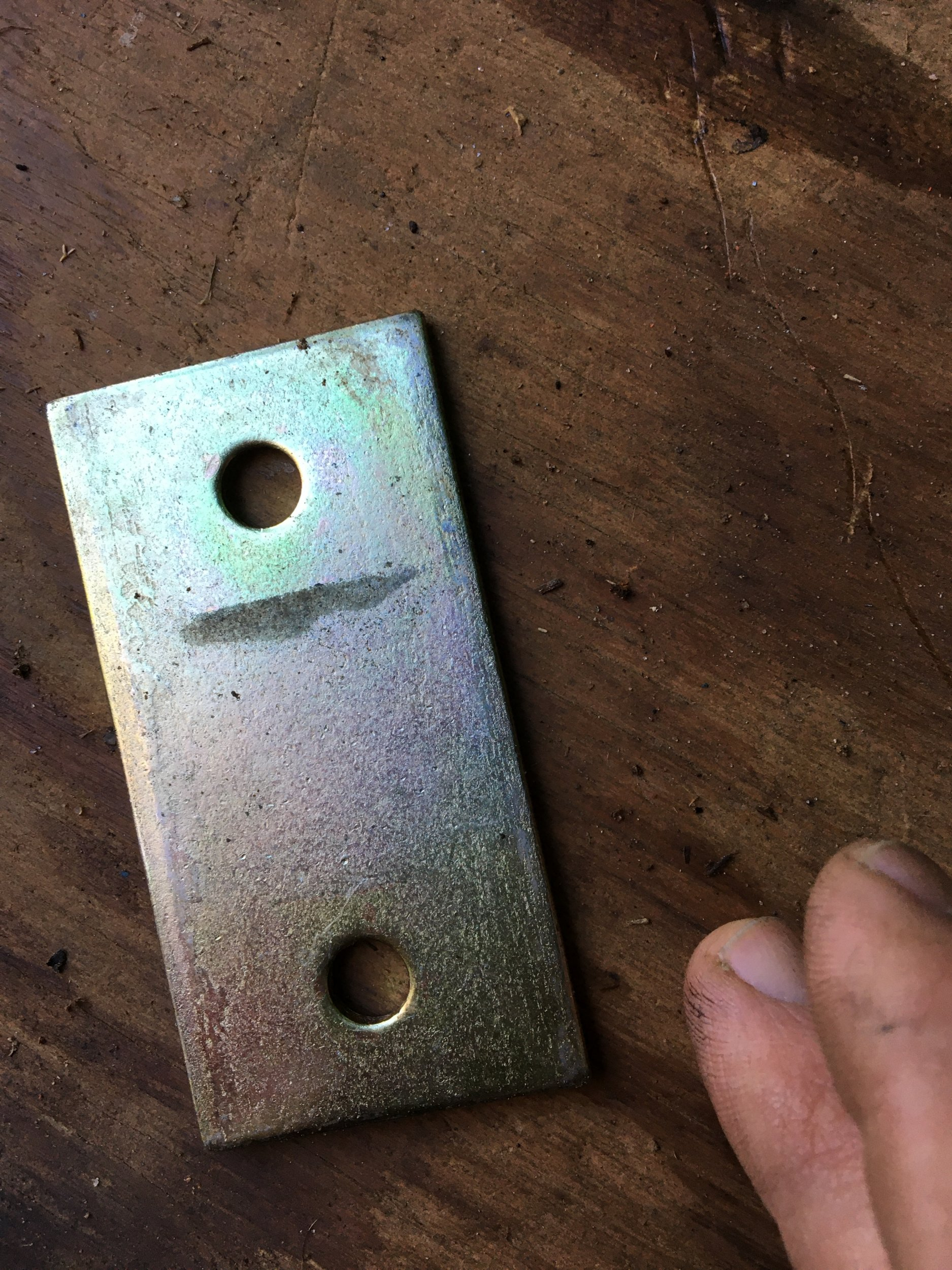

Well—I may have celebrated a tad prematurely. Was putting on the fender and seat today and then found this one little piece underneath where I stored the seat.
I’m going back through my photos but can’t locate it yet.
anyone know where this plate goes?

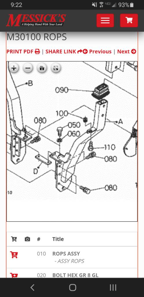

It looks too small but could it be this peice that goes between the rops mounts?
