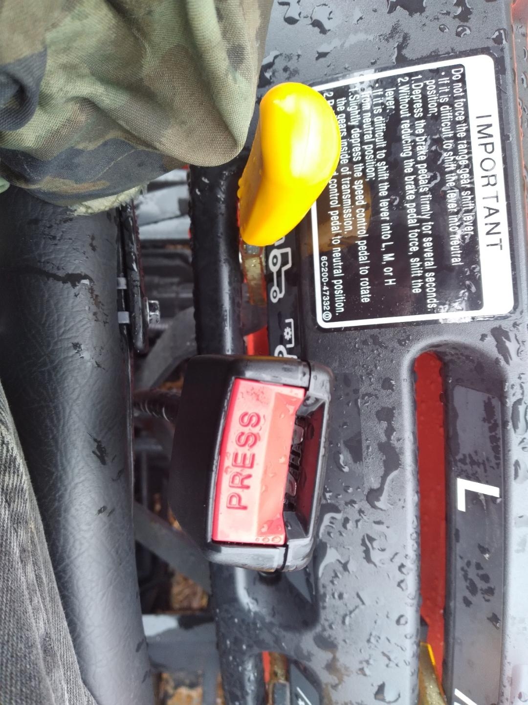

   / B2601 backhow bleeds down
I figured it was normal just wanted to check, Thanks!
After this....I was curious about the dealer prep, this is a 100% good rated dealer...just no-one bothered to put the set belt on. :p
