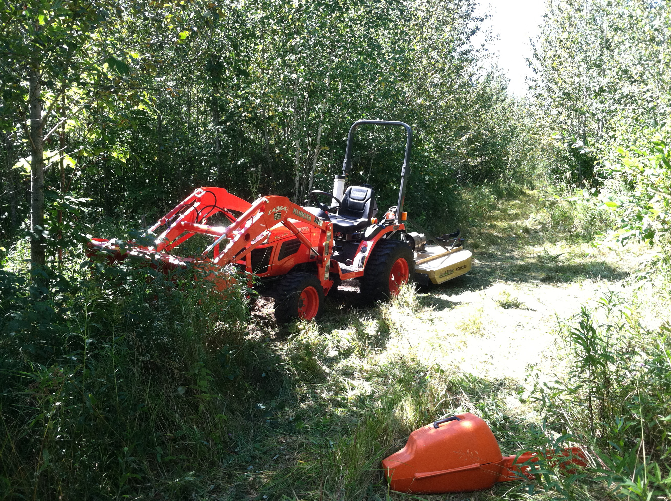

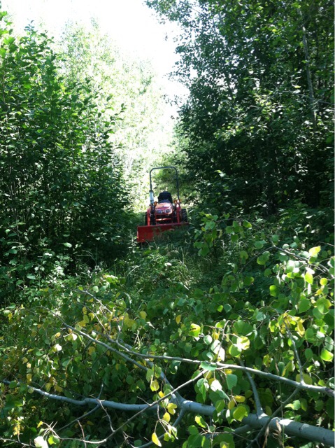

I use a B2320 with FEL, 4’ rotary cutter & back blade to do most of what you’re talking about (no grapple). After long consideration I left the R4s unloaded because it’s mostly in the woods a long way from my truck & trailer and I didn’t want to mess with a punctured loaded tire. After 5-6 years I’m very happy with it. It will scramble most places that I took my ATV into as long as it’s not too wet. It’s a great woods machine.
I’ve filled my loader plenty of times with just the back blade hanging out there and no instability if you just use common sense. I can’t imagine going over stuff much more than tall grass & weeds with a MMM. I’d get a B or similar and a cheap mower for the true grass. IMG_0599.JPGIMG_0629.JPG
